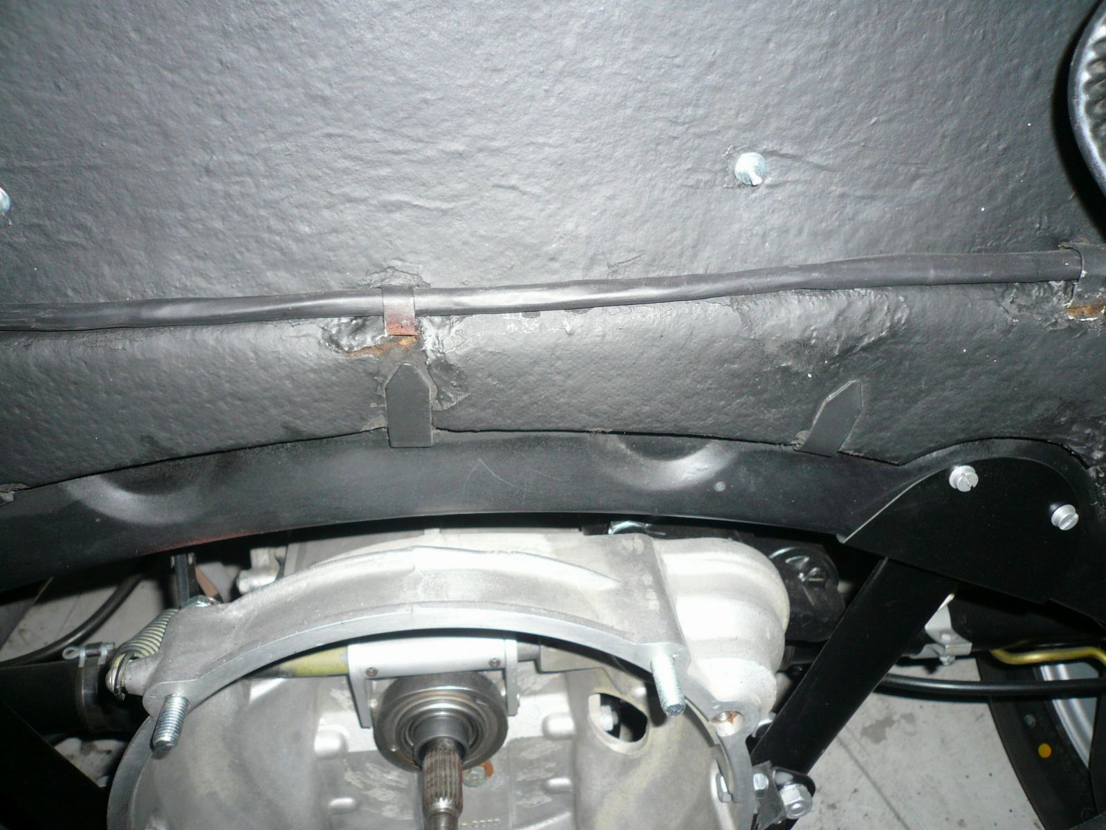

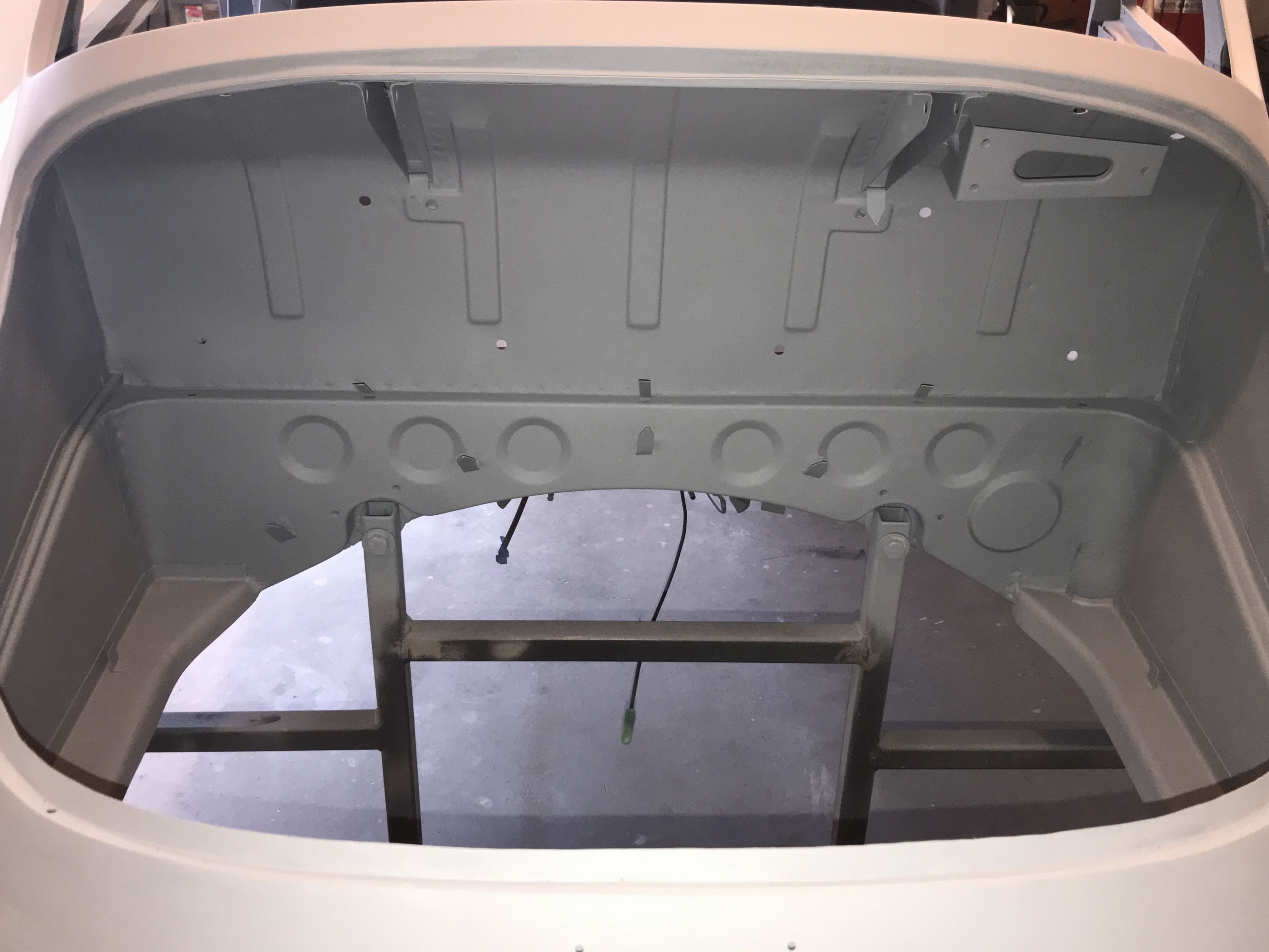

    on my car there are only two on each side because the rear lower part from the engine bay is new ... but without the straps. That was my intention to start this topic. I don't know where and how much of this straps are mounted ( see post #1)
    What I have is this
    Click image for larger version  Name:	image_59930.jpg Views:	3 Size:	56.2 KB ID:	104254
    The straps are 15 mm wide and the leggs each 20 mm
    What we still miss now are the straps (position and how much) on the rear side.

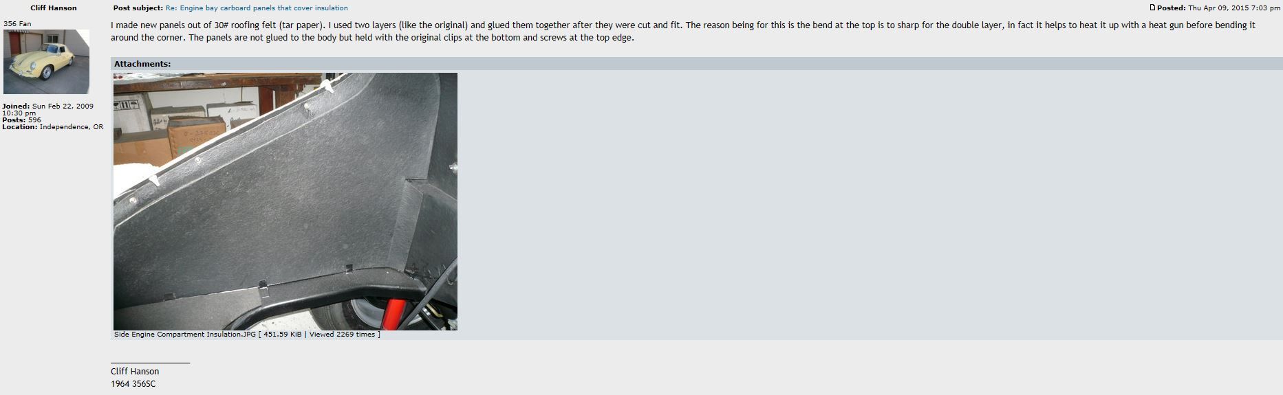

    I found this on the porsche356registry.
    Maybe anybody know Cliff or is registered bei porsche 356 registry and can send a PM

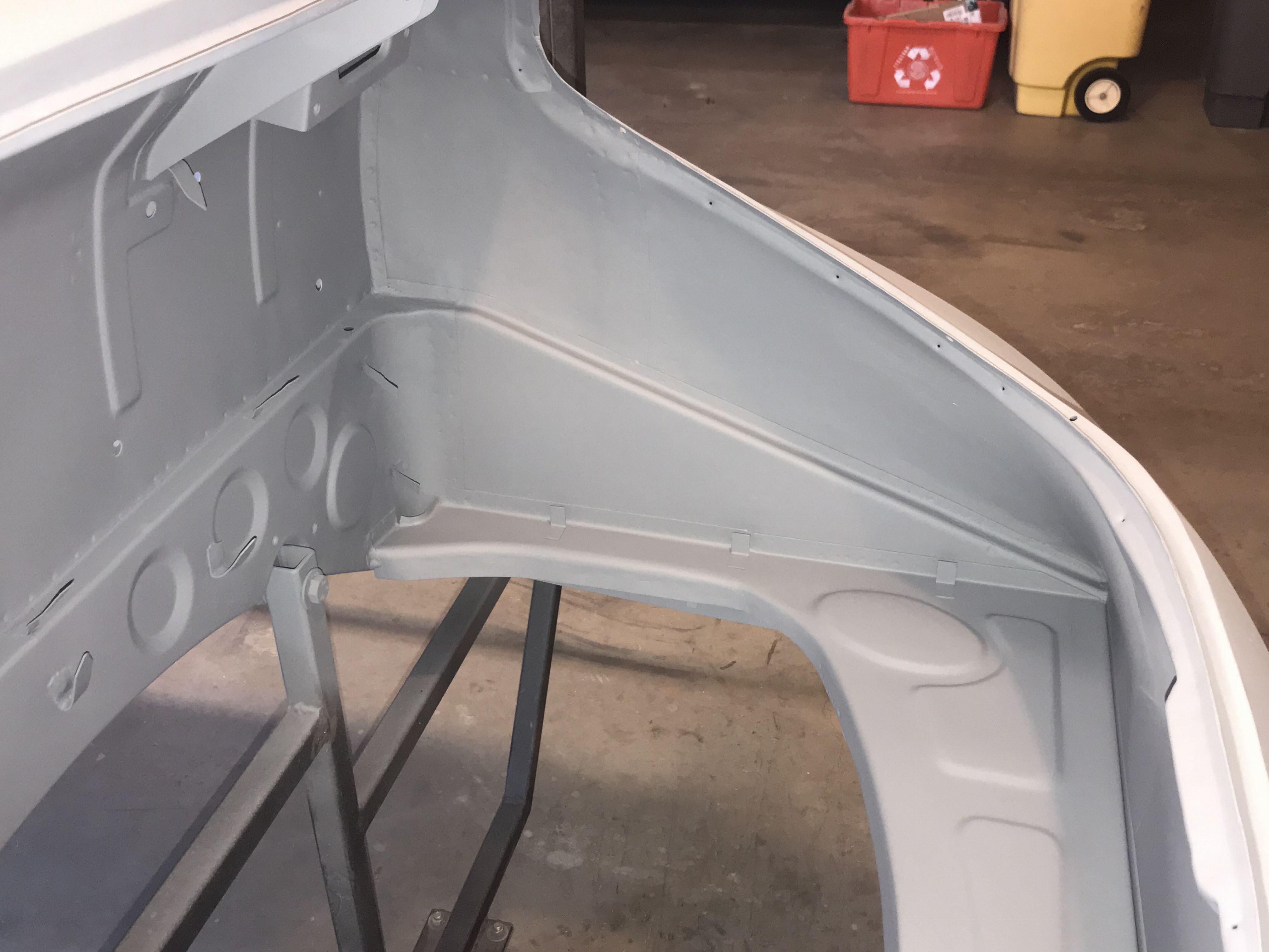

        I researched the Registry Forum and found some great photos and information. The outcome is that there are 3 tabs along each side base 15 mm wide and each leg of the 90 bend is 20 mm long. These are specific to Karmann cars. Bruno: about how far from the side wall is the upright tab?
        [email protected]
          Click image for larger version  Name:	 Views:	2 Size:	252.1 KB ID:	104278 Click image for larger version  Name:	 Views:	2 Size:	303.2 KB ID:	104279 Click image for larger version  Name:	 Views:	2 Size:	322.5 KB ID:	104280 Click image for larger version  Name:	 Views:	2 Size:	219.8 KB ID:	104281 Click image for larger version  Name:	 Views:	2 Size:	214.7 KB ID:	104277
          [email protected]

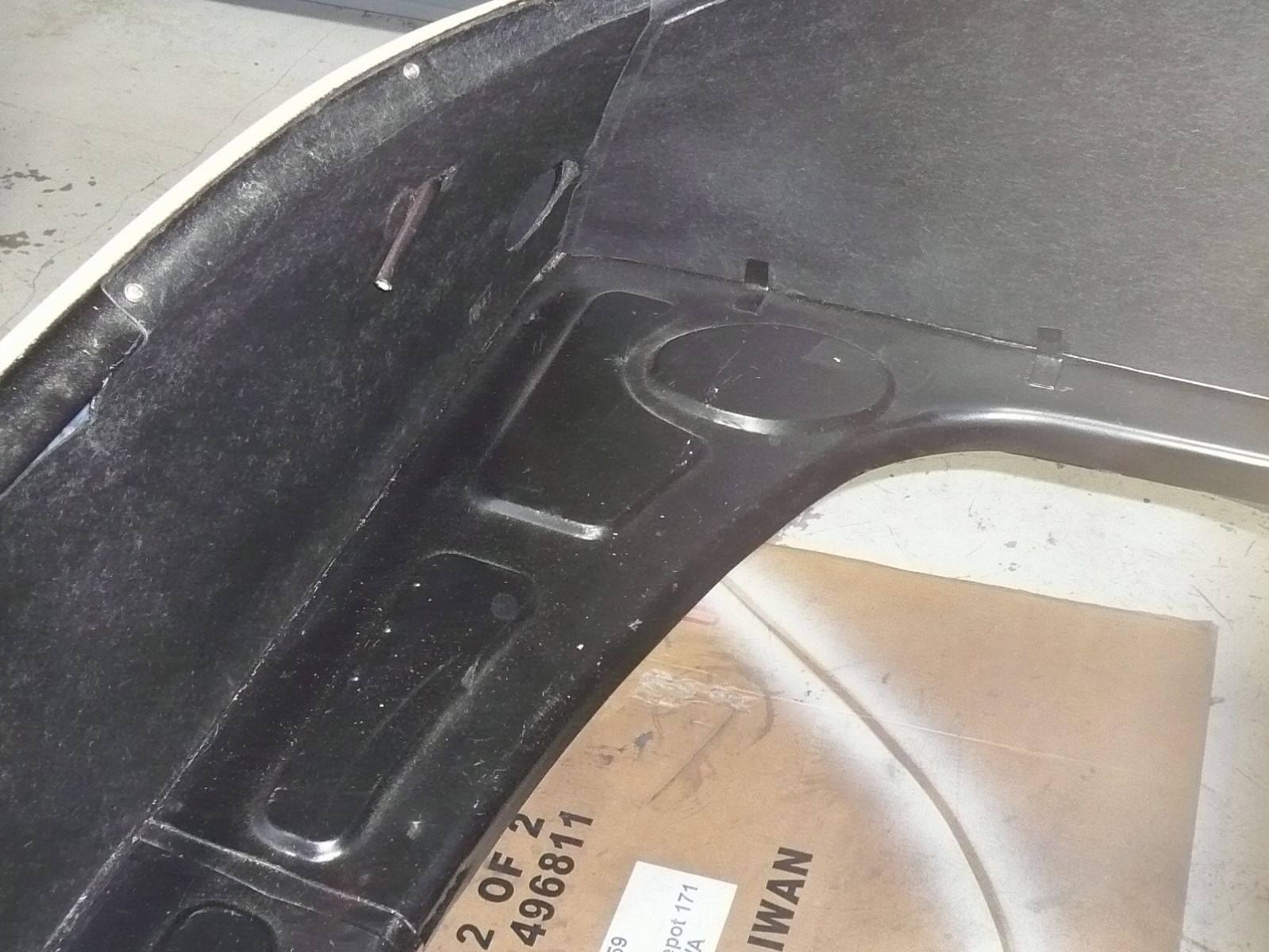

            Here's a few old photos of my 64 karmann coupe. Not sure if they are clear enough? My car is far away from home so this is the best I have at the moment. Those tabs are present on the side I don't remember the strip Bruno is referring to.
              Thanks for posting Tom. I spoke with Mike Wilson yesterday who also has a Karmann and his car only has 2 tabs along each side, while the pictures of Cliff Hanson's car have 3 tabs along each side. I would think that the insulation would be held in place better with 3 tabs.

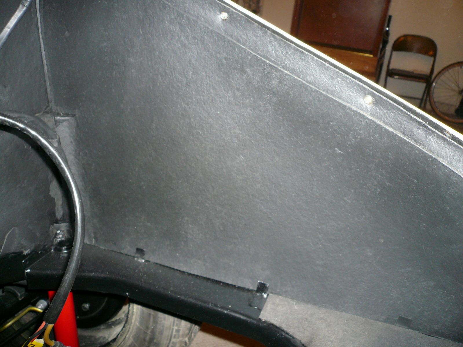

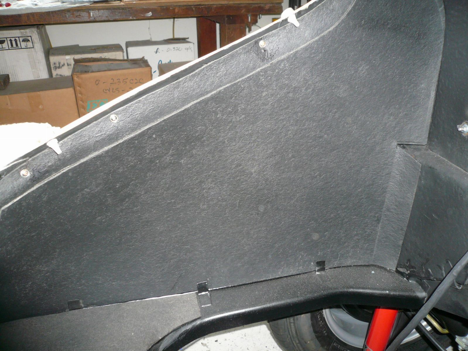

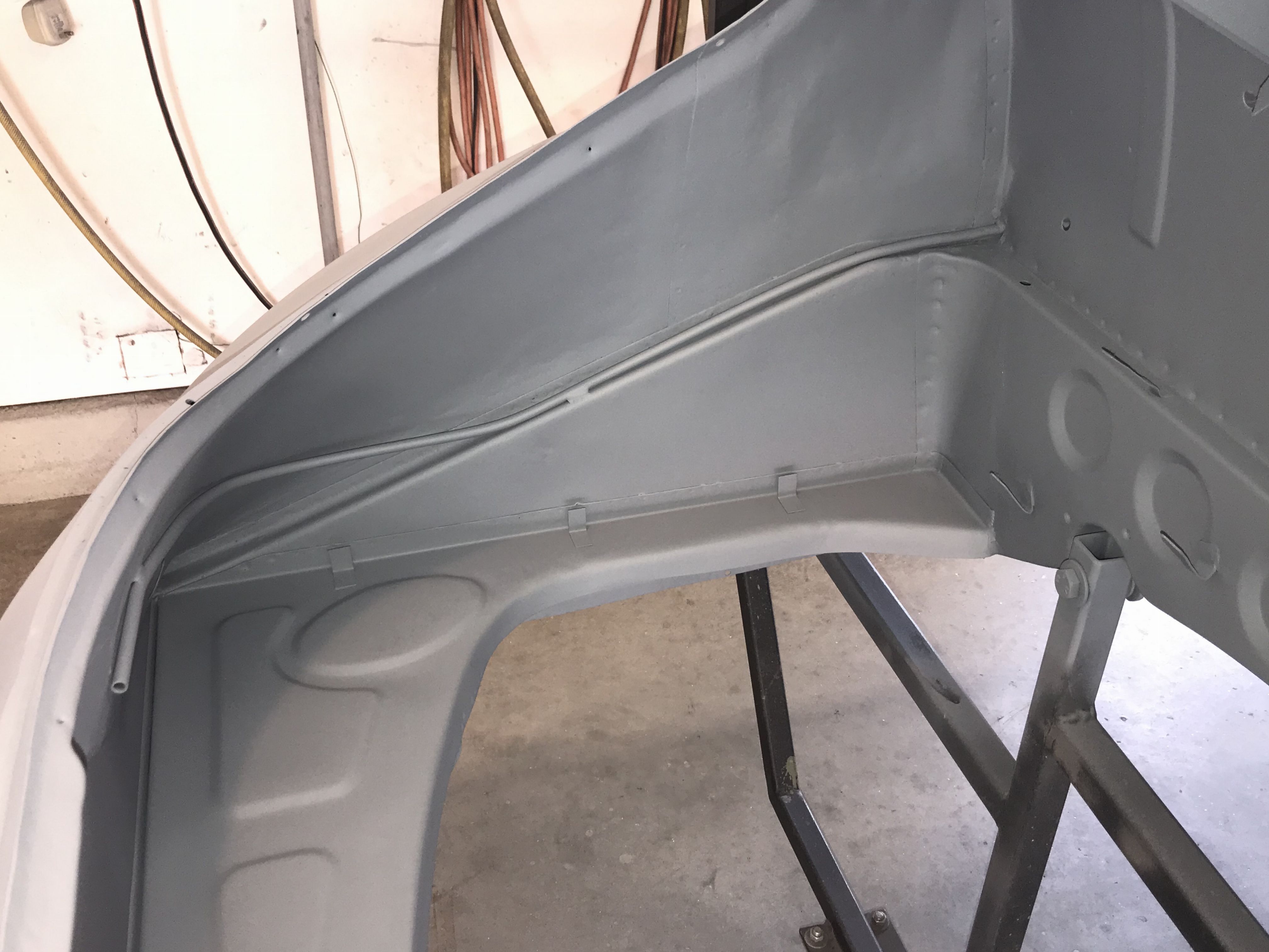

                  Newly installed Karmann engine tray insulation clips. Now to make the insulation!
                  JP
                  Click image for larger version  Name:	 Views:	1 Size:	812.2 KB ID:	104681 Click image for larger version  Name:	 Views:	1 Size:	784.1 KB ID:	104682 Click image for larger version  Name:	 Views:	1 Size:	777.7 KB ID:	104683
                  [email protected]
                    Engine compartment looks fantastic John! A shame to cover all your handy work with sound deadener.
                  Cool. Thank you for the pictures. Now I have a template What kind of sound deadener will there be?
                  Bruno

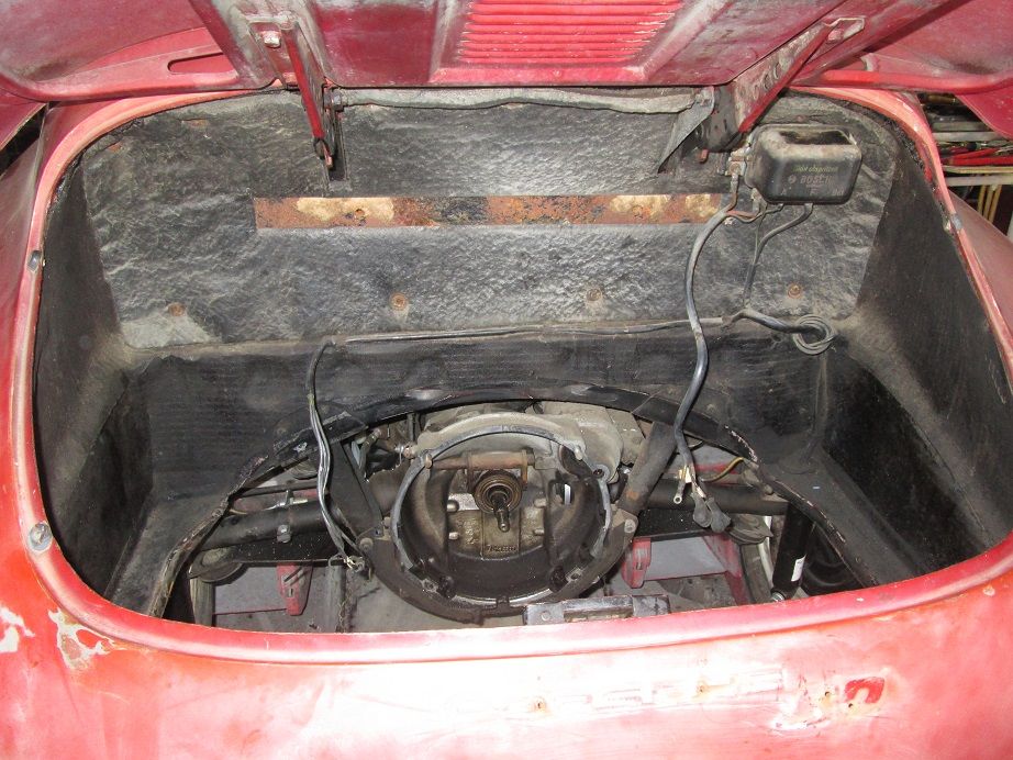

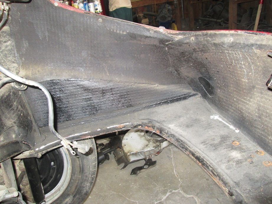

                        James Nelsons original T6 engine compartment showing no tabs. A karmann versus Reutter detail?? Click image for larger version  Name:	image_60235.jpg Views:	1 Size:	119.1 KB ID:	104832
                        Photo courtesy of James Nelson
                        • #28
                          Hi Justin,
                          That engine bay is a Reutter: there are no insulation tabs and the insulation is a tar paper with a waffled appearance. The Karmann engine bay has insulation tabs and the insulation is a hardboard with jute against the metal with a flat non-waffled appearance.
                          [email protected]
                            Makes perfect sense John. Thanks!

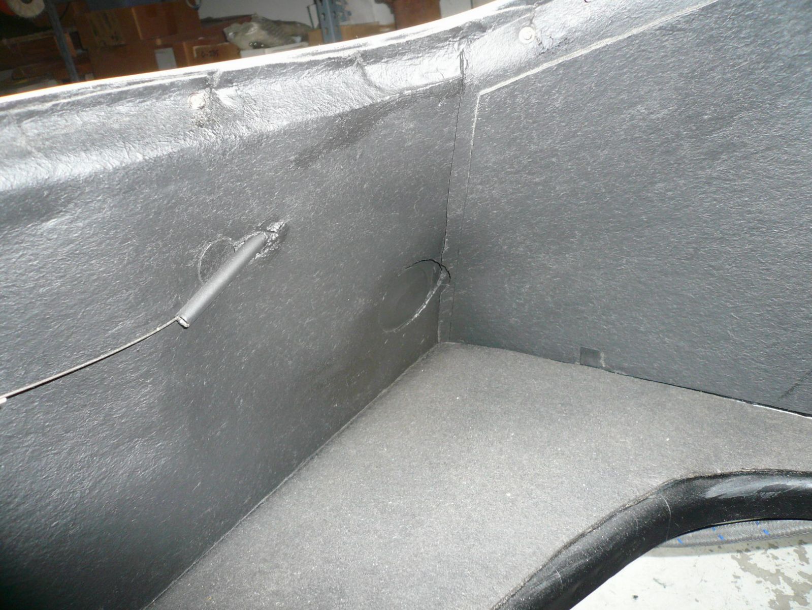

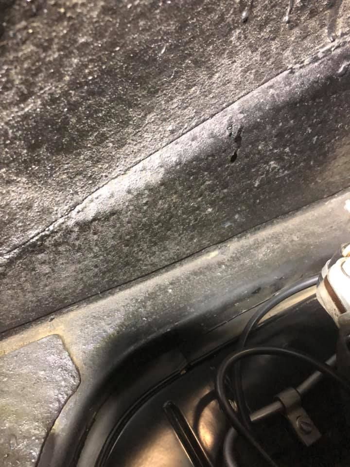

                          Here are a couple of engine compartment shots I took of an all original T6 S90. Might be of some reference use.
ID:	105769 Click image for larger version
