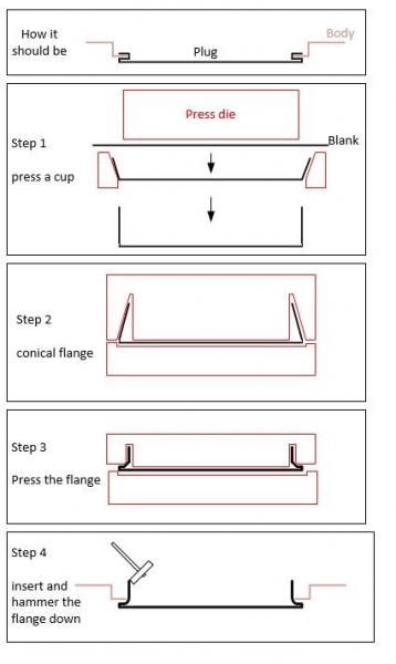

    Idea:
    Click image for larger version  Name:	 Views:	2 Size:	26.8 KB ID:	103713
    1. Blank and first lower die to press the cup
    2. Upper die to press the cone
    3. press the flange (Upper die missing in the Picture)
    The yield could be improved.

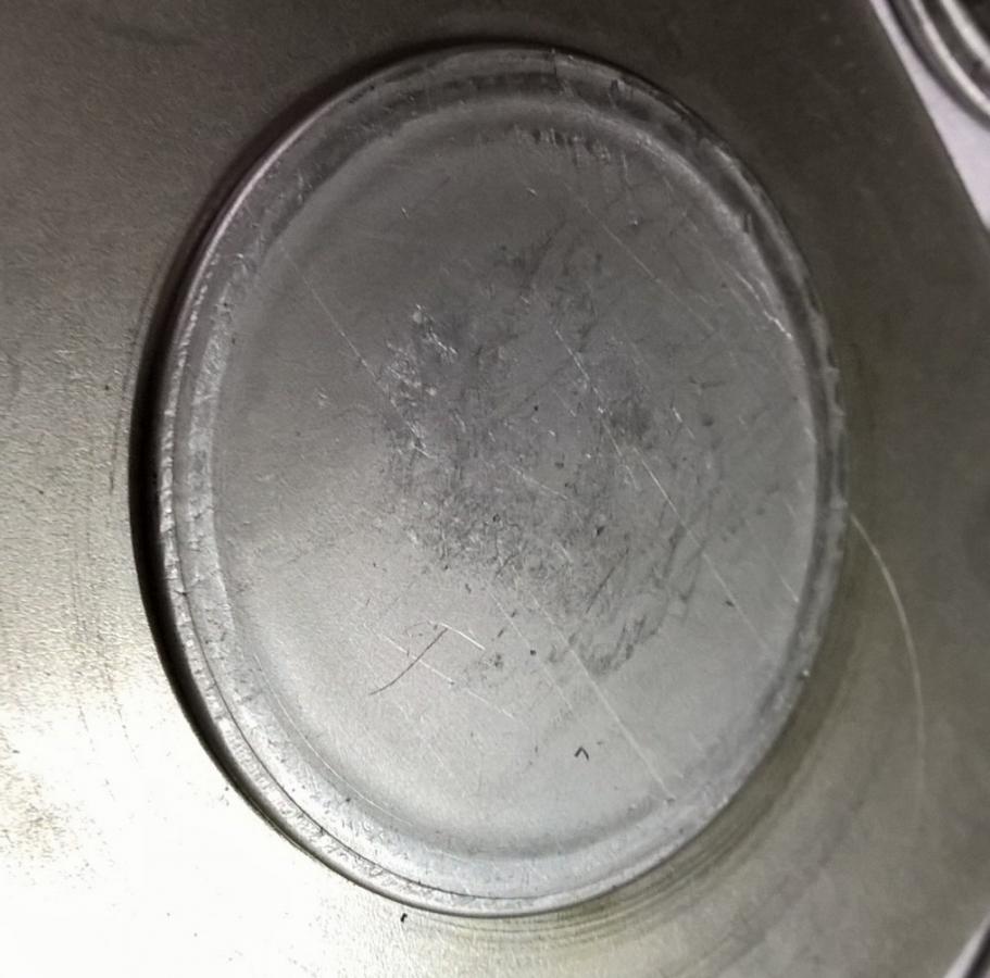

    And folded into a test piece with a 50mm hole
    I am satisfied with the result. It was not a 5 minutes Job. For more parts, the process must be saver. My experience with this little project is:
    - The blank must be perfectly round and must have a smooth edge. Otherwise it creats folds on the flange.
    - The diameter for this application allowed no reserve. 2mm more and after the first step (cup) you have a wavi flange.
    - Whe you press the cone, all parts (Upper, lower dies and part) must be precise and fix in line. Otherwise you will have to much scrap like me.

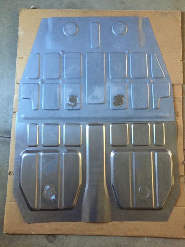

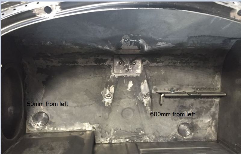

              I found the pictures and mark the holes on my car.
              Floor
Name:
              Battery Box
Name:
