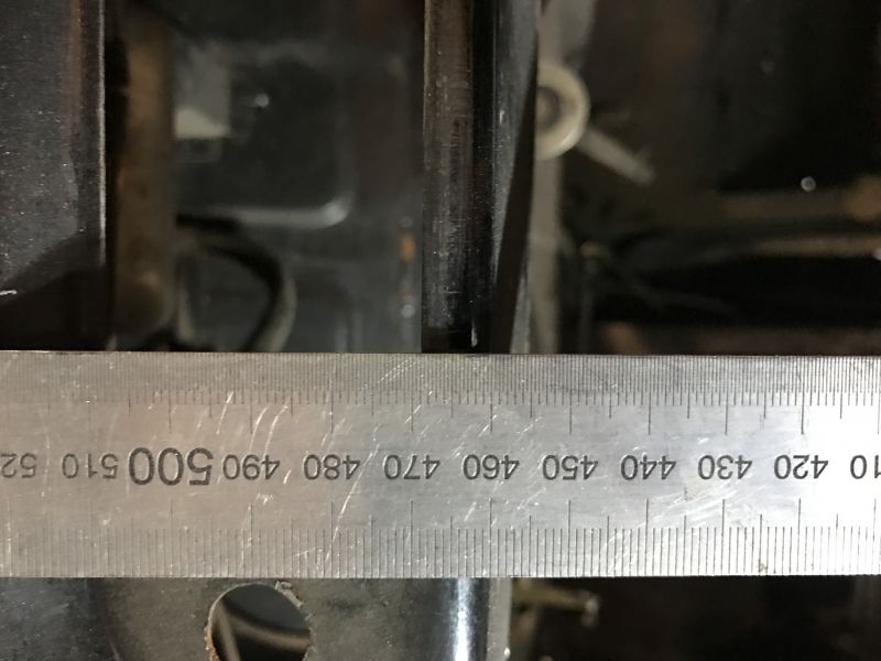

      Hi Scott,
      sorry a bit slow. I have a '60 BT5 and I'm confident that this measurement will be original I get 460 mm, see below:

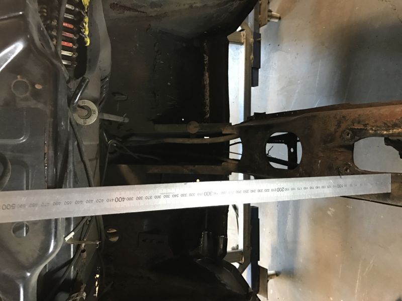

          Jonsey - can you confirm you get a length of the tunnel at about 52.5 inches. would you also be good enough to post two pictures - one of how the end of the tunnel marries up with the front brace brackets and at the end where it lands on the heal panel. A measurement from top of heal panel edge to top of tunnel would also be helpful. Thanks kindly.
          356 Registry main thread;

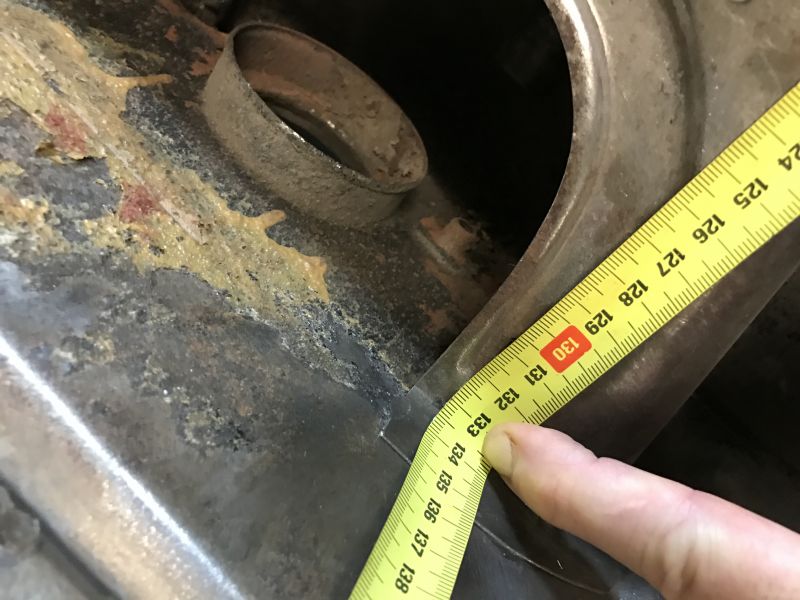

            Hi Scott, glad to help.
            The tunnel length is 1335 mm, which is 52.559in.

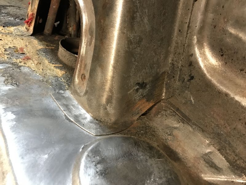

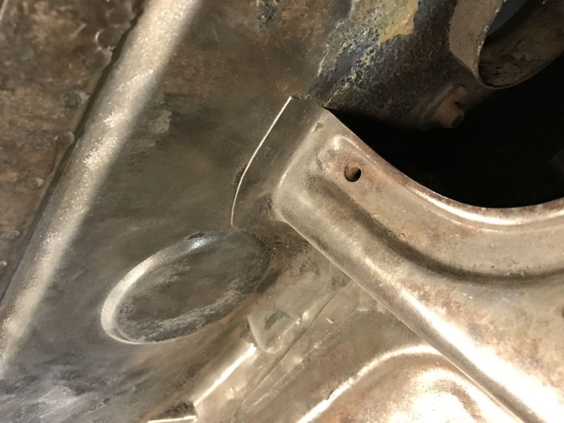

            The rear of the tunnel marries with a flange that has a gap on its vertical face:

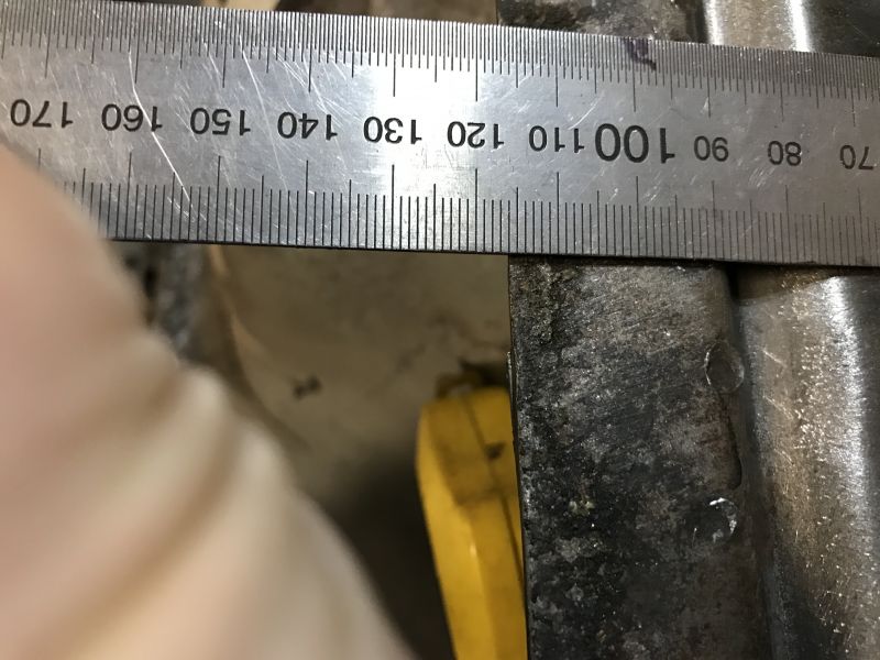

            The top of the tunnel at the rear is 116mm from the top of the heel panel flange (if this is original). I can get you the distance from other reference points if this is a drama.

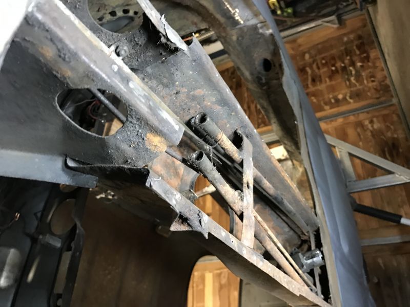

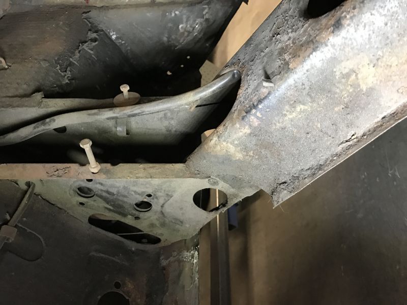

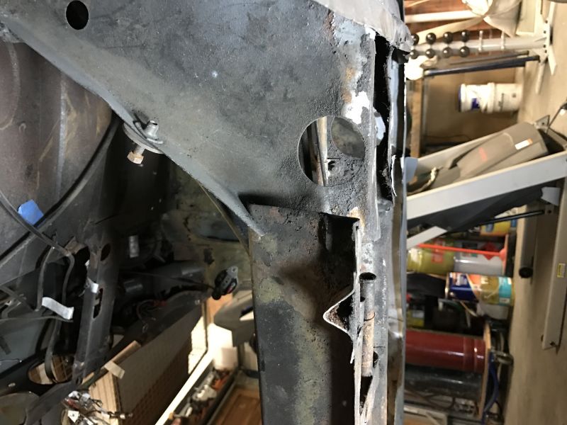

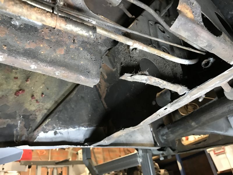

            The front of the tunnel is welded at the top to the front brace brackets, and has overhangs inside. I hope the photos show this clearly enough.
