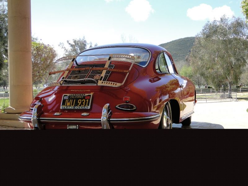

    For those of us who don't drive our cars on a daily bases, I have to say the the addition of an electronic fuel pump, has made a big difference.
    I took my 356 out for a drive today. I can't tell you how much easier it is to start up. I also wanted to mention what a great job Jack Staggs and Kerry of Staggs Auto Repair did in dialing in my car the last time I had it serviced there. It purrs like a kitten. It runs fantastic and just plain awesome. We are very fortunate to have great Mechanics here in So Ca for our little cars! Have a great weekend!

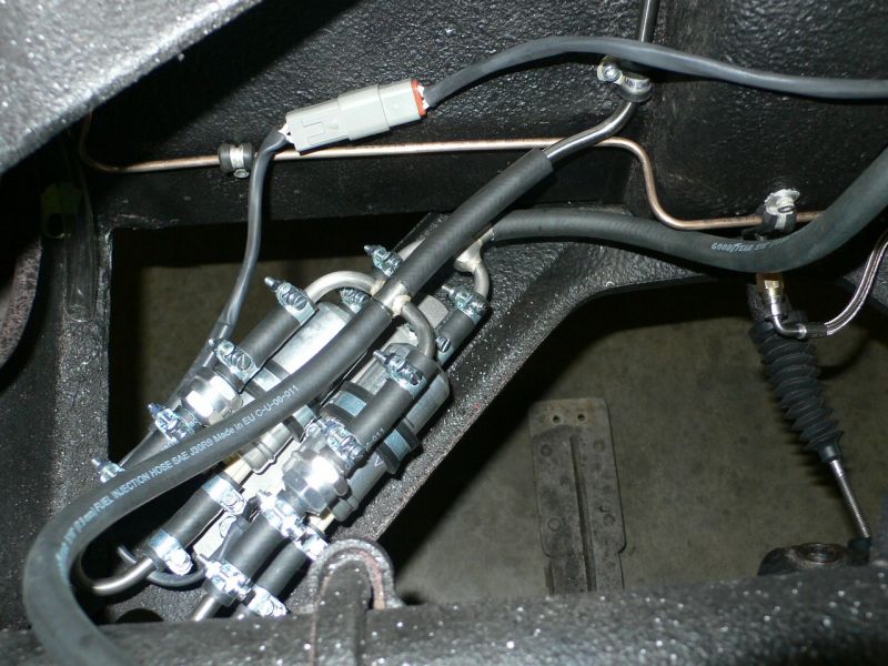

        Here's a beautifully executed dual pump system that Ashley Page did on his coupe in case you missed seeing it:
        http://www.abcgt.com/forum/6-Hot-Rod--Modified-356/8593-Some-light-weight-mods-to-my-356-restoration.html?limit=6&start=6
