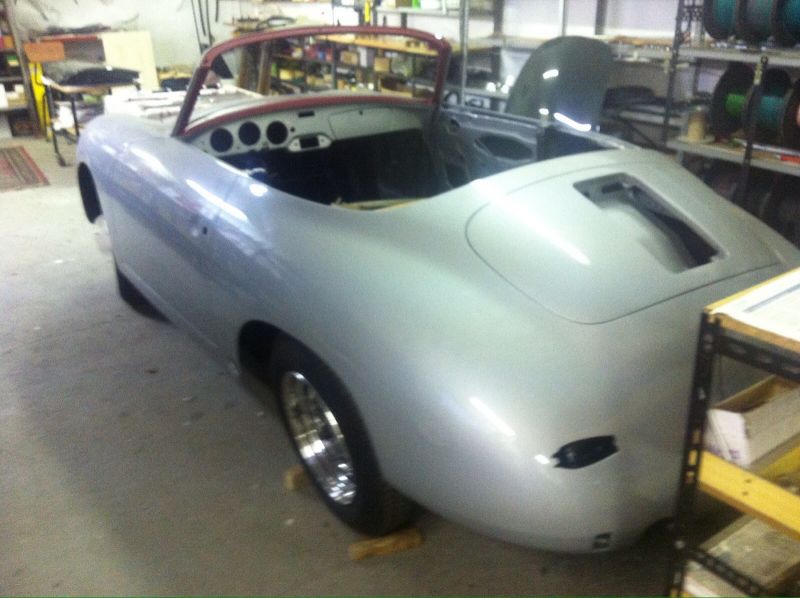

            Hello,
            is my first 356.
            Purchased in the U.S.A. in 2010.
            The machine is in the final phase of restoration.
            Matching number.
            356 A T2 MY 59 Convertible 1600
            Ciao!
            Enry

              Enry,
              I presume your car is Silver Metallic 5706. For the 58 /59 cabriolet they came in two standard versions 5706A Silver / red upholstery or 5706B Silver / green upholstery. The speedster 5706A was with red or black. ( You could of course specify your own requirement )
              The rubber mats for the T2 were tan and carpet could also be oatmeal which was used for many 356 cars.
              My 59 came with black rubber and oatmeal carpet. But mine is RHD so tan carpets were not available for RHD. Look on the link for current mats but study also Charlie Whites web pages on google. ( put in Porsche 356 colors to view )
              I bought a set of nice black mats for my car from International Mercantile in the states. Heavier than original but really good quality.

                couldn't open the attachment. your getting close, i'm about half way to being finished.I have most all the body work done and the engine is nearly ready to assemble. i'm trying to get some things together on the body before I paint. like cables, peddles and some of the suspension parts. also need to disassemble the soft top and paint, then fit the soft top
                Jay D.
                  Nello Roy,
                  Thanks for the reply.
                  Yes: the car si silver Metallic 5706
                  Ciao.
                  Enry
