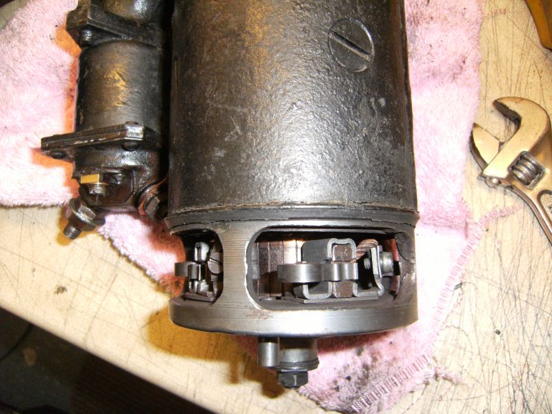

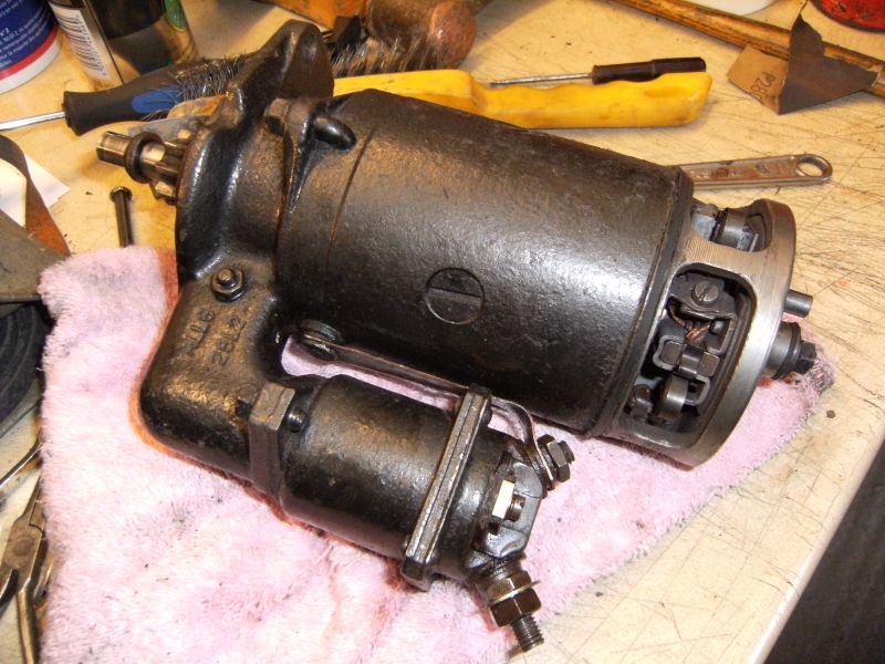

                Okay guys, I remembered I took some photos last year of my last starter motor removal.
                I have had the suspicion from memory the end cap of the solinoid is metal on my original version not plastic like the one shown in the last input link I put on a week or so ago.
                I have now found the photos I took and I attach them. Anyone??? please advise me if the end cap with the main electrical connection bolts is rivited on ( you can see the round headed rivits? I was hoping they would be screws
                If those are removed I guess I can get the cap off to clean the contacts like shown in my previous last thread input.
                Maybe I could put nuts and bolts in their place.
                But not sure don't want to go down the wrong road. All the latest 356 replacements seem to be for starters with later additions.
                Anyone cleaned the solinoid contacts on the version below????

                  Roy, I wouldn't be afraid to grind off those rivet heads and have a look inside. Replacement screws with some red locktight would work just fine or I'm sure you could find a local service there to spank some new rivets in for you. Rivets used to intimidate me too until I began working with them on speedster top frames and such. Grind one side flush and punch it though.
                    Thanks Justin, Yes that's the way I will approach it but I am aware the pull in on the solonoid by the coil of the electromagnetic switch has to set correctly as the end of the switch is pushed to contact on the copper contacts within that metal cap I want to remove. I will mic the flange width as I believe they have gaskets on that flange. I am sure you are right a smear of red hermatite and bolts and screws should work. ( The version shown in my post of a week or so ago has 2 screws only holding the plastic cap and the soldered connections so the forces must be light really.
                    We will see just can't trust the car till that ' click ' is resolved.
