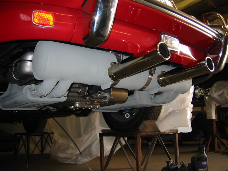

    has anyone cut open a dansk exhaust and made any alterations to enhance the sound and/or performance?
    Not that I've ever heard, but Jack if anyone would know if its been done. Do you have a Dansk muffler now that you're thinking of modifying?
      yes
      already have opportunity to purchase a custom under bumper sport muffler ($1000) but I've never heard an aggressive stock looking muffler( out bumper guards)

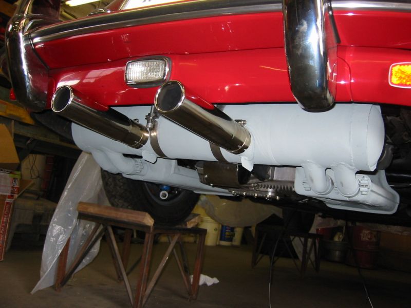

        This muffler was made from a Dansk 'sport muffler' but could just as easily been made with 'S' pipes. It began as a standard muffler but I had to create the 'Euro' mating. I worked with the internals and it sounds great now. Dansk mufflers are a great starting point, but alas, they are no longer inexpensive nor reliable in fitment...and the labor to create what's shown here wasn't cheap, either. But I had fun!
          Nice work Bruce! Tony Smetona and I have also done a few over the years with Leistritz mufflers. Some with " sport " style for T5/6, which require a higher outlet than A type, including one we did for Mike Clark's 1904cc T5 outlaw with nerf bars and 912 chrome tips through the factory body cut-outs, and Mike Allen's former rally car with European delivery heater system, which as you know was never offered with a sport exhaust option. I have no experience with Dansk muffler mods, but the Leistritz euro has a very strange baffle system that is not equal from side to side. The OP may be well served to read the section on Craig Richter's book "How To Make An Old Porsche Fly" regarding the "pillow affect" of a stock muffler.
            Sweet exhaust Bruce! Looks like a Carrera 2 at first glance.
