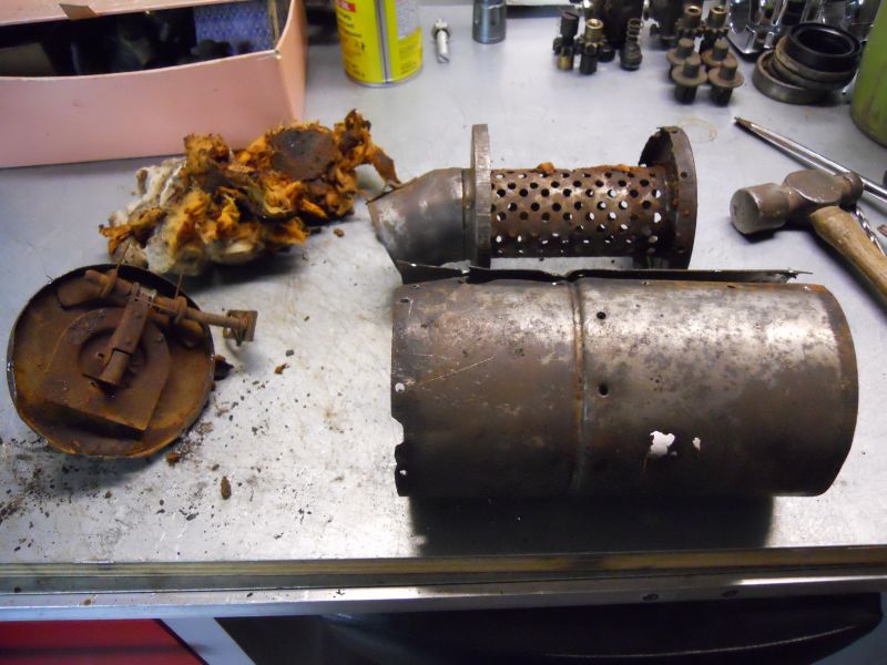

          Well I said the heck with cutting the grass tonight and started on the heater valves. its not as easy is I had hoped, I drilled the spot welds on the flapper end and it came off fairly easy. now the other end not so good. I drilled the spot welds around the mid section of the canister and don't see any welds at the end cap. anyway no come a outie! am I missing something ? or is it rust holding the center section tight, I've got it soaking now for a couple hours. I think I'll go cut the grass now

              somewhat crude but its apart what would one use for the packing? it looks just like the packing I use in dune quad silencer.
              Jay D.
                Congratulation, Not so scary now I'll bet. Yes, pack it with fiberglass insulation just like you would on a rebuildable exhaust silencer.
                  I'm not sure that I would want fiberglass detritus blowing in to the interior. Not sure what to recommend. Probably not asbestos...
                    Good point Jack. He could wrap fine screen around the perforated tube to filter and hold any loose fibers. But yes, other than that I don't what you would use. Is that packing originally asbestos?
                      Perhaps some fire retardant material for a couch or hvac?
                        yes I think you guys are absolutely right about the fiberglass particles blowing into the cab. also to wrap the core I think would work. i'm going to stop at my atv parts supplier and see what their packing material is made of. I also agree what Jack implied there has to be other products out there that would work, i'm going to do some research. now to derust patch the holes and epoxy paint.
