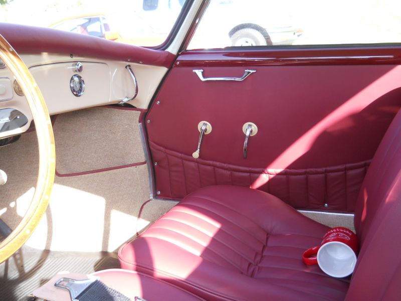

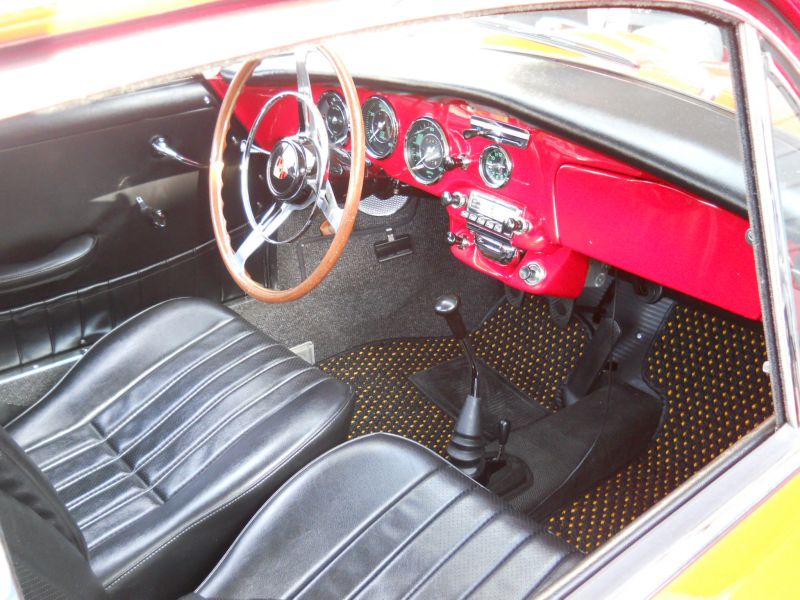

                They are talking about the actual dash pad itself and the door top garnish rails that "continue the line".
                356A cars and early 356B have the door garnish rails painted. These garnish rails are supposed to be color matched to the dash pad and the rest of the interior but I believe the factory began optionally painting these to match the exterior beginning with the B series. Maybe late A's but not sure when the cut-off began.
                Later 356C cars had the garnish rails upholstered rather than painted. Again not sure when this cut-off began. I'm sure Bruce or Jack could shed some light on this detail. Justin

                          Actually, on cars with painted garnish rails, some were pained body color, and some were painted to match the upholstery color. Depended on the interior/exterior color combo.

                            Your 1964 356C/SC is a "T6" model chassis. If you wish for a Red interior to replace the original Black that too will look very nice.
                            As to the Cap rails question front & rear - the 356 B/C "T6" models covered them in the same vinyl as the rest of the interior. I'm sure your originals were Black vinyl caps - and your new Red interior should have Red vinyl caps as well.
                            All the best to you with your restoration.
                            Michael Doyle
                            ps: On certain occasions (by example) a T1 or T2 356A model would have the Cap rails painted the outside body color - most times when the interior was also a matching color to the outside ie. Aquamarine Blue paint with blue interior - and blue painted cap rails.
                            And the T5 356B models would do similar as above and at times do a lighter color interior with body color painted cap rails. ie. Ruby Red with Grey interior - and red painted cap rails.
