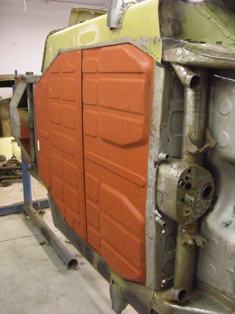

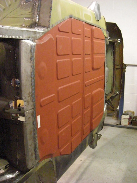

    Mark, I have limited experience with floor pans but so far I prefer the Simonsen panels. The embossments were all very crisp with nice detail. On the flip side I have heard that they are a bit "too" well defined if you can believe that but some really anal-retentive 356 guys actually can't accept it for the underside of their car. As a matter of fact I was talking with Steve Hogue several weeks ago and he was asked to soften all the corners and edges of the embossments on some simonsen's pans on concourse speedster restoration. He turned the job down as he had no time to spare but they ended up taking it to another panel fabricator. So what began as a 500.00 set of pans is probably a couple thousand once this procedure was finished.
    Simonsen panels used on a '57 speedster several years ago.
    I really like them. The forward recessed embossment at the toe-board bulk-head interlocked nicely. A completely different story with the pans I'm using on the current Coupster project now. A lot of hammering and heat to get those pans to fit up.

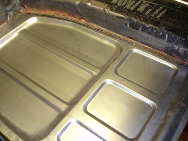

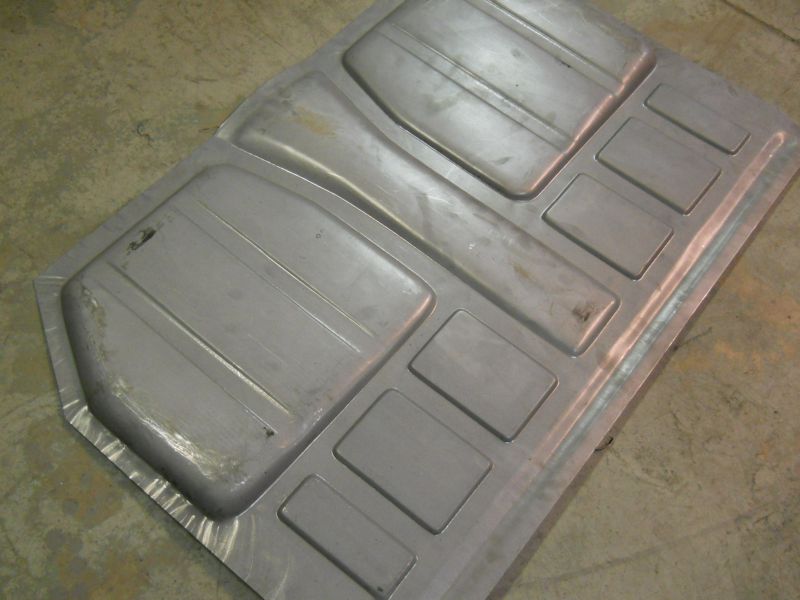

      Justin, sorry for the delay in getting back. I am familiar with Rick and my buddy Scott stops by his shop quite often. Rick's shop is just down the road from our shop so if you could help me get some panels from him hat would be awesome. I saw he had advertised that he had some B & C pans for sale on Samba, but didn't see any A pans. I would appreciate any help. I compared the pans sold by RD to mine and they are different. The ones in the pic you show above are correct for me. The difference I noticed was the embossed section in the rear in the center is different. Mine is thin like the Simonsen shown in the pic. The RD is completely different.
        Yes, the Simonsen panels pictured above are for A-model. The pan pictured below is for B&C. Sure, I'll give him a call tomorrow. You just need the rear or the front as well?
