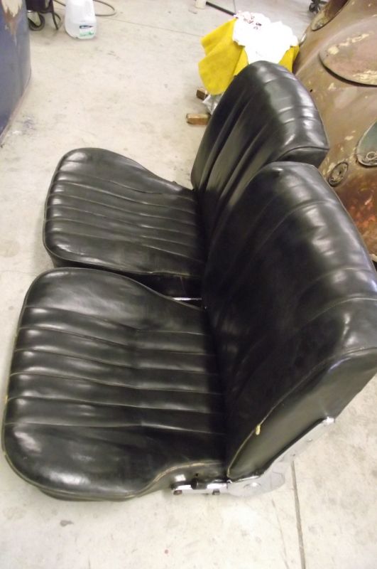

    Gordon, here's my pair of wood-based fatback seats still in the original black vinyl. I can get you detailed shots and measurements of all the pleats and their spacing and any other detail you might need. Just let me let me know. Justin

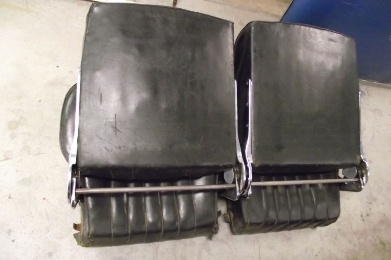

        If you have any question concerning the rest of T1 interior I can help there as well including door panel details. The original set above was from my coupster (57976) I have since sold these pieces to Road Scholars but I took detailed photos and measurements before they left.

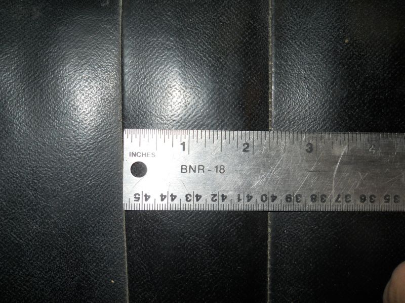

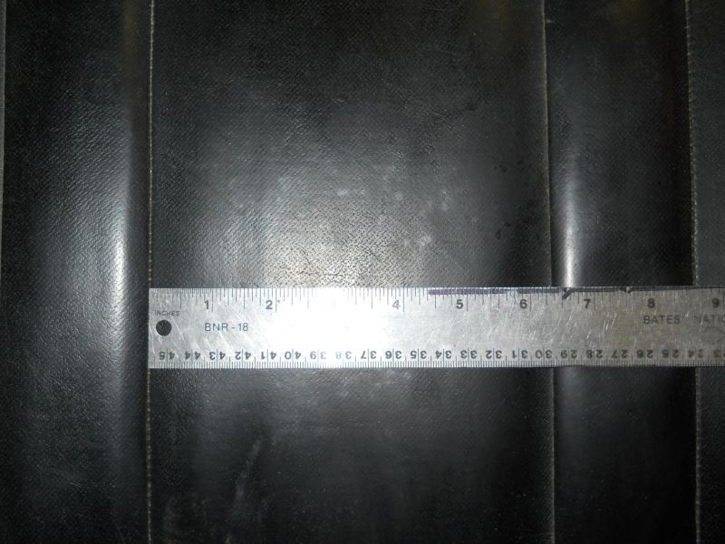

          Hey Gordon,
          Sorry this took so long; I had to dig a bit to get to it.

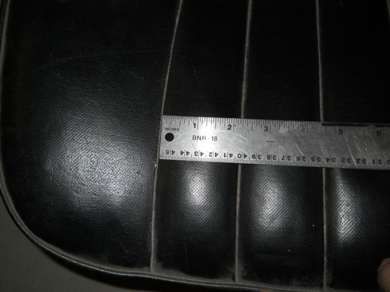

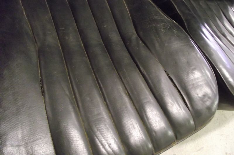

          Back rest pleat width
          distance between the pleats on back rest
          bottom pleats are the same width

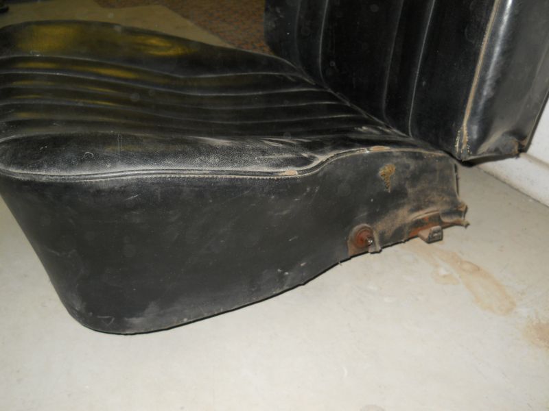

          Interesting stitch detail found on the inner side panels of both seats.
          Outer side panel does not have the stitch.
          Hope these help!
            Thanks Justin, that answers all my questions.
            My first guess would have been with the pleats too wide.
            Thanks again.Gordon

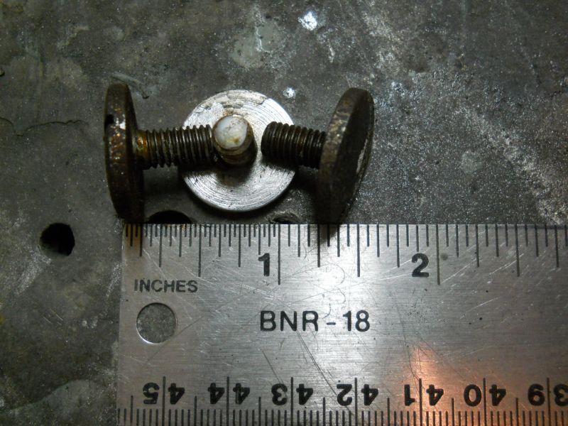

                    Hey Gordon, I'll get you a photo of one when I go to my shop tonight. Its a really large headed spade screw. The large screw on a 356 B&C rear apron to fill the optional reflector hole is about the same though it has a shorter shank. Justin

                      Again B&C rear apron hole plugs for the lower Euro reflector are identical except that the shank is a bit shorter but could work just fine.

                      If where missing these I'd consider having my machinist make me a set from stainless steel. Justin
                        Thank you Justin. Great measurements. Thanks again, Gordon
