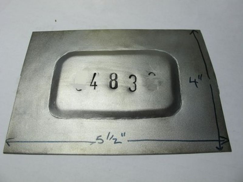

      Here's the "new" plate. I've blocked the outer numbers for his protection but I wanted to illustrate all the "red flags" this piece gives off. I only have limited knowledge (taught to me by Greg again)about the subject so you can imagine what it says to a trained officer. First problem is that it was punched in: "free style". The factory will use some sort of holding jig on the punches for a more consistent character placement. The spacing on either side of the "8" is off just a bit and this number was struck a couple more times than the rest. The spacing looks like he struck the 8 first and moved outward. The other tell tale is the 3 is out of alignment also calling back to a free hand punch job.(Though covered the first character is also misaligned) Another detail they will look for is "strike force" consistency across the numbers. On vins the factory will use a hydraulic press to make the impression so the depth and consistency is pretty much equal. A hammer blow(s) will of course not all be the same. The 3 has a valley around it where the others appear not to.

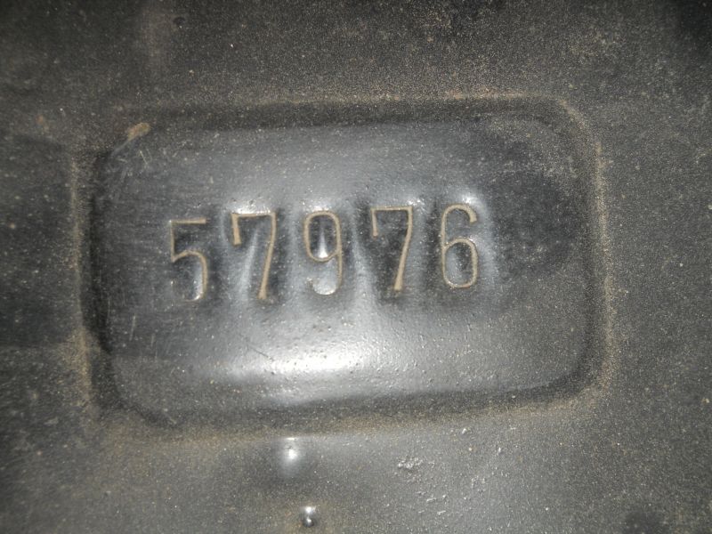

      By contrast here is an undisturbed VIN. Level and equally spaced characters. Deep well defined numbers with equal amounts of pressure applied. These are just a few of the details that I am aware of that they look for. The most interesting thing is that owner was more concerned with the font style of the numbers (for authenticity)when in truth the real problem as far a law enforcement is concerned is the way they are ultimately stamped in. If you're going to engage in this activity it better be convincing to trained eyes!
