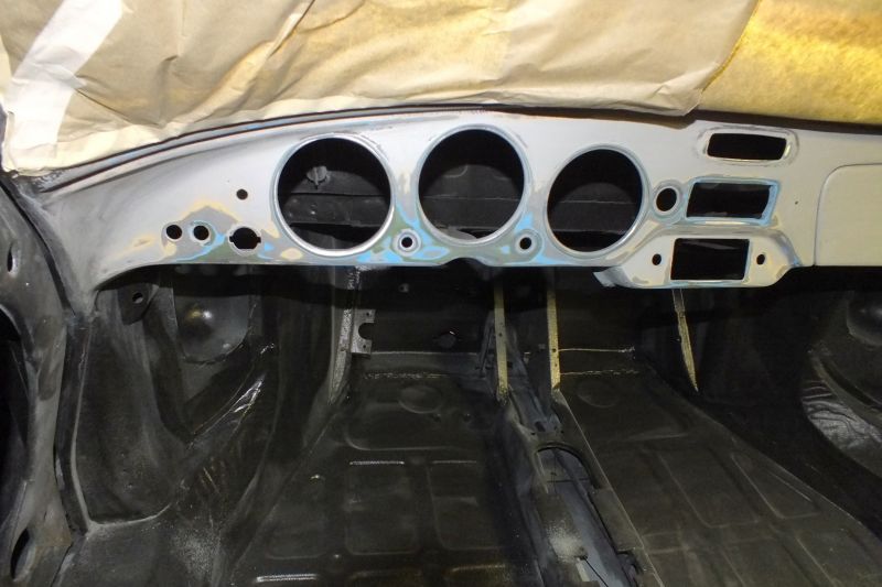

    I have two openings to the left of the ignition switch opening.
    According to the manual these are not original.
    Any input would be appreciated. Thank you, Gordon

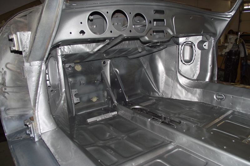

    Here's a shot from my '56 factory WS manual. No additional holes to the left.

    I have one extra hole to the left of my ignition to control the old autopulse fuel pumps.
    Hope this helps! Justin
