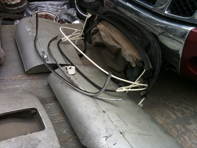

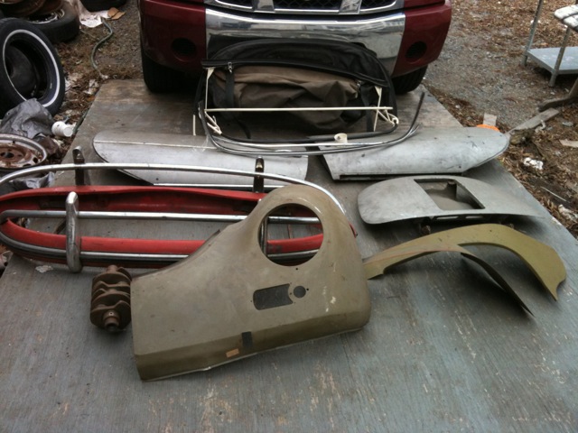

                        Justin-
                        I actually normally shy away from 4-cam stuff. Ironically, I was offered 3 4-cam engines yesterday, had my hands on them, but Carrera stuff is always over-priced and hard to move. So when we get it in as part of a bigger deal, I sell the hell out of it, but I don't normally buy it by itself.
                        Here was a load I sent to Ric a few years back. D doors, Speedster windshield and top frame, some green metal, and a Carrera II crank.

                          Hey Adam,
                          WOW! That stash of parts just made my heart skip a beat! How complete are the 4-cam engines? Justin
