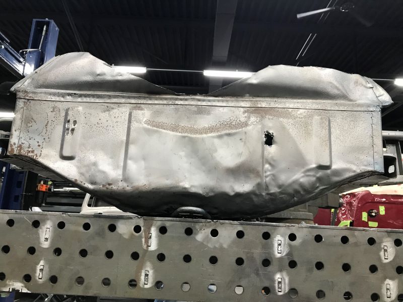

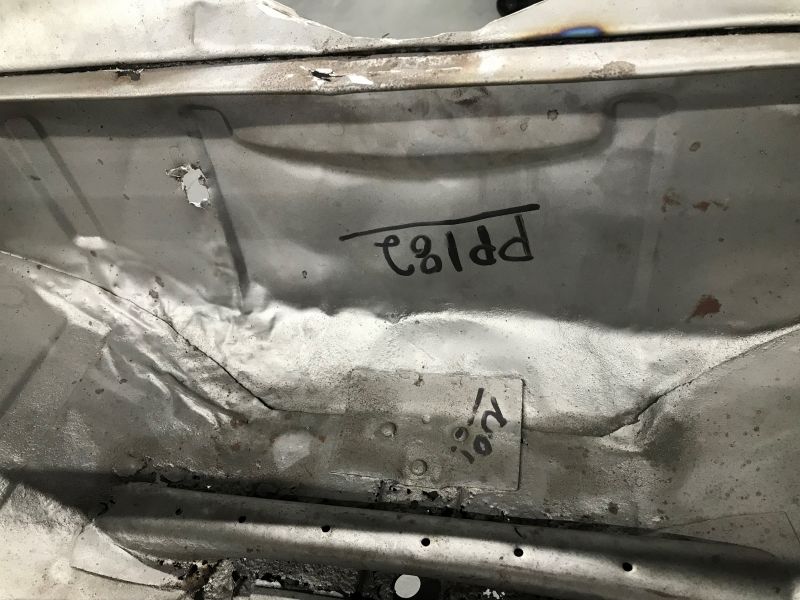

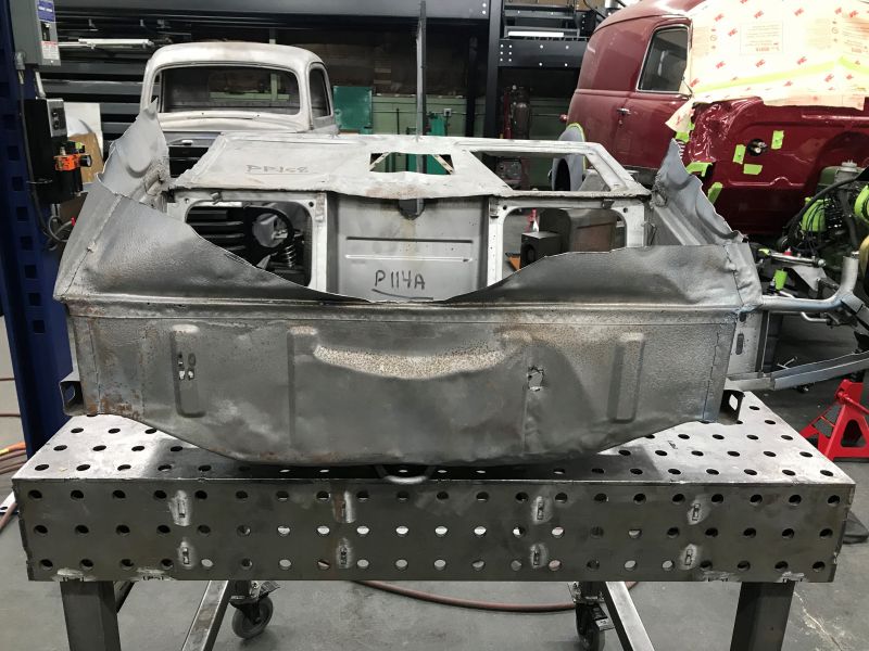

      Here are some pictures of the battery box we have which is a T2 box that was grafted on at some point.

      My concern is that the aftermarket stampings very depending on the manufacturer and I dont trust that the T2 piece we have is correct without further verification. I know its hard to get a good picture if the outside sheet metal is on but anything you can get is very appreciated. Also, your thread of T1 vs. T2 has been a great resource for us. Thanks in advance, Tinman

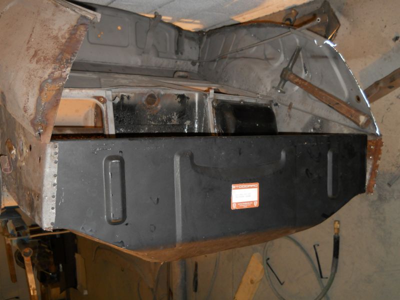

        The embossment details on that forward wall remained unchanged. The only difference I noticed from T1 to T2 was a slight change in position to the jack Perches.
        I was pretty happy with this offering we bought from Stoddard a few years back. The stampings where pretty nice.
