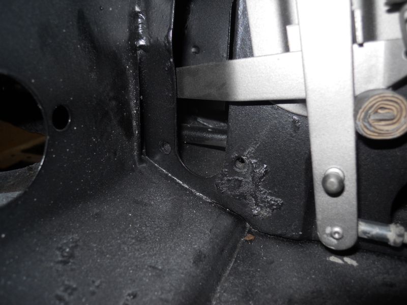

    i've had some extra time in the evening lately and have started to mount my pedals lines and cables. I have the throttle lever assembly mounted to the side of the tunnel and was looking in to were the hand throttle cable hooks up. I see two nuts welded to the tunnel just below the lever for the hand throttle right near the floor. for the life of me I can't remember what went there. I have it in my mind were everything goes even after 40 some years. one more thing what is a good book that shows most of where everything goes for restoring a 356. i'm working on a 58 356 cab. my mind might not be as crisp as I think it is.
    Jay D.
    Hi Jay
    Those 2 weld nuts are only used to support the throttle shaft on Right Hand Drive cars, so you're not missing anything.

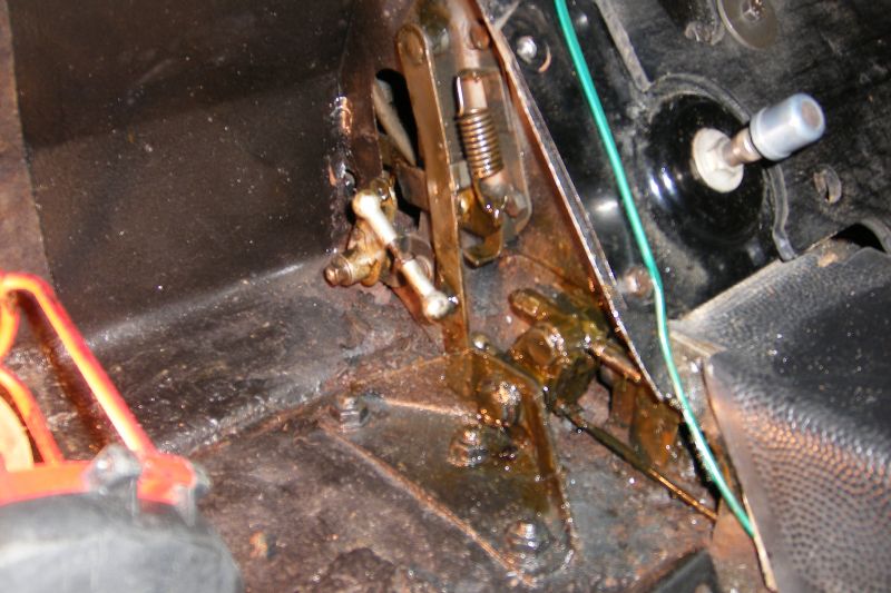

      Drew is correct. Here is a very old pic of my RHD hand throttle arrangement from 1959. Rather greasy and dirty back when I took that.
      And a bit confusing as Its not detailed in the factory manual on how it goes together. I remember mine slipped I rectified that.
