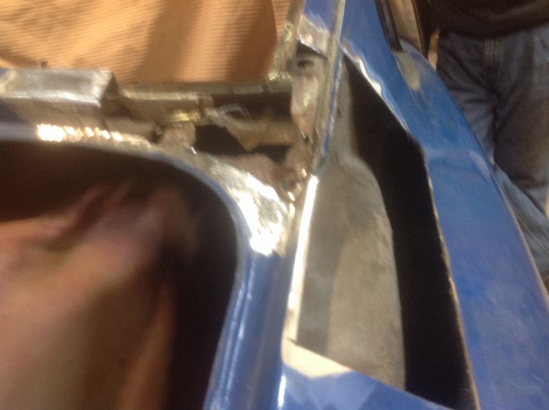

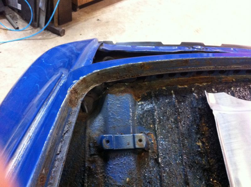

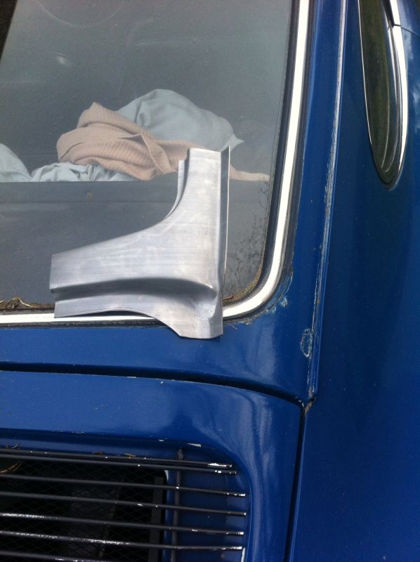

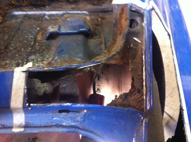

    Back in the late 80's I had a leak, right rear window lower corner. Used a little seam sealer and a hypodermic needle between the rubber and body/ glass to seal it up. Started with a medium bubble under the paint, right at the rain channel. Scraped it off, injected the rust with Formic Acid, left a scab looking but solid repair. Left it clear coat so I could watch it. Ugly but solid, first image is the before, the scab on the outside of the window, at the rain lip. Shown with the new replacement corner.
    30 years later I bumped the defroster duct inside the engine compartment and it fell down, seal ring, duct and orange foam hose remnant. Looking up inside the deck lid hinge I have a rust hole. So now off to the garage for some cut and weld. Got a corner from Restoration
    Design . http://www.restoration-design.com/

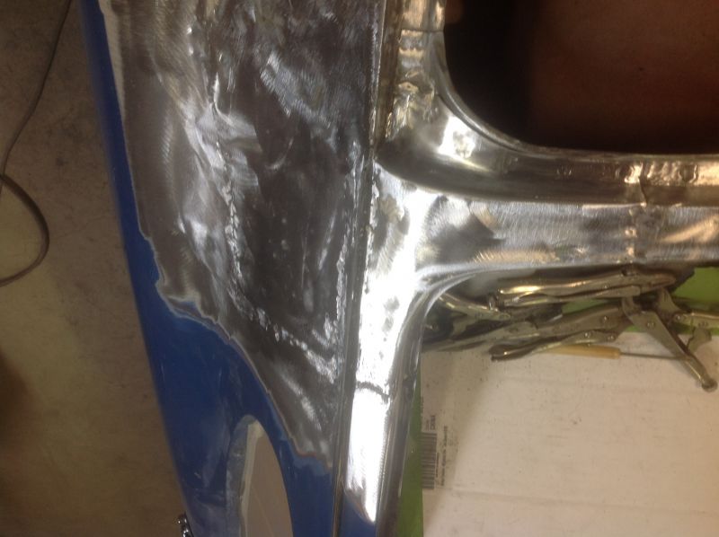

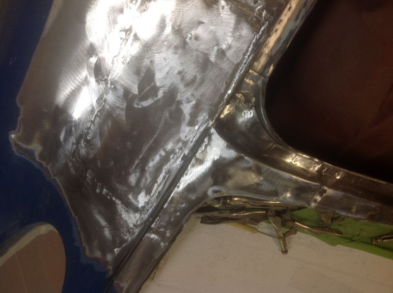

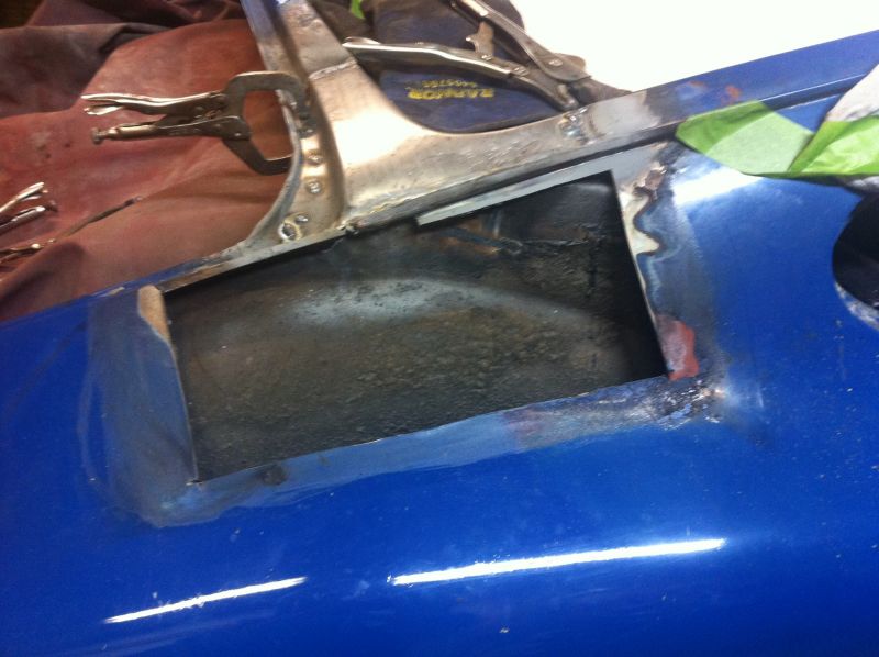

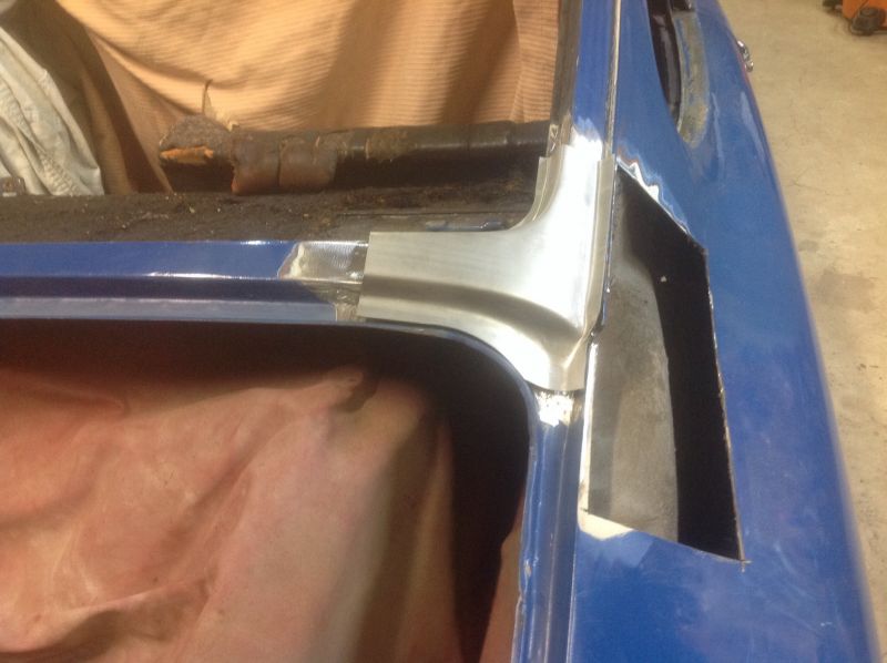

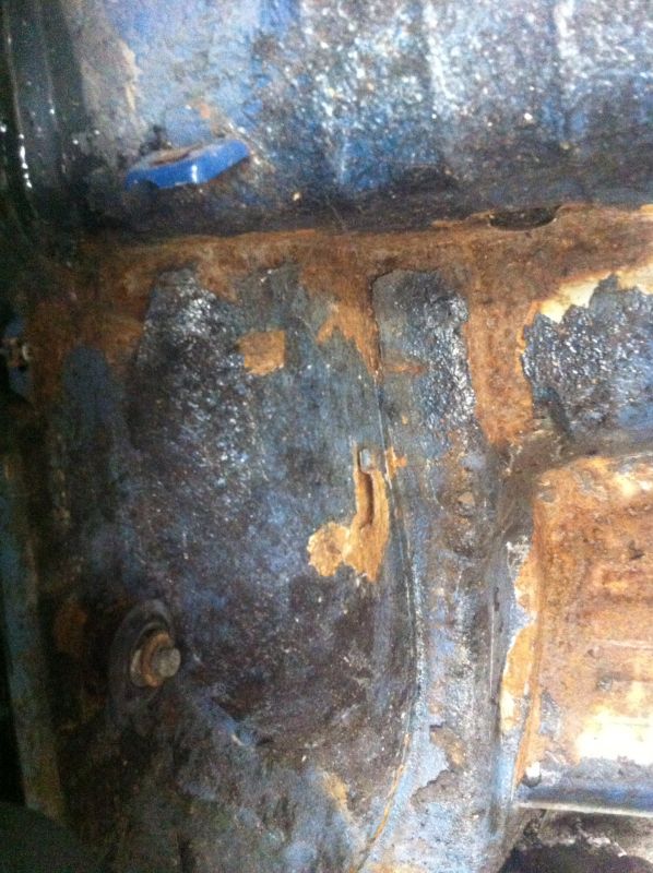

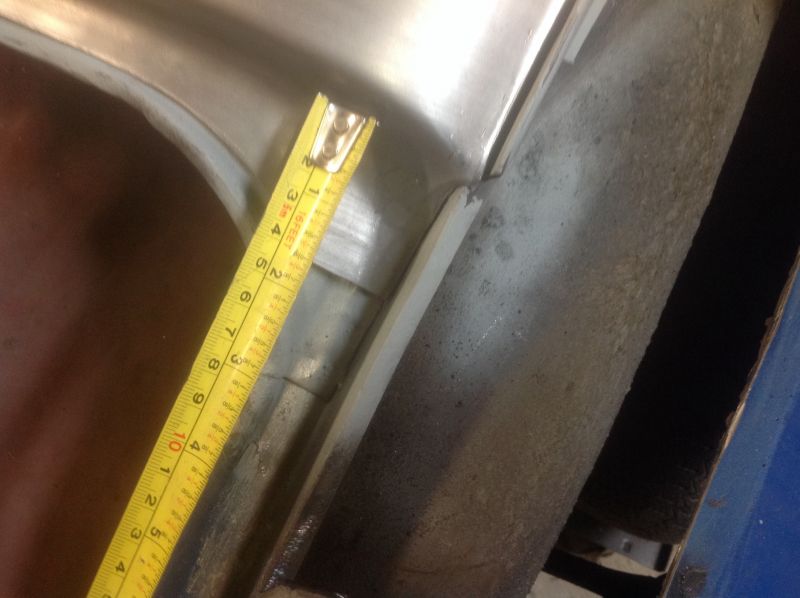

    Spent Friday morning cutting and grinding, below are the photos so far. Cut a big hole below the rail lip in the fender, thought I might have rust in the inner fender, but none there. All the rust was inside the cabin and through the fire wall, not not too bad after 50 years. Ground out all the rust, polished and treated the repair area. Hinge bracket and doubler are OK, damage was limited to the corner aft and outboard of the defrosted duct. A quick patch in the package shelf and then fit the new corner.
    New section fits OK but the inside is not a sharp of a corner where the glass seal goes around. A little hammer and dolly should bring it in.

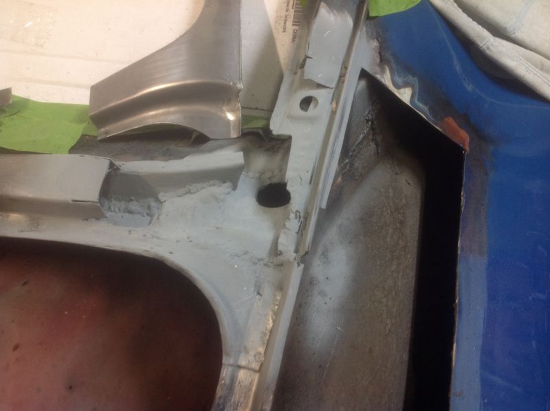

      Yea made the inner shelf patches today, not hard, just hard to reach to weld. Hinge is OK so it's just cosmetics inside. Will pick at the surface rust and treat it before I paint the package shelf.
        Inner package shelf patch back in. What a pain to weld, but it fits. Have to go off island tomorrow for seam sealer and filler, but ready to seal up the inside and fit the outer skin. Living an hour from the mainland is good until you need something special.

        Shelf patch in not pretty but solid.

        The repair panel could have been a little longer to pick up the original splice, but is better than making it from scratch, a little shrinker, bead roller and we will be good to go.

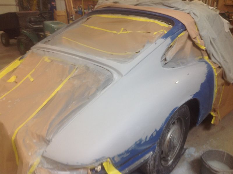

            Coming along. Ruff fit is in.

              It was only in the package shelf. SWB car has no cross member so it was just interior shelf, nothing on the chassis or fender. After I got it open, I could have dropped the motor and gone after it from the bottom. But other than the big square inspection hole below the drip rail, the rest was not too bad.

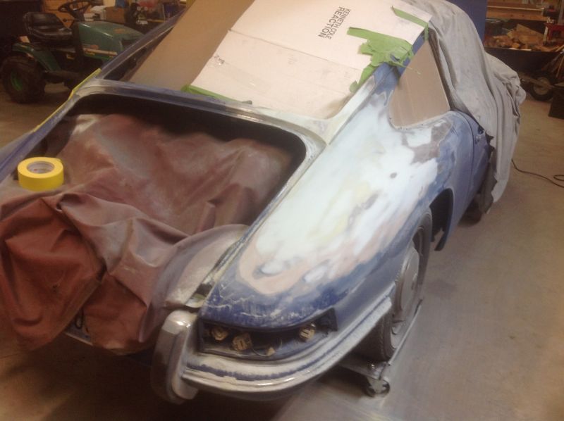

                    Progress

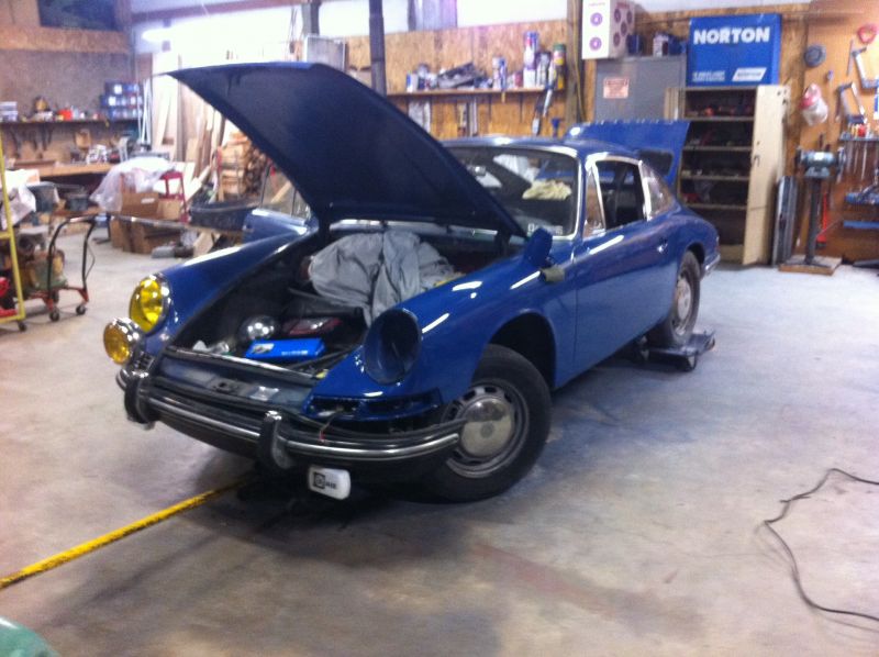

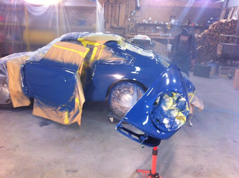

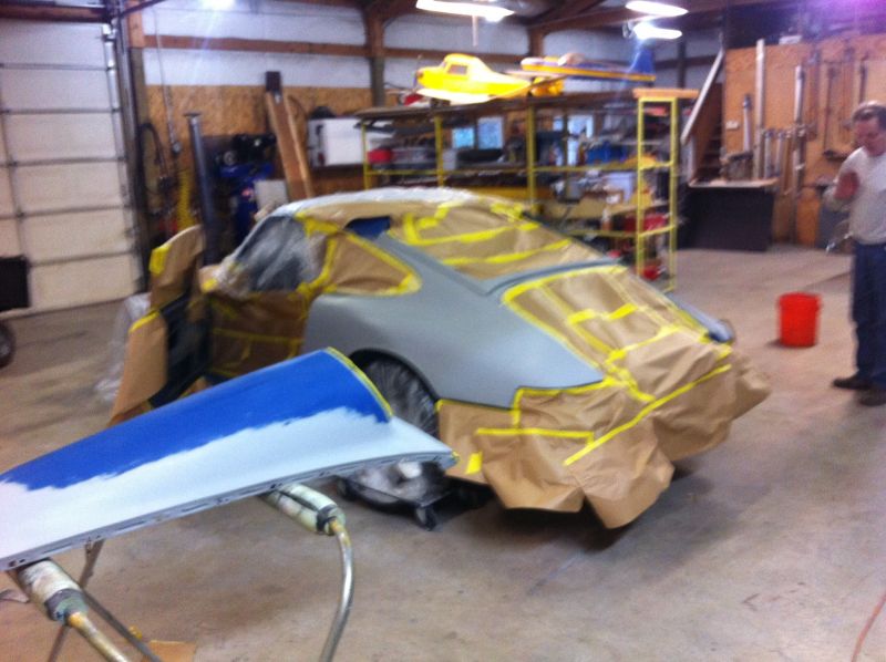

                      Well it's back together and painted. Turned out ok. The price of paint Glasuirt has gone crazy since I did this before. The repair was as expected, except it was just the parcel shelf inside, from the weep hole leaking in the window seal pinch weld. Could have gotten it from the engine side easier, but that is why hind sight is so good.
                      Did a bunch of touch up and ended up painting the other side while it was apart. Only a front fender and hood left. But that's for later this summer.
                      Now off for the interior refresh, have two Spinnybeck hides to cut and sew. Copying the Singer woven leather on the seats and dash. Should be unique
                      Now wet sand and polish

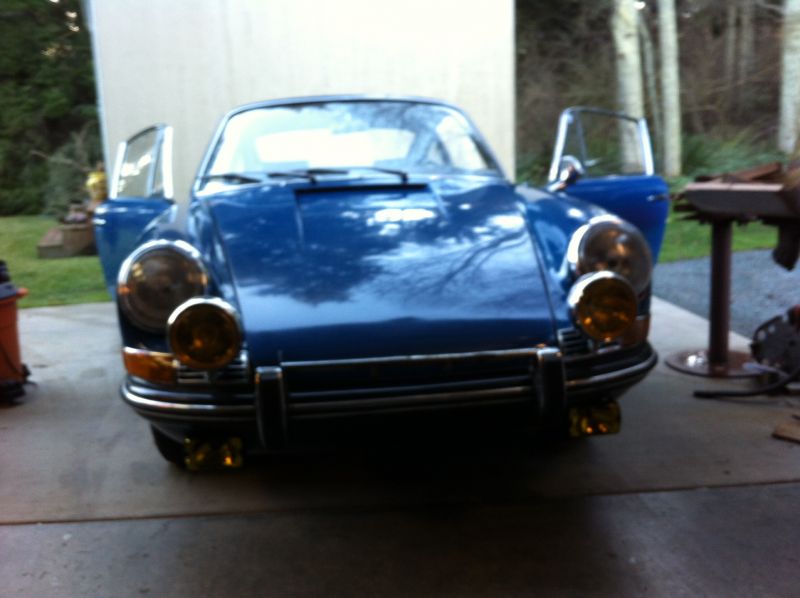

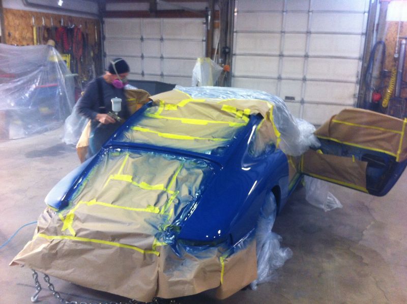

                        Finished. Shop with a Wood stove and no paint booth, snow outside, but 80 deg in the shop. Works fine for an Old Guy. Much better that the Earl Schibe 29.95 paint jobs I threw on the thoes T1 & T2 coupes in the 60s

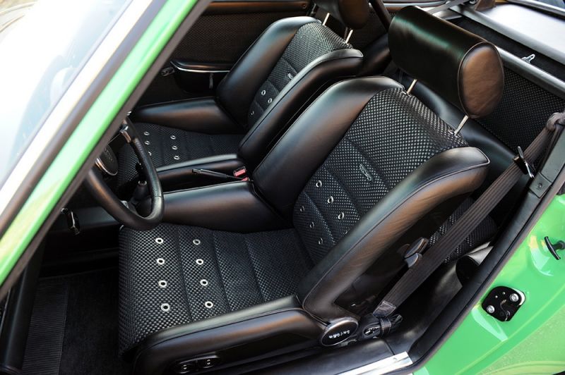

                              Target interior design, without the grommets. Using Singer Vehicle Design 911s as a guide, and materials source. After the hide and carpet prices, I know why their cars ar $400K.

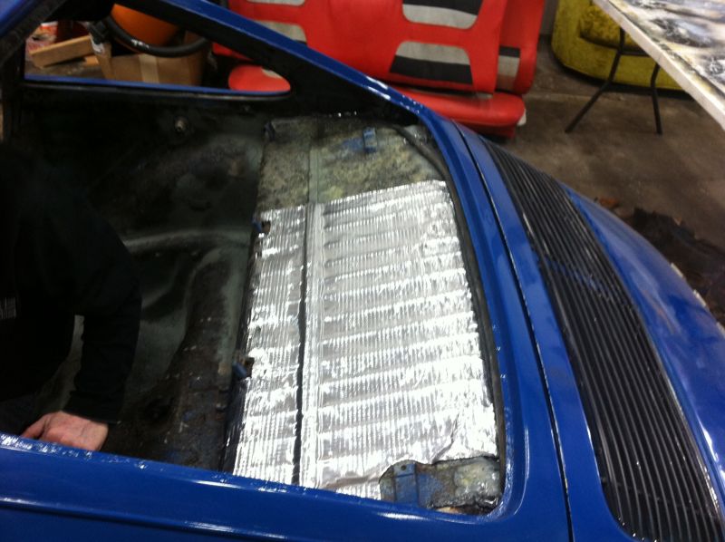

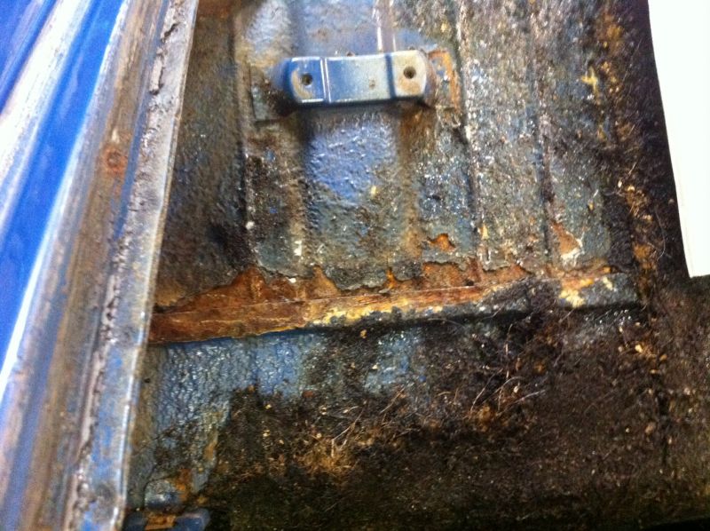

                              Removed the horsehair sounding and found some minor interior rust, I had not anticipated, but the water that rusted the shelf had to go some where.
                              Dynamat on the rear shelf, this will be covered with Dynapad, this brings the thickness back close to original thickness. Then the shelf card with the leather. It's just a process.

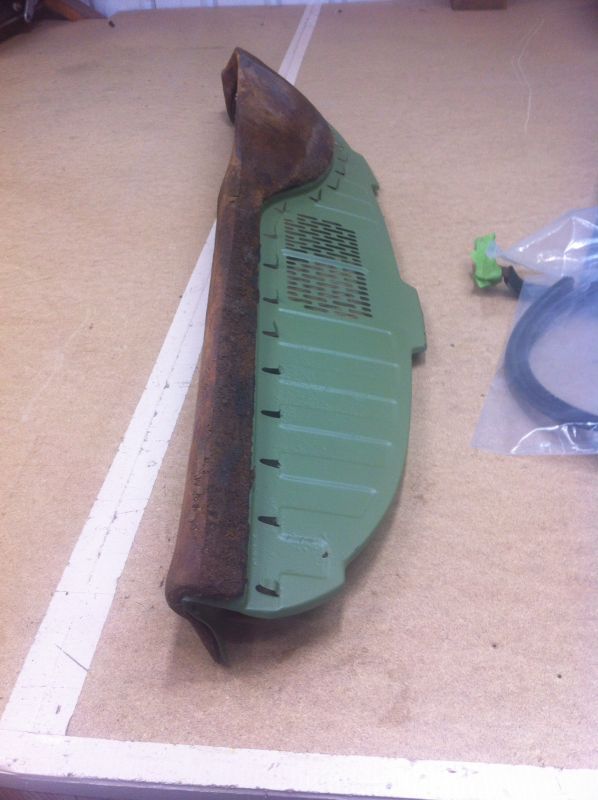

                              Dash was bead blasted repainted and the original padding coated with glass rosin before foam and leather. The green will be the woven and the pad smooth, should be unique for a 912.
