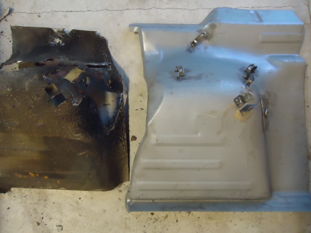

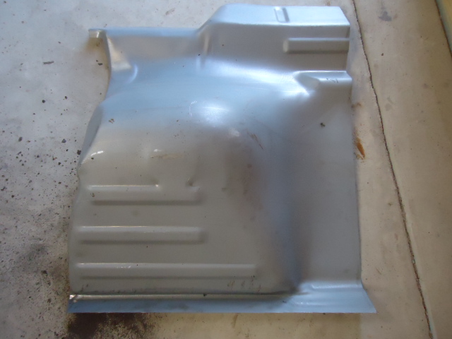

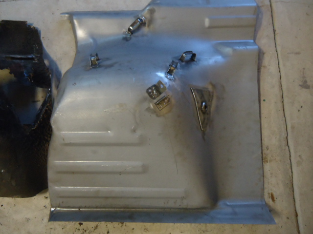

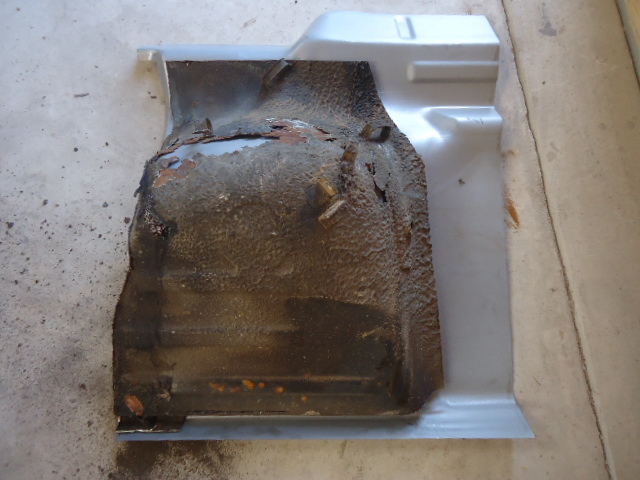

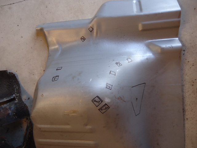

      Wrapped up the passengers side, and started on the drivers side today. There are a bunch of brackets for brake, fuel, and vapor lines that need to be transferred to the new part. Cut out the old and used it as a template for the locations.
      New piece, sans brackets
      Old piece laid over the new

      New piece marked for brackets

      Brackets harvested, cleaned up, and fixed to the new piece (John, the Quickspot made short work of this stuff!).

      Remains of the old piece, now without brackets, next to the new one. Time to trim and fit it to the car.

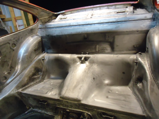

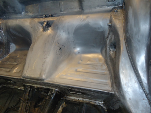

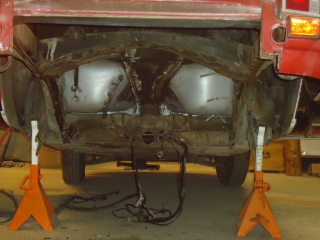

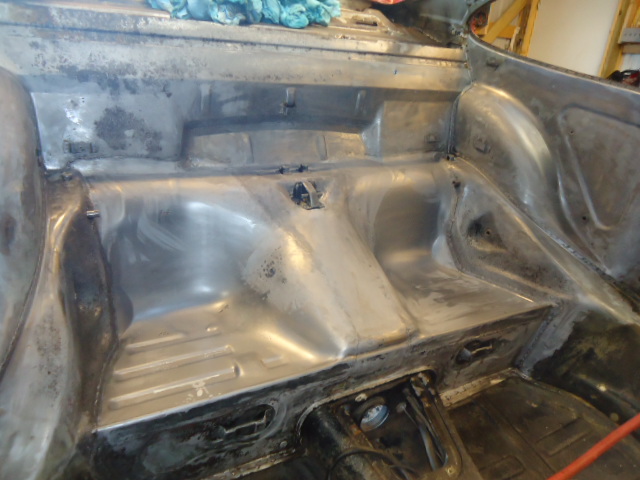

            Finished installing the left side seat pan, and fixed the box section at the junction between the package shelf/firewall. Almost there now. Just a matter of cleaning up some welds and painting/undercoating.
            Drivers side welded in. The long weld seam on this side came out much cleaner, thanks to Tom reminding me to grind off the galvanize.
            Looking a lot better back here now.
            Looks sort of funny from underneath, but its all nice and solid now. Going to be a lot of work to clean this up and re-coat it! Just noticed the sway bar brackets are crushed. Probably better do this too while I'm here.

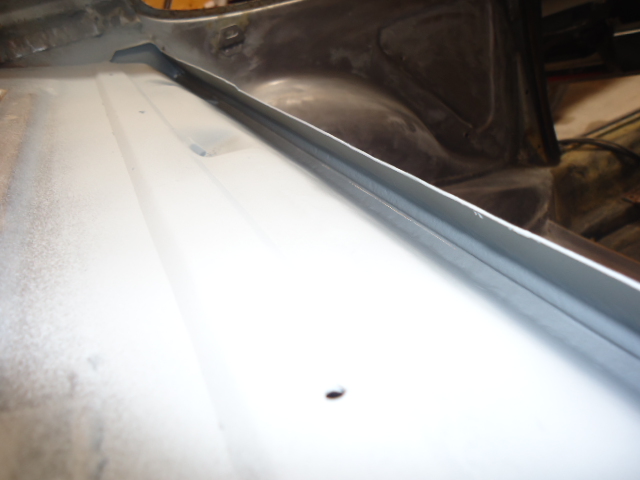

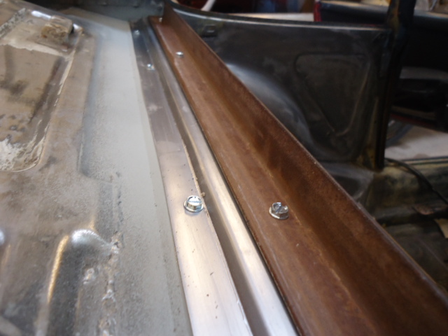

            Here is the box section at the top of the firewall with the badly rusted top cut off. You can see the shape of the section over against the far end. Cleaned up what was left and put a bunch of zinc-rich primer on everything. I previously replaced the forward edge of the package shelf. The raised area was made with a bead roller.

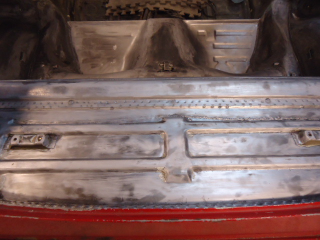

            New piece screwed in place. Used the bead roller (the same HF POS John was cursing, and it is pretty wimpy) to make the stepped flange that gets spot welded to the package shelf. I used the piece of angle you see to hold it straight and horizontal wahile I made the weld to the firewall. I was afraid it would come out warp while welding.
            And here its all done. The long butt weld is just above the stiffening indent. I still need to grind this smooth, but it came out pretty nice.
            Looking down from above on the spot welded joint between the package shelf and the box section at the top of the fireall.
