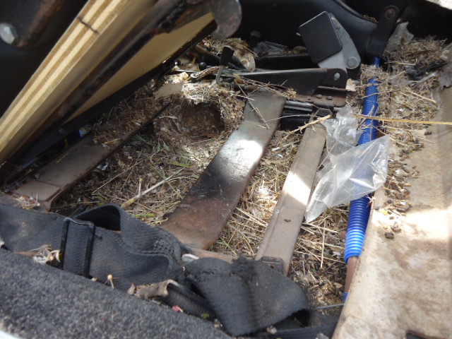

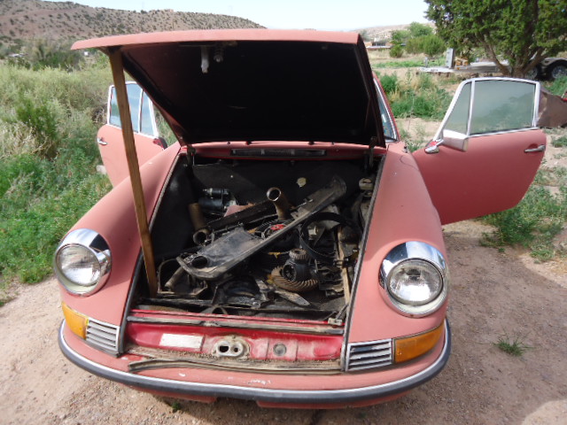

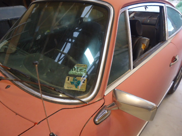

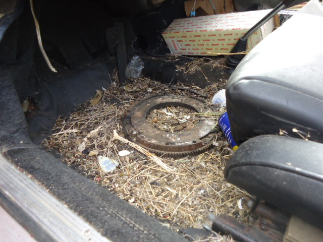

    Along the lines of Justin's "abandoned" thread, thought some might enjoy my weekend with the '72. I parked this old car out at my place about 15 years ago. Was a tired old driver, and not worth much back then. Motor was barely moving any air, and leaving a blue haze wherever you travelled. So out came the motor. It got rebuilt, but somehow I just never had the time or urge to re-install it. Now with the value of "longhoods" (that seems to be the new term, but I never called them that)going through the roof, I thought it might be in my financial interests to have a look at the old '72T. I posted a feeler out on the Pelican last week, and was deluged with interest.
    I took the first steps this weekend to evaluate the old '72. Took me half of Saturday to chop the weeds and brush away from it. First time I'd looked inside it in several years and the initial look wasn't good. Wood rats had moved in and made an extensive home of it. I almost gave up right then and there. They line their nests with cholla thorns. One hell of a mess! But I persisted, put some tires on it that held air, and tried to move it. To my surprise, It rolled easily after releasing the handbrake (got my first handful of cholla in the process). Rolled it around to the front and opened it up to let it air out.

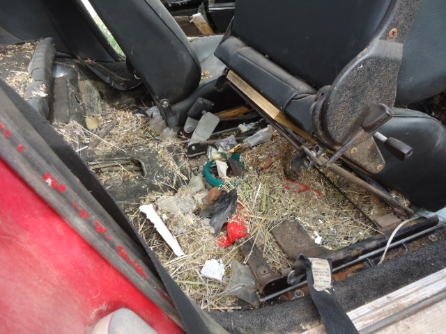

    Sunday I started cleaning it out. A tedious and unpleasant job, and many times I scolded myself for letting the car get like this (out of sight out of mind I guess). The worst is over now, but it will still go on for a while. In the process I got some inspection. As I expected the perishable stuff (carpets, upholstery, rubber) is completely shot. But underneath it all it was in perfect shape. Floors are still great. It will all clean up fine. Didn't get a look at the rear seat or parcel shelf area yet, but given what I've seen so far, I think all that probably survived well also. The factory sport seats (!) will need thorough refurbishing of course, but operated fine and the bases had no corrosion.

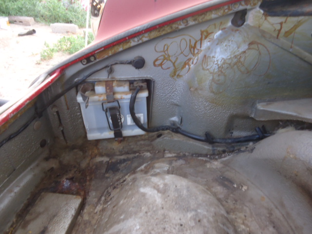

    Then I moved up to the front compartment. No rats, but mice had built a nest behind the fuel tank. Less painful to remove than the rat's nest, but smelled worse. Found an obvious rust-thru on the fuel tank support on the passenger side by the battery. Battery acid, and probably a little water got in there sometime. From the bottom all looks well around the suspension pan, but at least that one area will need attention. Everything else looked pretty good. The front lip on the front bulkhead that holds the rubber body/bumper seal is still intact, which I always consider a good sign. At least so far, I have not seen any sign of chewed wiring, which was my biggest worry.

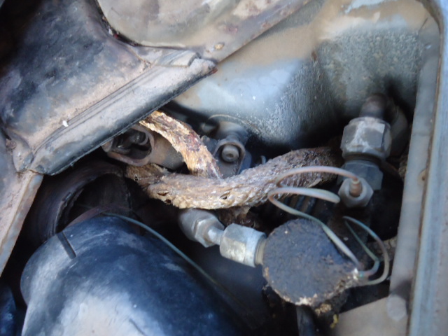

    Then I took look inside the smugglers box. It contained the mummified remains of a 4' bullsnake. He was all wrapped up around the AC stuff. I suspect he was enjoying life in his Stuttgart smorgasborg, ate one mouse too many, and got trapped by his own fat belly. After much finagling, I was able to remove him (in pieces). Finished up the evening with one more good vacuuming and blowing out, and moved the car into my workshop. So the process is started. I'll keep cleaning and inspecting. Maybe next weekend I'll dig the motor out from under my bench, and get the transmission down out of the loft.

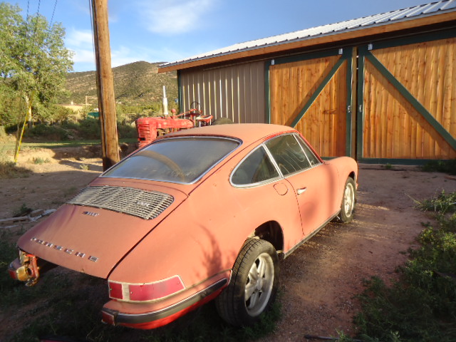

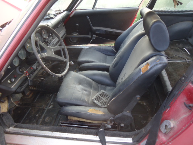

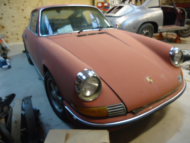

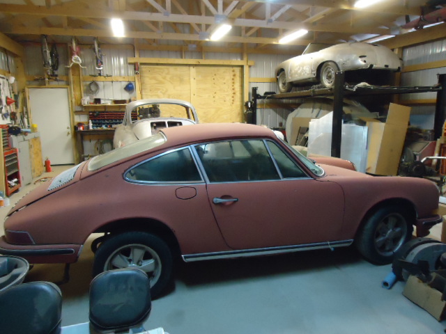

    So here it is, rodent free and moved inside my shop. Its still a really good old car. Straight, solid, and generally un-screwed with. A shame I've let it sit out there for so long. But if nothing else, the Pelicanite requests for pictures encouraged me to get off my butt and do something with it.

          Great pictures. The car looks better than a lot of others out there. Your weather preserved it pretty well. I bet it would sell quickly.

            Oh, and yeah, that snake was all wrapped up in there! Sorry, but I didn't bother to inspect him closely for mice. Part of him was going down the steering gear to the front crossmember, and that's where I think he gut stuck, fitting past the steering gear into the smugglers box. Fortunately snakes never bothered me.

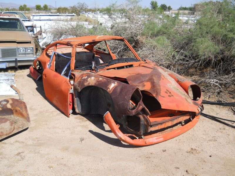

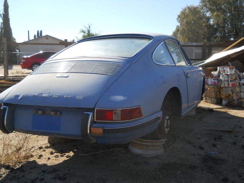

                  Thanks for joining us and Welcome!!!! If you like looking at dry desert sun-bleached cars here are two more I just took photos of though not near as nice as David's car.
                  '69 911E wrecked way back in 71 or 72. bent to shit but rust free. Still have the complete #'s matching motor.

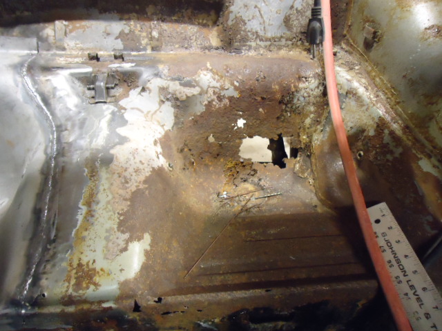

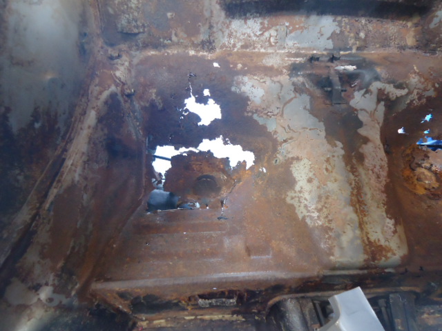

                              An update on the old '72. I found a good new owner for the car, who I think will give it a caring home. But, In the process of cleaning and fixing, I found a nasty rust problem. While all looked perfect from the outside, the rear seats had turned to red powder. There is a heavy formed rubber sound deadening mat in this area. Apparently water was seeping in the rear window, probably when it snowed and sat on the car slowly melting, and getting under this mat. Everything else stayed dry, or would dry out soon afterwards, but under the rubber mat it was 100% humidity. Anyway, since I had promoted it as a rust free car, I felt obligated to fix this before sending it on its way.
                              The problem on the passenger's side.

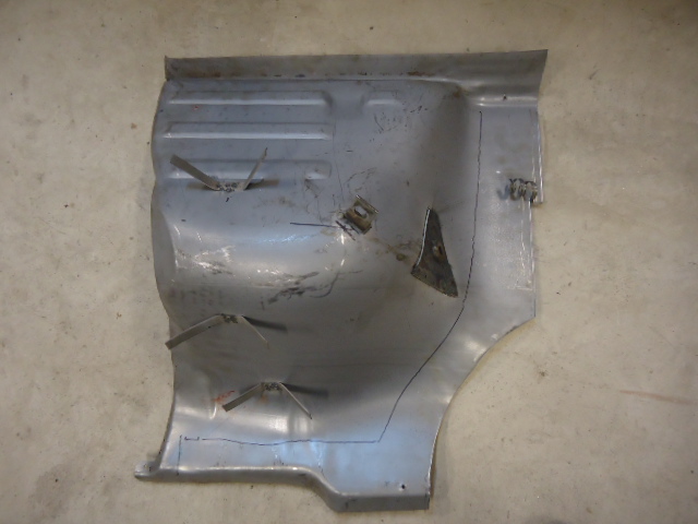

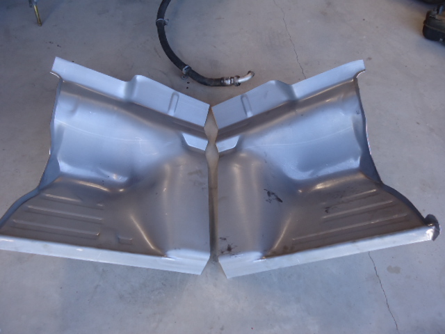

                              The fix. New seat pans from RD. While I've not always been happy with the fit and finish of RD panels, these pans are nice. They fit very well.
                              They didn't come with the wire loom straps, or the seat belt anchor. Made new straps from strips cut from the oversize edge of the RD panel, and harvested the seat belt anchor and brake pipe hanger from the old panel. Being on the exterior of the car, the seat belt anchor and brake pipe hanger were in perfect shape. Careful measurement of the old panel allowed placement of the straps and anchor, and the spot welder sealed the deal.

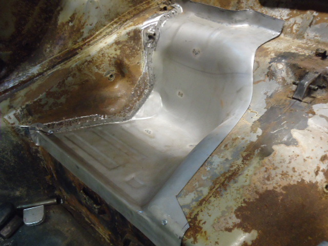

                              Fitting of the new seat pan to the car. The center "hump" was in fine shape, so opted to leave it and mate the new panel to it. Could have gone either way, but liked leaving as much good original metal as possible. The blotchy appearance is a combination of old silver paint, the brownish glue for the rubber mat, surface rust, and galvanize. This area in a '72 is definitely galvanized metal.

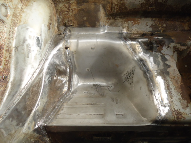

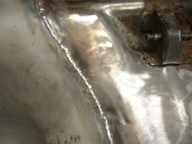

                              New panel welded in place. Plug welds along the outer flange, and a long butt weld with the center "hump". Have yet to do the seam with the rear wall. Probably get on that tonight. This piece Really fit very nice. Once all the welds are dressed, and its all clean and painted, this will be a very nice repair.
                              My TIG seam. Welding on the galvanize was different. There is a subtle difference in how the bead flows into RD's galvalume and Porsche's Theissen steel. It would occasionally want to splutter, so I had to go slow. I will have to grind this. It is soft and would hammer flat in an instant, and be neat and clean, but for this panel it is just not possible to reach behind it with a dolly.

                              Next I will tackle the driver's side. The rust on this side was not quite as extensive, but the repair will be identical.
