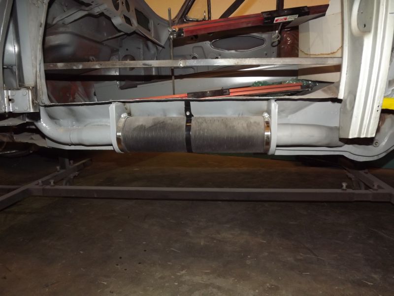

    At the moment, we are working around the left door using it as a jig to replace the outer longitudinal, rocker/sill and rear quarter panel leading edge.
    To begin my abcGT experience, I'll ask the following question: Does the leading edge of the rear quarter panel originally have a "Z" profile that mates to the lock post (B-pillar)? The replacement panel simply has an "L" shape or flange (Fig 1).
    Also, some might be interested in my attempt at rebuilding the sound/heater tube and tubing (Fig 2).

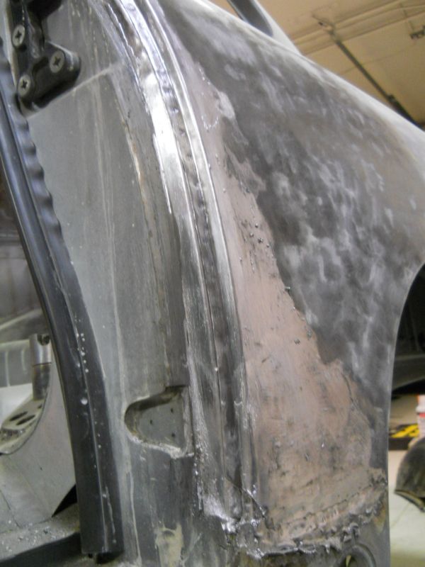

      Yes, originally the leading edge flange has the double bend while those replacement only have the single. IMHO its easier to work with what you have now as you have depth control on its mounting height to continue the line off the door evenly. If the second bend was there it could interfere with position depending on how deep the vendor decided to add it. It can still be secured to the lock post just fine the single flange and by the time its all releaded it won't matter anyway. Hope that made sense. Thanks again for being part of the forum!

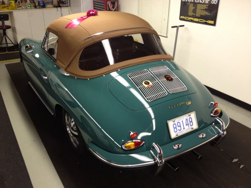

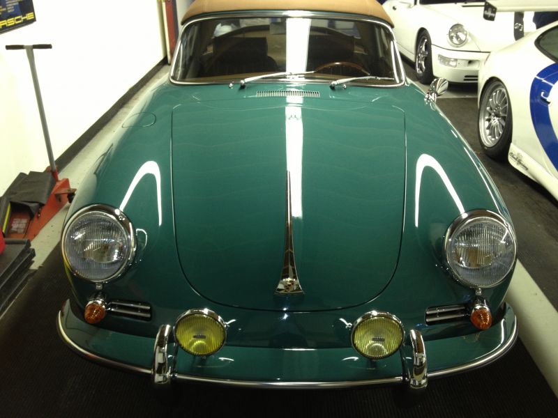

            This an example of Smyrna green, matched to this Cabriolet's best preserved areas of original paint. (Visual representations may vary with various computer screens.)

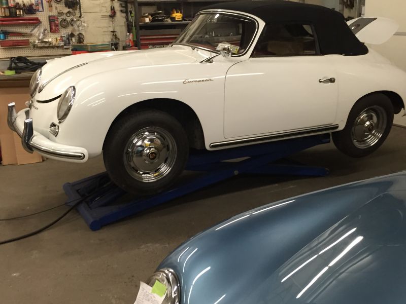

                          Good suggestion from Bill, but be careful. John and I have traded colo(u)rs (that's for Roy) and samples/formulas over the years that are now mostly extinct due to changes in chemistry and industry sales demands and government regulations.
                          In such a low volume of paint work and variable colo(u)rs, it seems that each time one is painted in a restoration facility, one must start over to create a viable formula.
                          John's samples are a good beginning, but get a 'second opinion' on your own colo(u)r. Colo(u)rs on 356s, even when new, changed from one to another by often very noticeable variances if seen side-by-side.
                          John's sample card of Stone gray, for instance, was very much more dark than the hidden areas of my own 356's dash, such as under the chrome switch bezels. His sample of Aquamarine blue was darker than the samples taken from 'safe' samples of original cars I used to satisfy a customer's 'color memory.' Other cards from John were right where I expected them to be.
                          The bottom line is that your own 356 should be what YOU like for the color, whatever that may be. Go to a show, an event, and see how many variations of one color there can be.....like Ruby red. Pick the version YOU like and go from there....asking and networking until a fairly large sample can be sprayed and taken into many kinds of light to see if it floats your boat.
                          The man who owns the white Cab pictured below wants it back to the color on the foreground, as that was the original of record. Luckily, he really likes what was formulated for that....but he is still sending me pictures of others he has found online. That's hampered by computer screen interpretations...and on it goes.

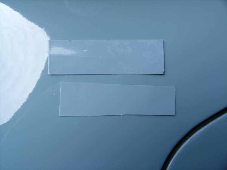

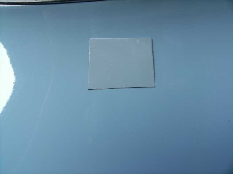

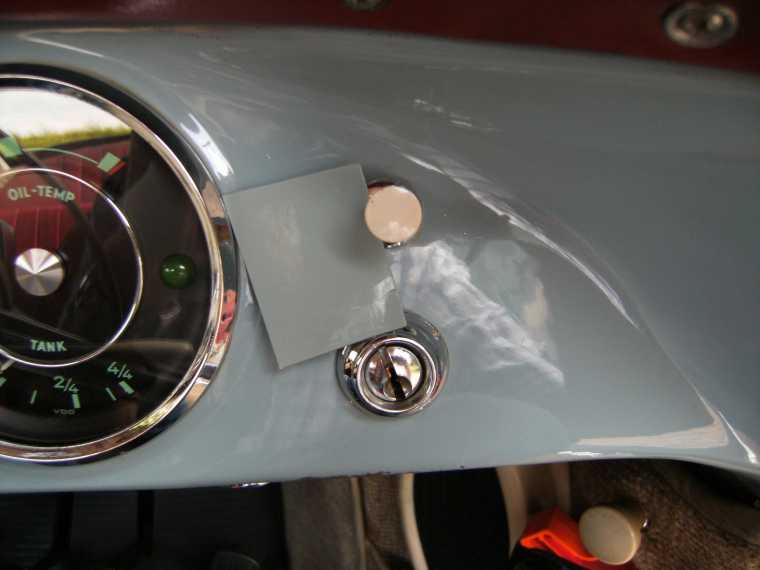

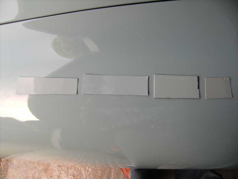

                            Bruce is correct, the current suppliers of 356 paint offer a colour that is usually close but not a perfect match. Take Meissen blue. I have seen a number of paint swatches from various people. I have an original factory dash panel that people have asked me to check with their obtained sample. None of them so far has been exact. The Wilhoit sample was too light blue other's were too dark. Meissen has an element of green in it which is so important. A swatch compared to a small area can be seen to be different but when the car is resprayed as a whole entity the car by itself probably looks original Meissen blue. That's why Bruce's comments about making a choice from the available suppliers is important. You have to be sure it suits you and your eye.
                            I attach a photo of some swatches held up by my dash panel. Of course online photos of colours are not like the actual painted item in front of you, its not always an easy task to be sure its correct.
                            I guess like Bruce mentioned suppliers now work with different paints mine was cellulose, now not used.

                            These sample pieces were all sent to me by various people wanting to paint their cars Meissen blue. Can you see the differences some more green than others some too blue.
