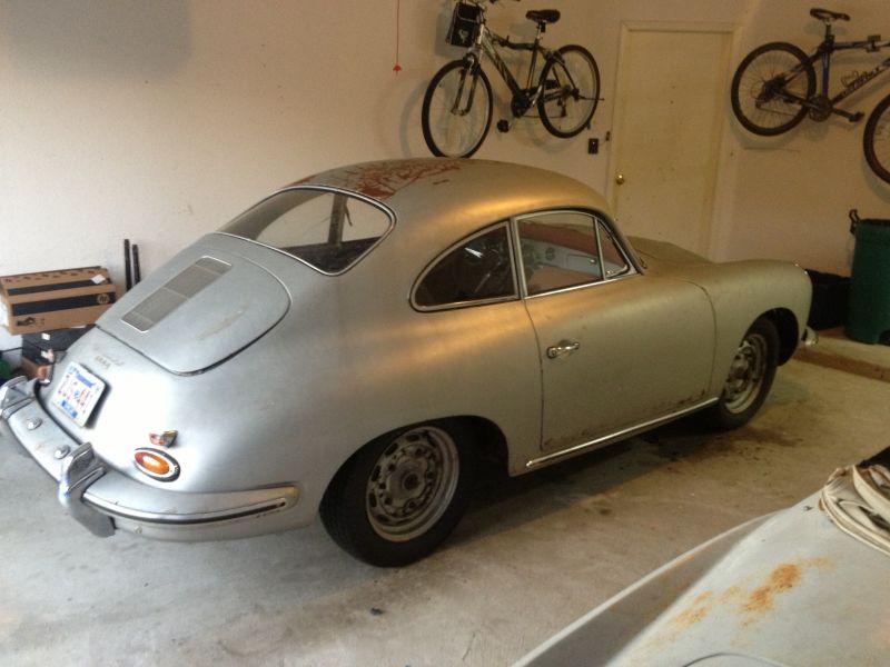

    I got a 1960 356b a few weeks ago. Been one of my dream cars since my dad had one when I was a boy.

    It runs and drives, but I'm having a little trouble with the lights.
    Brake lights, blinkers and low beam headlights don't work.
    I found a wiring diagram online for 356b, but I'm not sure if it is for t5 or t6 and I don't know if those are the same or not.
    For the brake lights, according to the wiring diagram I have, 6 volts goes from the master cyl, through the blinker switch, to the lights. I have verified 6 volts coming out of the blinker switch for left and right, but it is not getting to the tail lights.
    Before I went tearing up any wiring, I thought I would check to make sure the diagram I have is correct and the brake light wiring doesn't go through the blinker flasher or anything.
