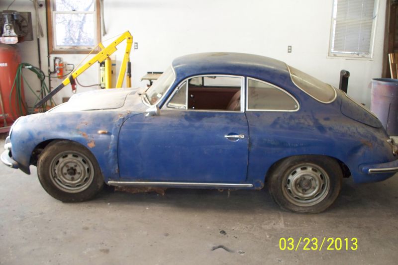

    Hello all,
    I am restoring an Albert Blue 1964 356 C Coupe at home.

    Nice starter, how is the bottom and floors. There are many examples here, on what to do and how to do it. What do you have for publications and tools?
    I think this is a Glasurit BALIBLAU 6412 1964-1965 they also had a EMAILBLAU 6403 in 64. I don't show an Albert blue in my data. The photos look a little light for 6403. Paint tag in in the drivers door will have the code.

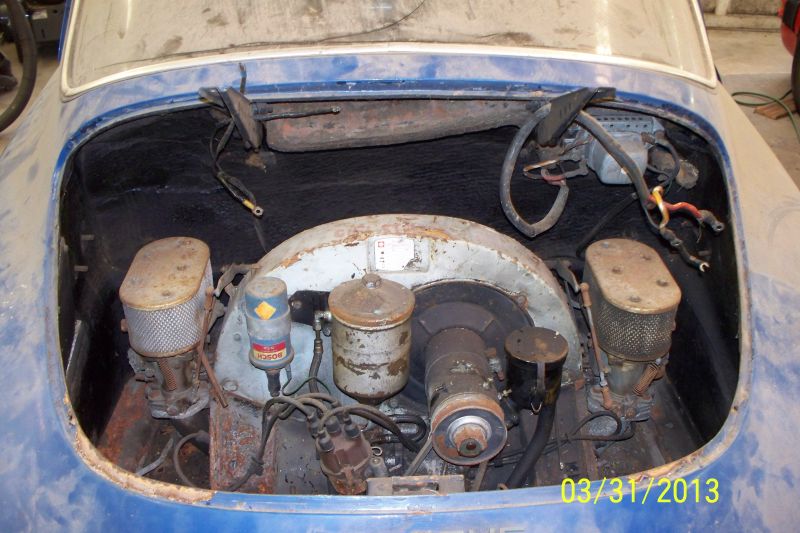

    Looks like the engine has been changed, its a S90 motor. What is the engine number?

        JB, I think that would be the most faded Bali blue ever......
        Maybe 6403 Sky blue? 6012 Konigsblau? 6003 Aetna? Hard to imagine a preview of Albert on a 356, but it could have been done and not for the first time. More common though to have been a backdate.
        I see the side maker on the left fender....spent some time in Europe?
        You are correct- first check the left door hinge cover plate plaque!
        Still, looks like a good project 356. My late mother used to throw an old saying at me regularly: "How did the little bug eat the elephant? One mouthful at a time."
          Ah, I saw the other thread and see the sand-back and the darker blue under the primers and lighter blue.
          As Gilda Radner's Roseanne Roseannadanna (spelling on all?) would say on the old SNL...."Never mind...."
          Ah, THERE is the COA......

            Looks closest to Sky Blue, 6403, of the standard C colors, but closer to the Oslo Blue, 6203, B's I've seen. Of course your data plate should have the correct code. Folks could order any color they wanted back in the day.
