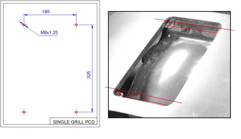

    Hello Everyone,
    I need some assistance with regards to the 356 deck-lid luggage rack tabs, I am looking for basic dimensions of the depth from the outer skin to the top surface of the tab, top and bottom tabs please. Shown on Sketch attached.
    I have the P.C.D of the threaded hole (Weld Nut) tabs please comment if incorrect.

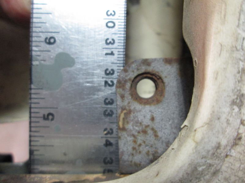

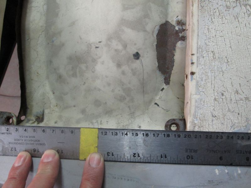

    Hey Manny, I took these for this evening:
    Width measured from the center of the opposite hole.
    Length measured from the center of the opposite hole.
    Hope these help.
      Justin Thanks a million this is a huge help.
