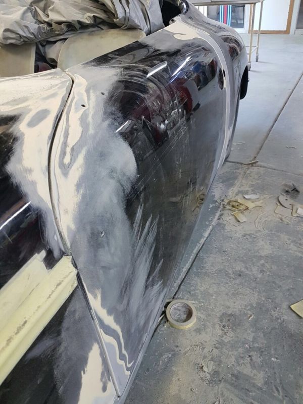

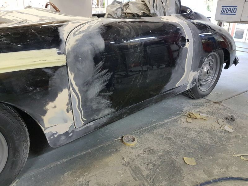

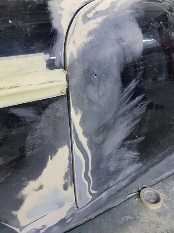

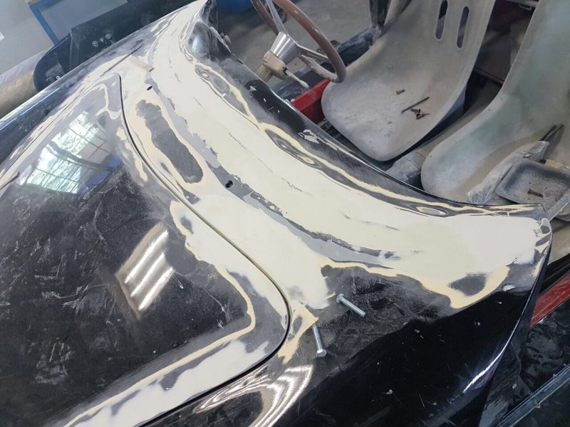

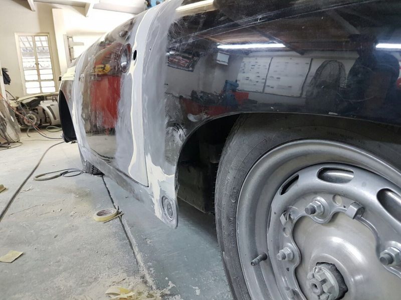

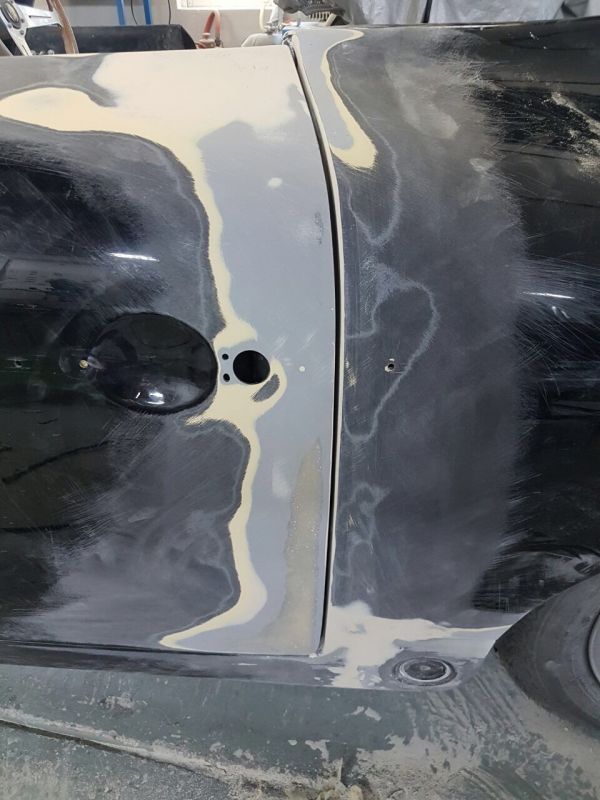

      As mentioned in a previous post, most of the work on the speedster is almost done it is mobile, needs a few minor adjustments and finishing touches but there are a few minor issues that Armand and I discussed in detail all the work and modifications that has gone into this project, why stop there we noticed that the gaps and flushness on the hood, deck-lid and doors did not look correct, besides on the front left wing has a nasty bulge which distorted the flow lines of the speedster this was due to the nose job modification.
      From the start of this build I planned to model this speedster after the 1958 Speedster T2 sadly we have not much options in the South Africa and had to settle for a Pre-A body shape which is the only speedster kit available in SA, this has the curved rocker panels which is not correct for the T2, to obtain the T2 look I needed to rectify the rocker panel, once again I am grateful as Armand came to the rescue he had a set of T2 steel rocker panels which we used as a mold. Below is a few pic on the progress .

      • #78
        They're never really "done" are they Manny? Like the way you're blocking the doors in with the body. That should really clean up the body lines nicely. Great work!
        • #79
          Your'e absolutely correct it never ends, I am really hoping this is the last hurdle I need to get it done, I spent thirty odd years looking for an original I hope it not going take me another 25 years to get a replica done.
