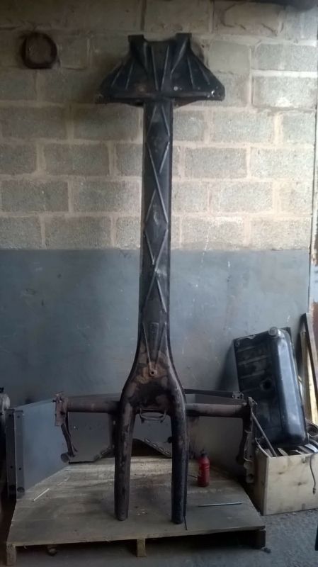

    It all started with a 1968 beetle.....

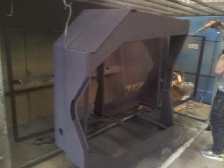

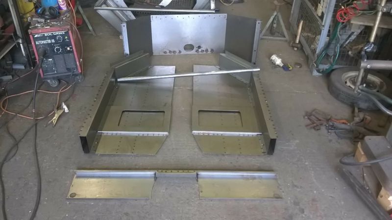

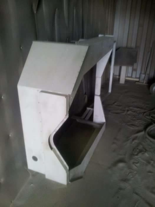

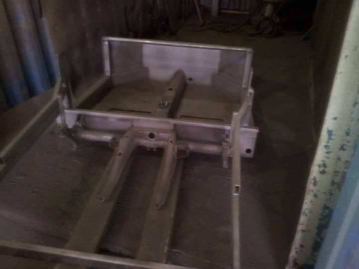

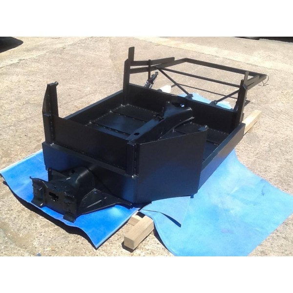

    Speedster Clinic do the following:
    New CNC folded and laser cut floor pans
    CAD designed and laser cut firewall
    CAD designed CNC folded sill sections
    Double box outer sill for rigidity
    Integral super heating system and screen de-misters
    Rear body mount and rear frame
    New Seat belt mounts
    Integral seat mounts
    Blasted, Powder coated in Zinc and then Satin Black
    From their own website - saves me explaining what they do:
    'We start with a beetle donor floor pan, remove the standard floors and replace the frame-head with a Tubular Adjustable Frame head .
    We then add all new floor sections, outer sub chassis and fixed one-piece CAD designed bulkhead, this is then welded into an all new box section outer chassis added to this are laser cut CNC bent sill sections that make for a super stiff chassis. Our completed chassis includes, seat belt mounts, Speedster Clinic super heating, and integral seat mounts.
    There are many advantages to the Speedster Clinic chassis, this is down to the design and construction, our super stuff chassis maximizes space this then caters for the tallest drivers in complete comfort.
    With the short wheelbase of a speedster (300mm shorter than standard Beetle) We build integral seat base mounts that are moved back and more centrally mounted compared to those on a traditional shortened VW chassis, this, combined with our all new floors and outer sills make for much stiffer chassis. Our increased cabin size and safer stronger chassis make for a more enhanced driving experience.'
    The chassis and body are all bonded together and I bought it like that.

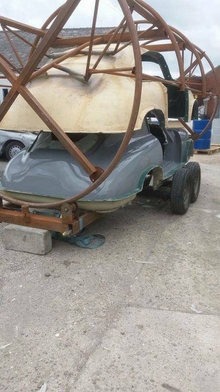

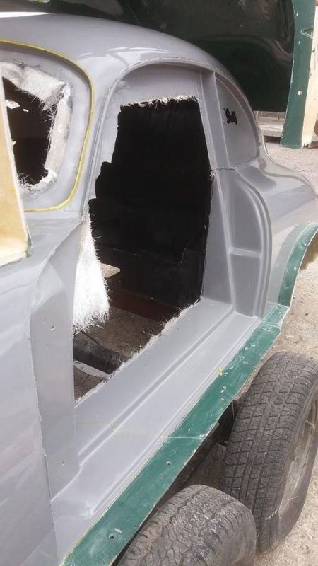

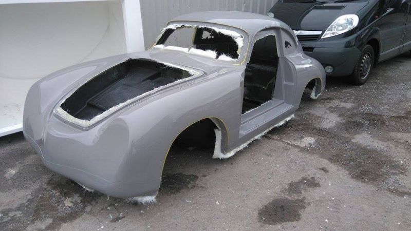

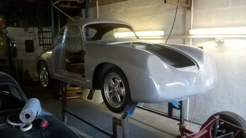

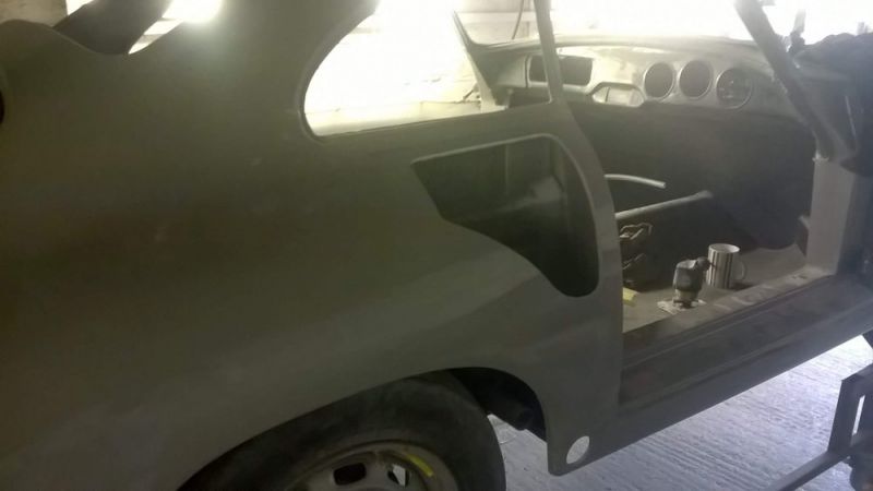

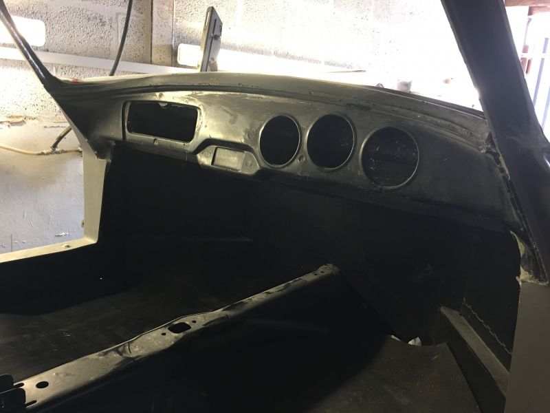

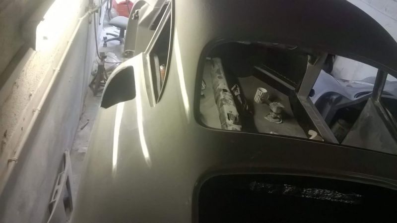

    Body being made:

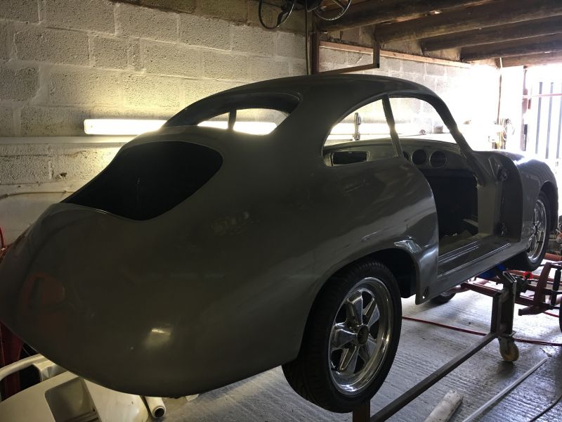

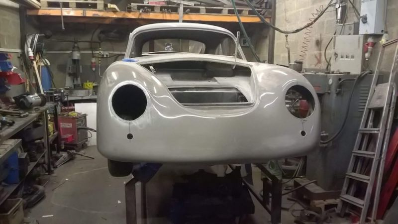

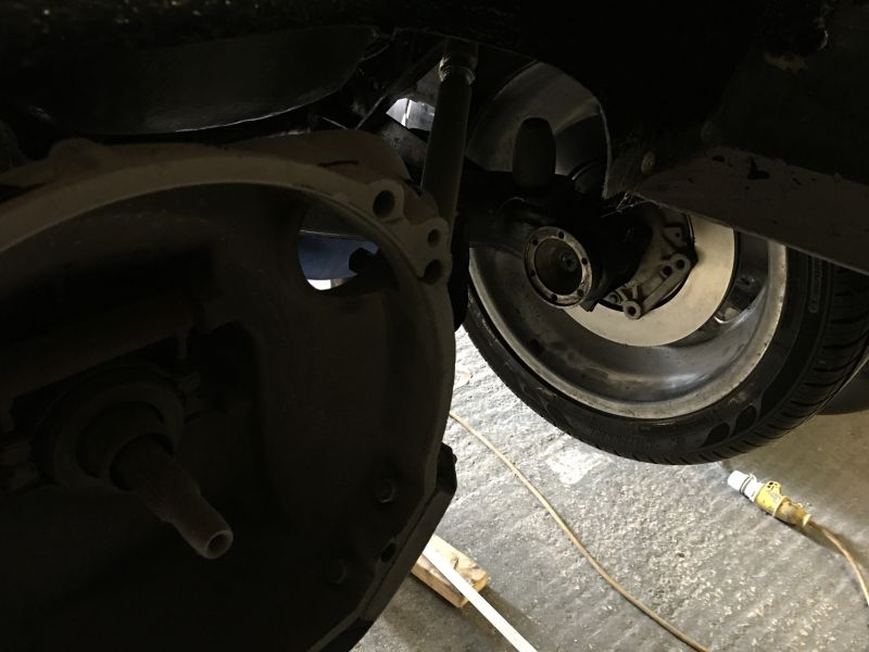

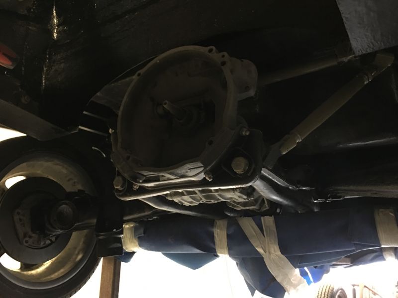

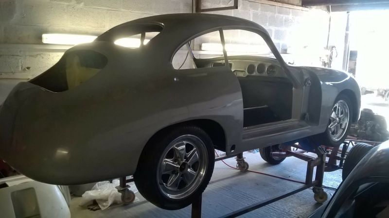

    Body and chassis with suspension etc going on.... (the wheels are not mine and are temporary)

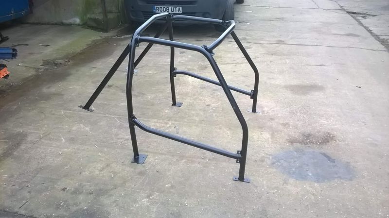

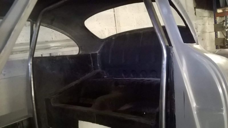

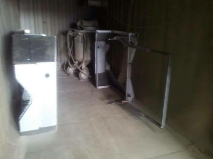

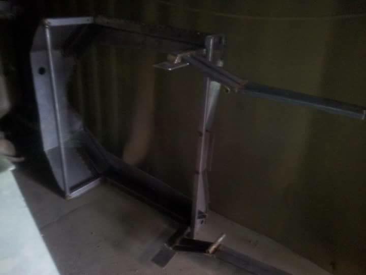

    Roll cage hand made by Gary at Speedster Clinic and all powder coated.....

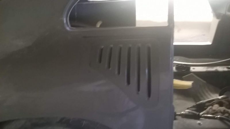

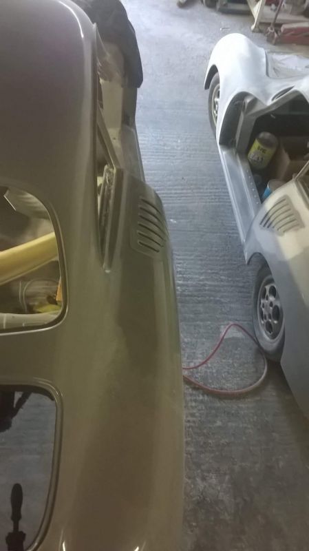

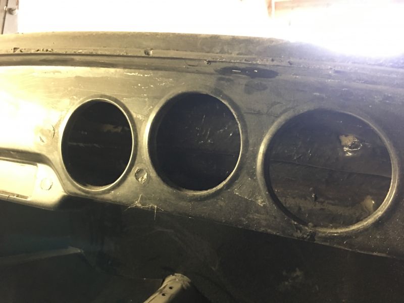

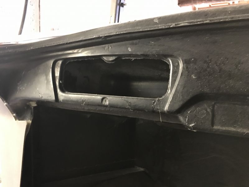

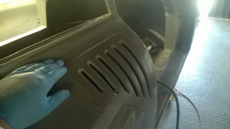

    I love the cars built by Rod Emory and particularly the black special that they did. I wanted the engine air vents down the side. Speedster Clinic produce a version of these but they are fixed in and I wanted them hinged with locks as per the Emory car so these have been added (the holes cut and offered up but not fully fitted yet as we need to locate some decent hinges.
    The car on the right has the fibreglassed in version.
