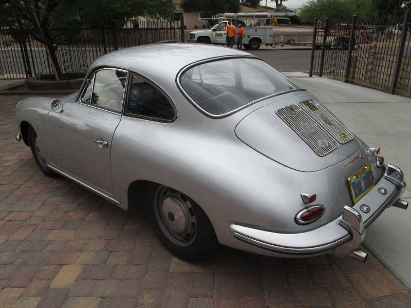

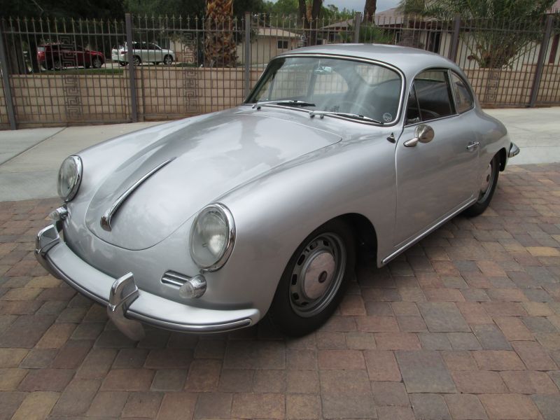

    A nice solid driver level C coupe.

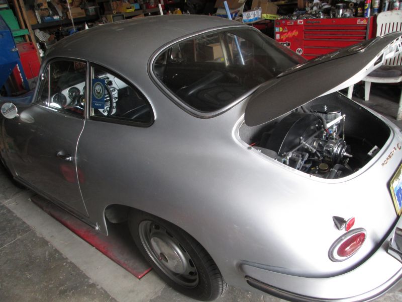

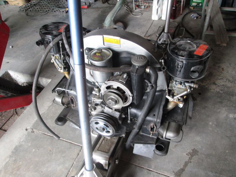

    Original engine will go into storage.

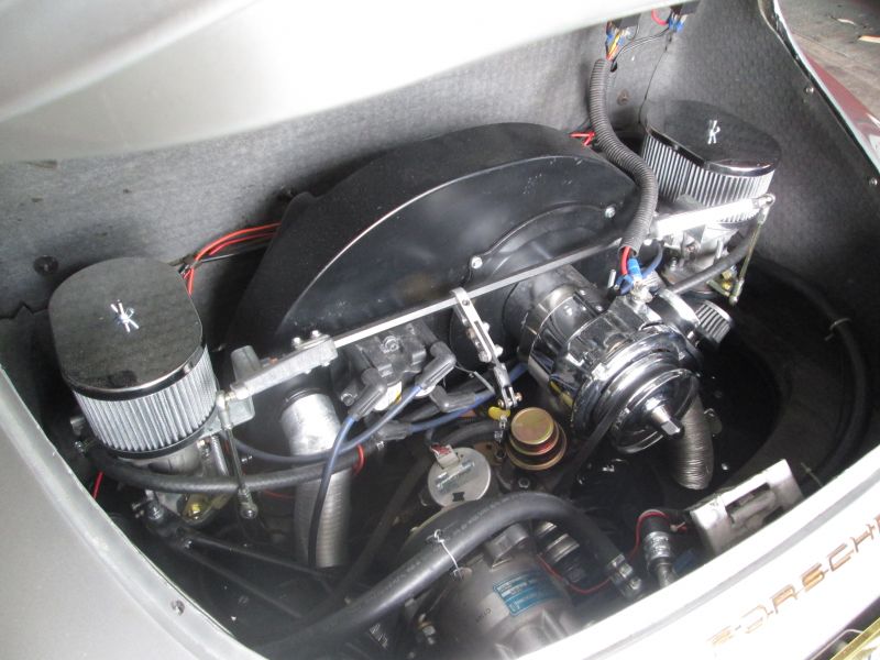

    2180cc with 40 webers, electronic ignition, and hydraulic lifters. I think I heard they were Subaru lifters?
    The aim was trouble free performance with all the tricks offered in the VW world. The motor sure was smooth and quite with no metallic sounds like the early VW and Porsche engines.

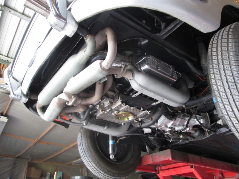

    Custom quiet exhaust system was fabricated and exits out the bumperets as they should. Linkage was also fabricated so the VW heat exchangers will work with the stock 356 system.
