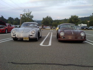

                Here is mine compared to a stock height car. Yes the spindles do widen the track by about 5/8" on each side. On mine with dropped spindles & 165 stock height tires they did rub the fender lip while turning. I run 175/60 tires on stock 4.5" wheels with no issues.

                  In this picture the car wears 135 Firestone F560 tires. Good for looks, bad for rides.
                  The clearance tow hook / ground is about 2 1/2 inches, I am currently thinking about removing the original tow hook to gain an extra half inch.
                  As this is Onassis 356 Restorations project test car, we are currently working on a set of new designed (to our specs) wheels based on the showed Enkei wide 5 wheels. We will raise the ET to get the wheels more tucked into the fender.
                  Right now, plans are for a tire change also. We will make some tests with AVON CR6ZZ or CR28 (road legal semi slick) in small 175 size. We will keep you updated on the progress for sure!
