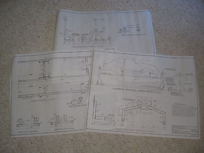

    Hi,

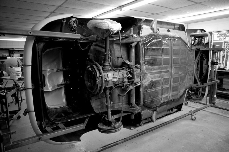

    I'm looking for plans to build this type of rotisserie. If anyone has an idea of where/how can i get these plans, it will be greatly appreciated.
    I already asked on the registry, but no luck so far.
    I have about a week to decide on what to do.
    I know that the emory "rack" plans are available, but i prefer this type, if i ever get to find the plans..

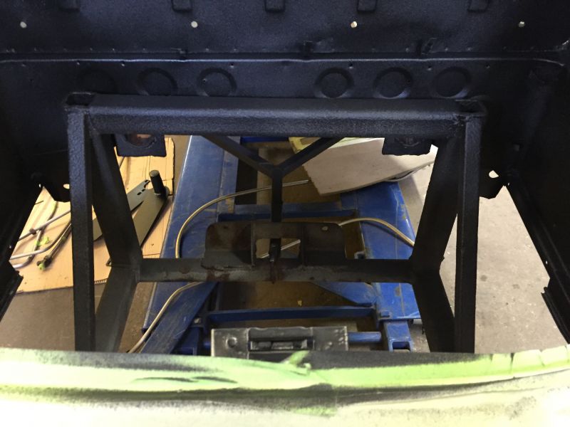

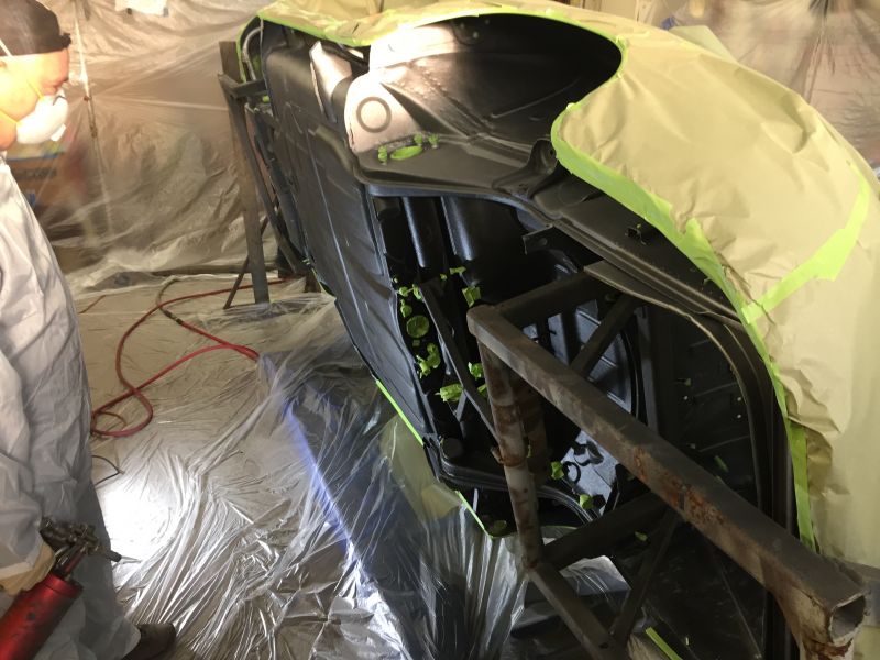

    These were taken Friday. A C-2 having the texture coating applied.

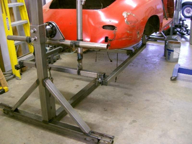

    Maybe I can help, maybe not. I can try. I have made four (three remain) rotisseries for both 356s and 900-series shells, all at least 25 years ago. Some more recently updated. Simple, no drawings (no Internet) and no appropriate fixtures I could buy. 'Scrap' metal found from other projects and some ideas, so each one has been slightly different.
    I did post about this several times on the Registry when I was a member. Years ago. It may still be there on their forum or it may have been eliminated, as I am a 'persona non-grata' over there now. There may be something here already on Justin's friendly and informative (not to mention; entertaining) site.
    I knew from numerous welding burns and a sore back that I needed a better way to access all parts of an old Porsche. Stripping, blasting, welding, even assembly...all are easier with a rotisserie.
    Are you doing one car? If so, a board or two and big C-clamps are easy to keep the shell at any angle. I can send better pictures of the most important (to me, at least) mounting points and the ends that attach to the stands. I have incorporated no elevation devise, no rotational brake. I made sketches and used a tape measure, a chop saw and a MIG.... and just made what I wanted. Does what I want....2 or more times during a restoration. Coupes are easy, open 356s need careful bracing.
    I can give measurements for the basic mounting units. My computer skills cannot match the drawing you posted. I could quick sketch the parts and photo that and post, if that would help. I like to do this 'stuff' (a degree in Industrial Design helps) and I like to help others do what I have liked doing for 45 years....but I have too many 356s and an early 911S to get done before I retire (or at least slow down), so my time now is limited.
    So, please post more about your own project and I (and others, I'm sure) will do what we can to encourage you along!

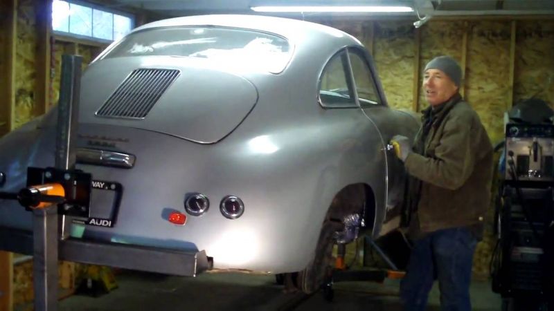

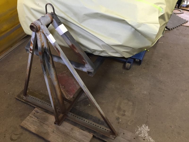

      Your last photo is of Gordon White. He built his from two engine work stands probably from harbor Freight.
          Yes, i know, but thanks anyway for the info.
          I already sent him an email a couple of days ago through the registry, and hopefully I'll get a reply rather sooner than later.

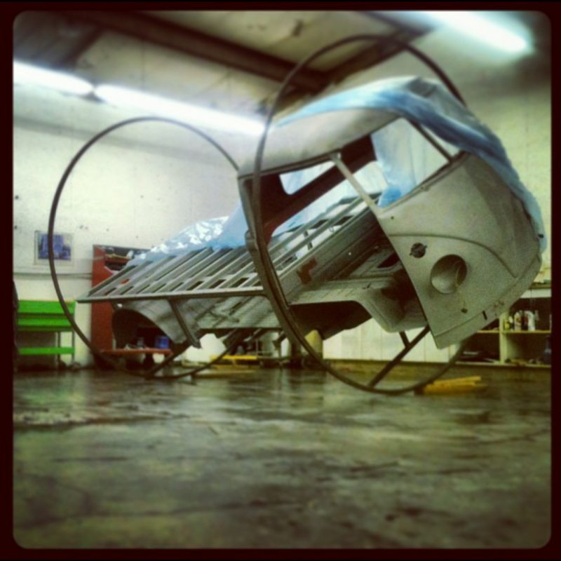

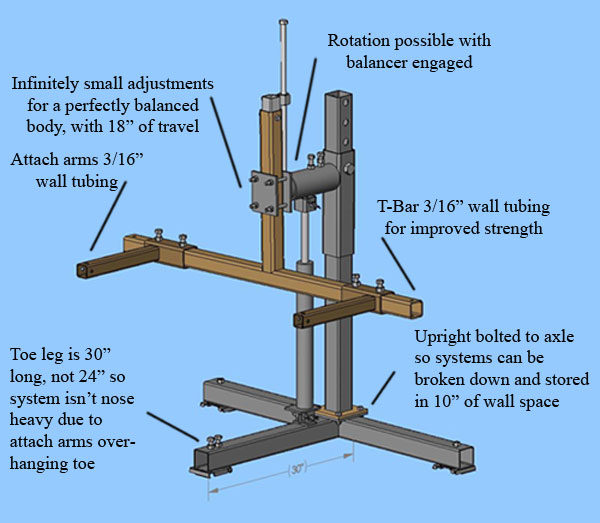

            Here is an idea for someone who wants to build a rotisserie. I got mine from a friend when he closed his shop. Not sure what the hoops came from but on my way home from work I spotted this...

              After weighting in my options, i decided to go for the emory (octagon) type. I was unable to get the plans for the "engine stand" type, and Gordon came back with only two extra pictures and no real details on his.
              Also, i spoke to a guy that has used that type of rotisseries in the past, and he tells me that he prefers the octagon one since takes less space, plus the fact that it is way easier to build.
              My builder already ordered the tubing (materials will be around $260, plus the casters).
              Once i have it done, i'll post more details, for future reference.
              Thanks again.
              Manuel Tolentino

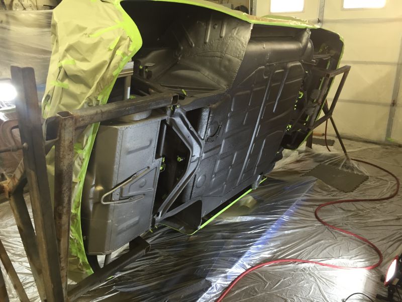

                This is as far as I've gotten:

                Some square tubing, some pipe, some old street sign perf, some cutting and grinding...and a tape measure once the center of gravity guess was made....and it worked on an average for both coupe and Cabriolet/Speedster/Roadster..... many 100's of uses so far .....but no, don't take an old man's word for it.....ah, impetuous youth (as I used to be)
                Seriously, no matter what the design is, it matters most to what it is mounted on the 356. I used the strongest part of the suspension.
                The tubing would be best considered as needing an engineering factor of 3....3 times the minimum for a weight of about 1000 lbs, IF you are leaving anything on the shell like the trans and suspension.

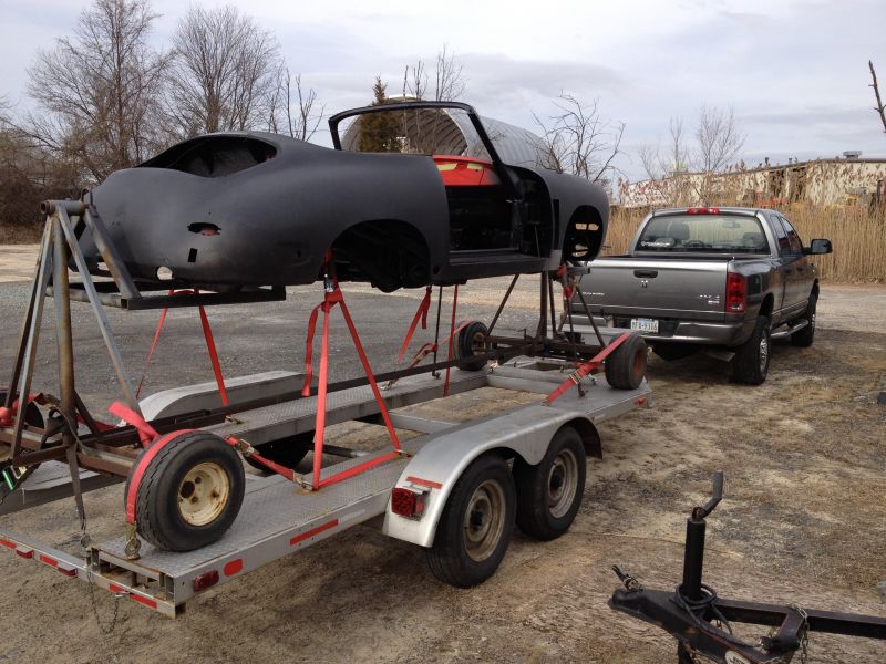

                  With a wheeled support contraption, the car can travel to the blaster:

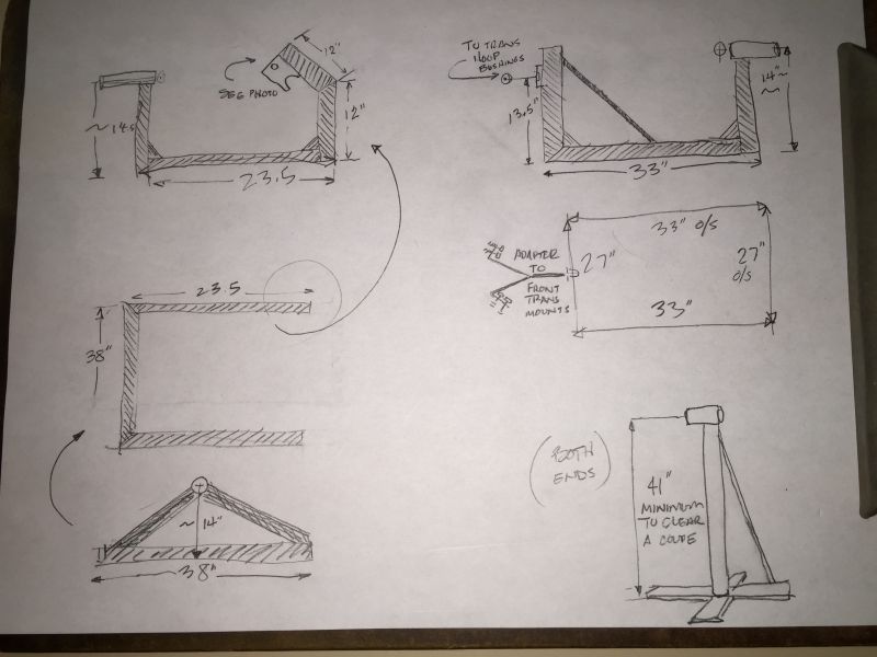

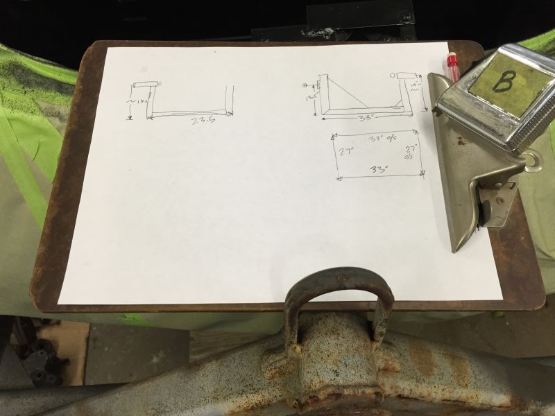

                        Here's the drawing with as much time as I can allow for drawing-

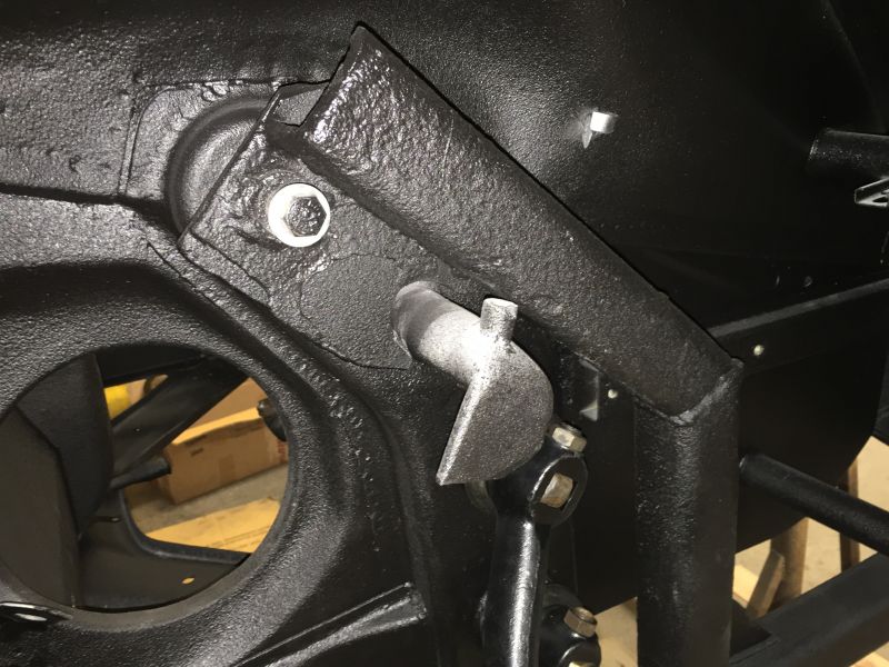

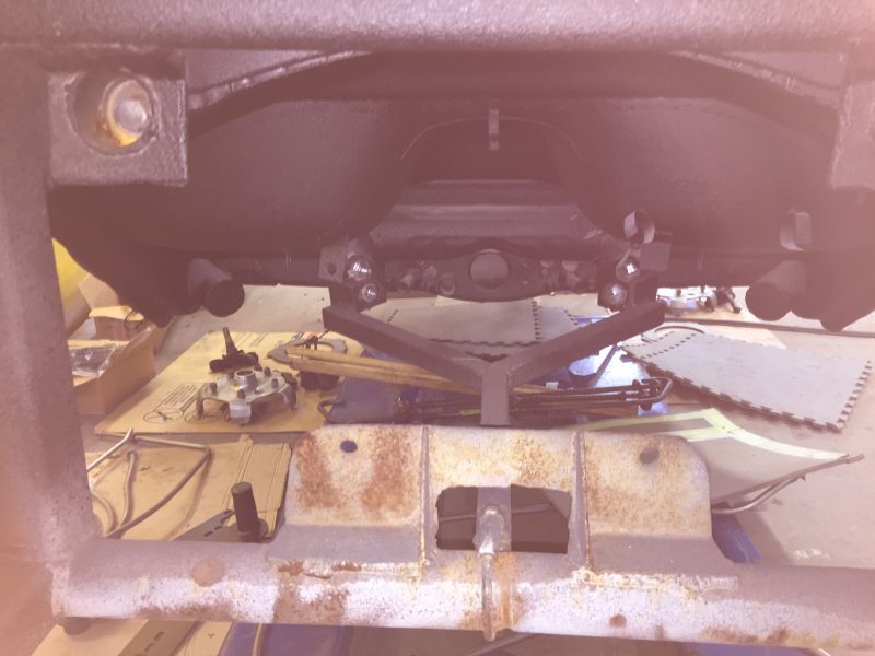

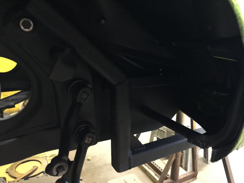

                        Here are some shots of the things you'd need to 'figure out yourself' with cardboard templates, metal plates and a cutting torch, grinder, etc. That is, unless you have access to an EDM or at least a CNC mill.
                        You will please note that this version allowed for a (drained) transaxle to be used.(you have to put a baggy over the vent 'mushroom' with a rubber band as well) That was back when the cars were just as bad but we left the suspension on to fix a floor, etc.
                        You can see the trans 'hoop' mounts and the trans substitute brace going forward to the mounting ears on the torsion bar tube. Most everything is accessible with this and the front just hooking over the bump-stop arm and fastened to the upper shock mount.
                        Just remember that the center rotation pins must be equally spaced horizontally
                        With this center of gravity ("C/G") a Coupe is a very easy rotation but any open 356 takes more muscle. At any angle, a big C clamp and a 2x4 will hold the car steady. Upside down and horizontal, 2 boards and 2 clamps are recommended.
                        The device pictured was chosen as not my best version, but my strongest. It's supporting a 356 Carrera 2, a fairly valuable model. It must not fall or collapse and the boards under the end stands are for clearance of the mid-rise lift it is going on today.
                        I sincerely hope this helps. If there is a decision to do something like what I did (long ago and just a 'seat of the pants' design) and you need more input, just post here or email me at [email protected]

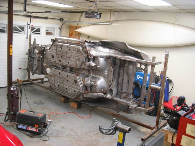

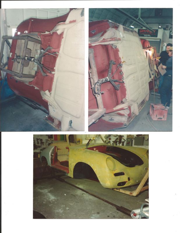

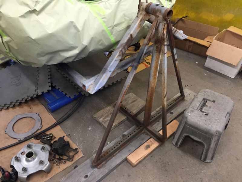

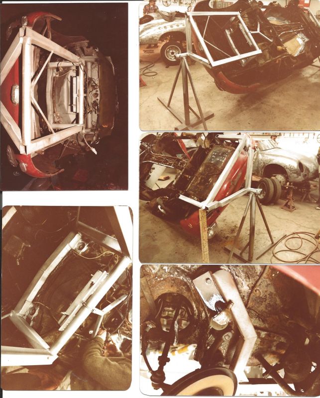

                          I found more shots from the '70s, '80s and '90s.
                          Ironically, the 356s are mainly C-2 Coupes and my C-2 Cabriolet. One may be a Speedster.
                          There is more detail of the mounting adapters and stands on these
                            That's just awesome, I'll forward this to my guy, to see if we still have chance to go this way.
                            Thank you again Bruce (dropping the "Mr." from now on)
                            Tony
                            Manuel Tolentino

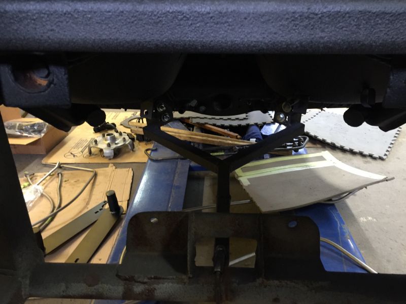

                              Sorry to chime in late.....I just saw this thread.

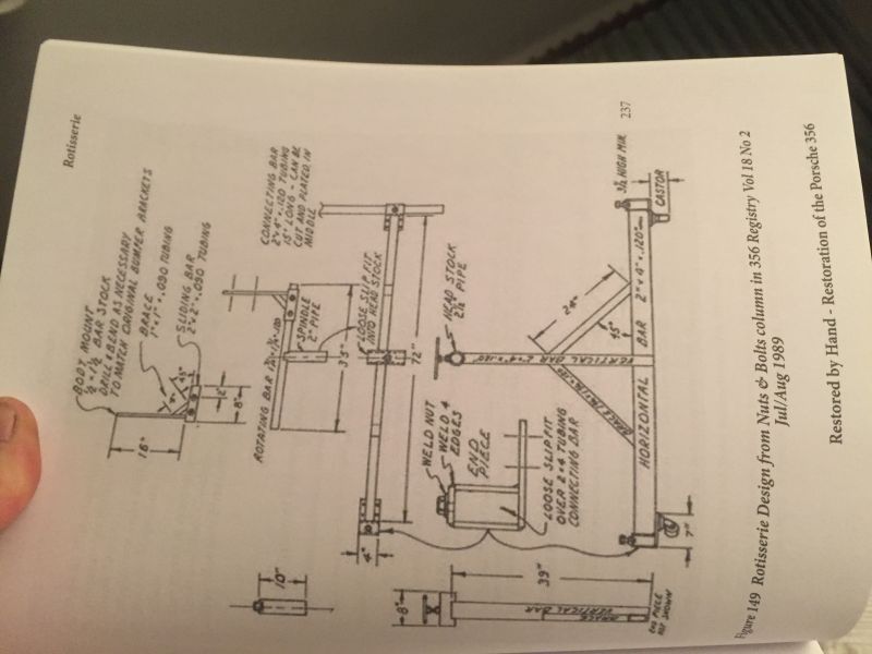

                              Ron Roland "Restored by Hand" has plans for the engine type stand on page 237. It actually references a 356 Registry issue, which I probably have.
                              That being said, I like the octagon rack for one reason; If built well and "square" and used on a level floor it checks that the chassis is not tweaked. Also during structural repairs it maintains a non-tweaked posture. A trammel gage is also great to check that the chassis is okay by checking factory dimensions or side by side comparisons.
                              Just my two cents and I haven't used a engine stand style either.
