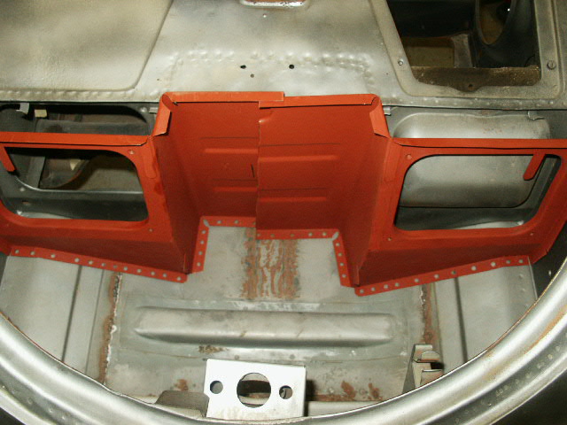

    While I do like the simonsen's rocker panels I do have a word of warning about their forward battery replacement wall. Its stamped a touch too tall. The tapered lower flanged lip hung way too low and was much too pronounced under the nose apron. Its stamped so deep that it required the removal of the cross brace on the battery floor to get it to seat down flush. This was before I figured out what the problem was.
    I was on the DDK site some time back and ran across this project photo and the forward closing wall immediately jumped out at me. That's an over exaggeration hanging way too low under the nose. I'd bet a simonsen's wall.

    Original. Hangs a little but not that pronounced.

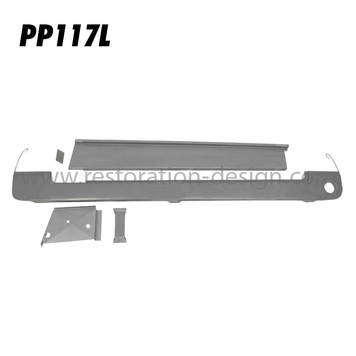

          NEW A/B/C rockers

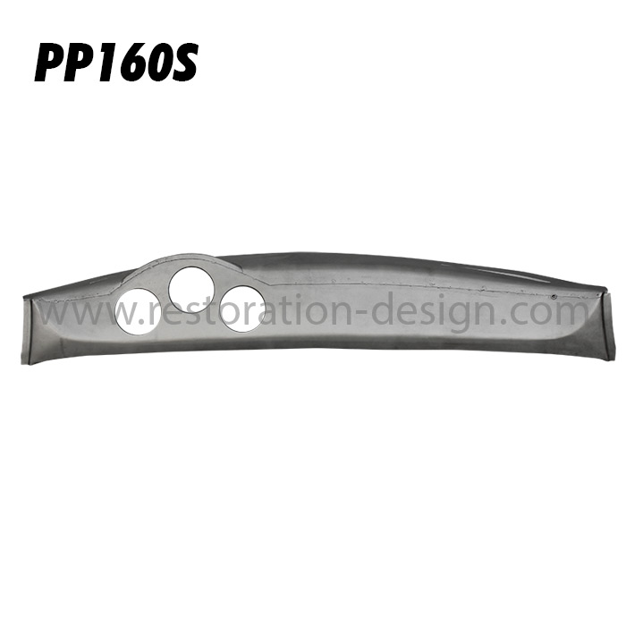

          Speedster Dash

              Hello Joris,
              We have compared all of the rockers that are available from the different suppliers. One is too long, the other is too short. Edges do not have the correct contours, incorrect depressions, etc.
              We all know that these cars were hand built, so some variance should be accounted for. We are selling our rockers UN-assembled. This will allow the end user to fit the rockers to their car. This will allow for better fit and finish.
              Another problem that the other supplier rockers have is when that little piece of wire is installed at either end of the rocker, they do not have any rust preventative inside that seam. It wont take long for moisture/rust to take its place inside there. With RD rockers, they are galvaneal (rust preventative embedded into the steel)
              Cheers, Alex

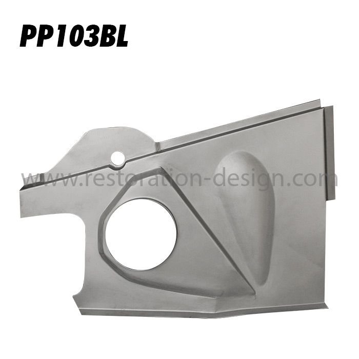

                  Welcome back! Are you guys offering any Pre-a chassis frame run sections? Like front suspension back to A pillar? The speedster dash looks fantastic!
                    Hi Justin. Thanks.
                    Are you referring to this part?

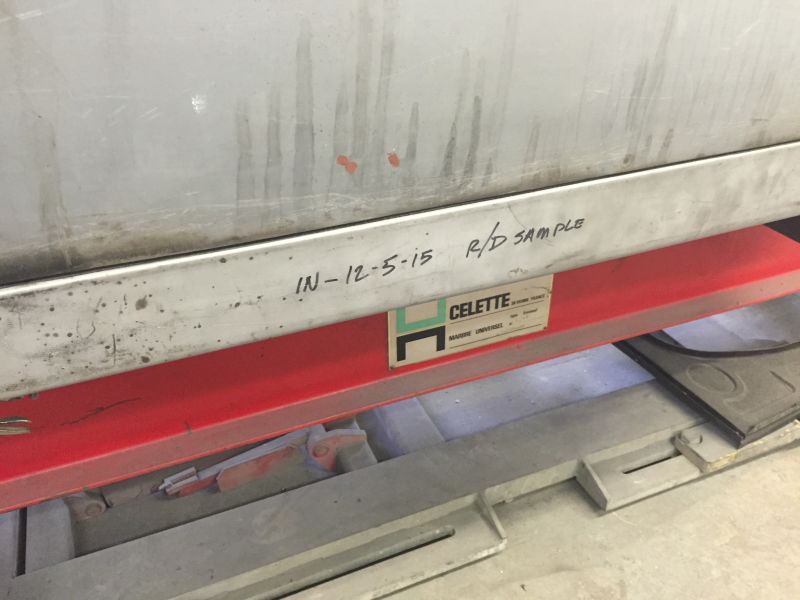

                      Sent to me by Mike at Restoration Design as a pair for proofing. They were sent at no charge but I offered to pay if they stayed on a customer's car and I could bill them to that project. In this case, they are staying on a Carrera Speedster.
                      BTW, I take the wire out of the ends (wiring that also comes on NOS rockers) and re-do the wire from the rocker and over the arches to the approximate ending forward or rearward. Also, we used to pride ourselves on eliminating the rocker overlap with the joining panels "to prevent the joint where rust first formed" but now just spot weld the overlap for "originality."
                      The only "problem" I have seen in the repro rockers (from various vendors) is an over-done "drain" detail(s) on the bottom curve-under. Easy enough to re-form that prior to installation, but it should not be obvious to a viewer looking from the side.

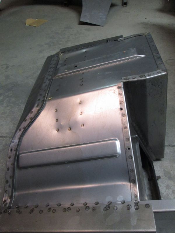

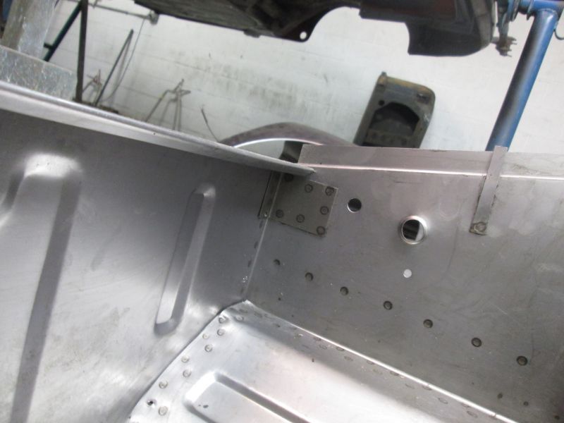

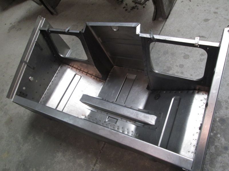

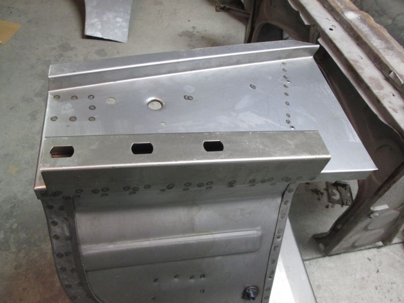

                        New battery box assembly by Trevor Marshall.
                        A really nice assembly ordered for a T2 with T2 details.
                        Embossments and spot weld details are fantastic.

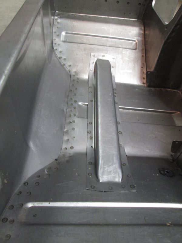

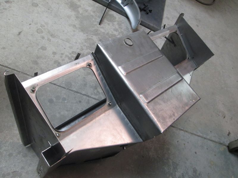

                        Reinforcement tab for the over rider tube strut mount included.
                        Short T2 bracket mounts.

                        T2 style twin removable access covers.

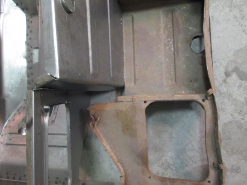

                        Only mistake is the battery recess wall is the narrower T1 style. Original T2 for comparison.
                        More details about this wall discrepancy can be found here:
                        http://www.abcgt.com/forum/4-356-Forum/5072-Evolution-of-the-356A-T1--T2-How-they-differ.html?limit=6&start=102
                          Yes, 18G
                            Moin moin Justin,
                            Did you talk to Trevor about the litle misfit?
                            It could certainly fit one 356 thats between the two types..... Porsche just wanted the production to keep running....even with an older or Newer part fitted to a 356 that needed to be done asap
                            But it looks really nice workmanship done on it.

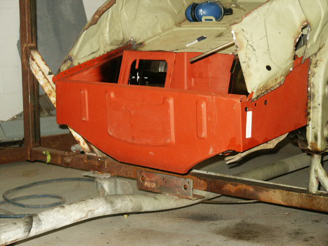

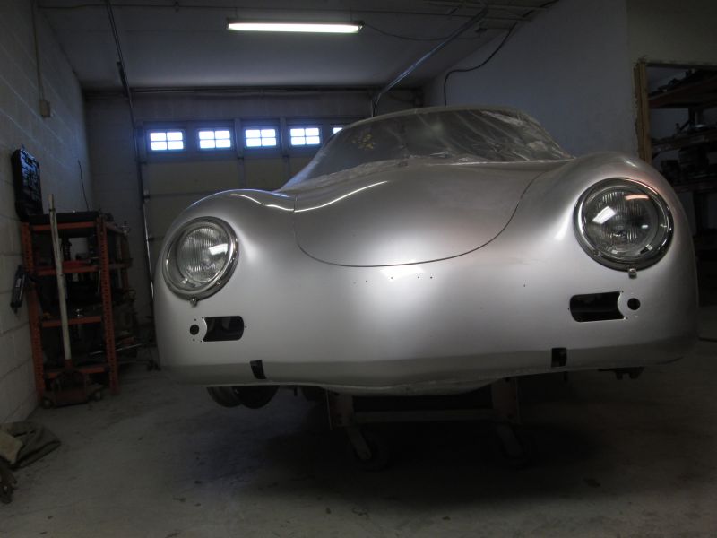

                              I started this topic and never really followed up on it. Shame on me. Anyway, Jon is getting ready to start on my car and we are putting together a list of panels I will be needing.
                              The early nose panels are a bit different, there was an interesting discussion on these on the registry recently. I looks like RD is working on a new nose stamped out of one panel with the correct details (chin and horn grill location) as such we will be trying this panel.
                              Battery box is still a question if we can save most of it (preferred) or need to replace the complete unit. If we replace just the bottom the new panels from Simonsen looks very nice for a front wall I am unsure, you guys have any suggestions?
                              Rockers, I have some NOS ones we might use. Otherwise the new ones from RD look nice and I believe that Bruce and/or Justin have had good experience with these.
                              Biggest issue right now is the cowl, mine is severely damaged. Have seen NOS ones over the years but never piked one up. This will be a toss between finding a new pieces or a donor piece, or fabricating a new area
