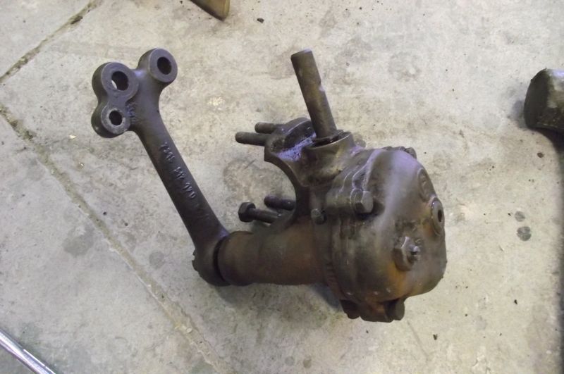

    Makes perfect sense Roy. I can see how the Peg carrier would interfere with the filler hole in that position. Like it when the solution is simple.
    There is one oil drain in these boxes, I know that one(maybe both)of the forward tapped holes for the mount studs does breach the boxes interior. So if you could back one of them out it could be your oil drain.
      I think the manual calls for a specific amount of oil, which as I recall amounts to 1 cup. Will have to check my notes. Anyway, don't know how much you added, but possibly it was being overfilled before. Just a guess. Hope it stays leak free for you Roy.

          Justin, interesting observation of the open stud hole. I am not aware of this, and have had many instances of various studs being pulled out on ZF due to bound nuts, and no fluid draining. Maybe the right one has yet to give. Are you sure is not a T0 or T1 thing with the VW box?
            Come to think of it I might have that feature confused with a Type 1 box Jack.
