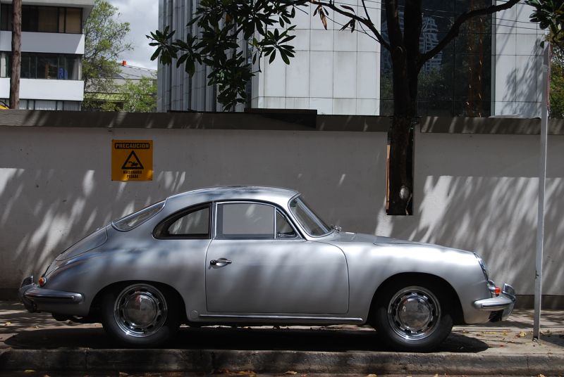

    Hey Everyone, so the reason I'm posting is because I'm looking for some input on a project I want to start. I recently got a 160K km 1962 356 B T6 S90 as a graduation present from my dad. He's the second owner and has had the car since 1981, so he knows it very well. We've done a few things but we also own a 56 Speedster and recently bought a 70 911E that have taken all of our attention lately. Its the S90's turn.
    We've done the suspension and brakes and replaced the matching numbers engine (we do have it though) with an industrial engine with 86 mm bore, AA cylinders and forged JE Pistons. Its also got new Webers and manifolds. My dad says its never been as fast, reliable and torquey.
    I'm looking into some advice as in where to start fixing the car, little by little. I want it to be a drivable and reliable car I can use frequently. I also want to try and do most of the work myself, even though for complicated stuff I've got help from a great mechanic that led the overhauling of our 911 and Speedster in the last 5 years. I'll try and give you a good idea on the car's current state.

    Here's a photo:

          Thank you for joining us and Welcome along! That was a really nice graduation present. Congratulations, your father must be very proud of you! From the photo it looks like a very nice solid driver. Always garaged kept? As for the modifications your thinking of they all sound reasonable and also most importantly reversible. As your budget is tight at the moment I think I'd concentrate on the wheel and tire combo that's going to make you happy and the stance. These alone are what really makes or breaks a car's presentation IMHO. As for the rest of mods you just have to sift through and determine what looks and feels right to you. Check out this thread to help you along with your vision: http://www.abcgt.com/forum/6-Hot-Rod--Modified-356/11926-Hotrodmodifiedcustomoutlawtricked-out-356s.html
