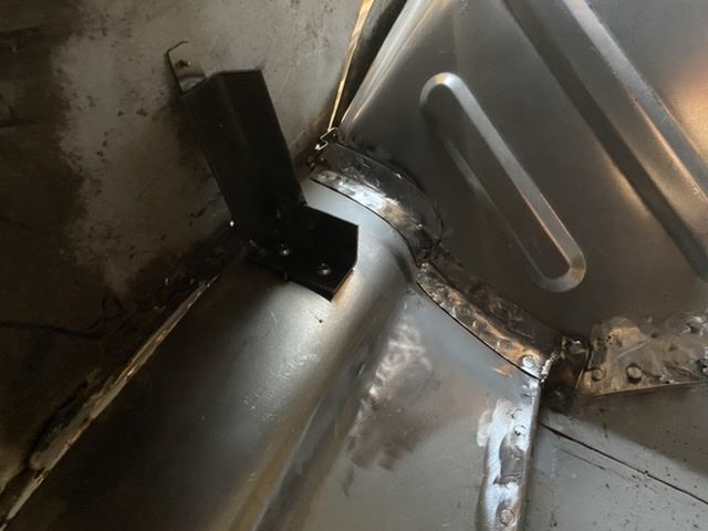

      • Started to put a number of brackets and supports in place to pin down the fender before I cut it away from the nose piece. I Want to make sure when I cut off the nose I can position the fender in the correct position while I merry it up to the nose and build up the side panels near the door. I recall reading a post on here that when you cut the nose off it can flop around and be a pain to put in position. I welded a bar from the rotisserie to Cleoco the top of the fender (suspend it down the road) and built a number of brackets underneath Click image for larger version

ID:	108603 to pin the edges along the hood. I will need to cut along here to weld in a new rain gutter along the sides in the future.

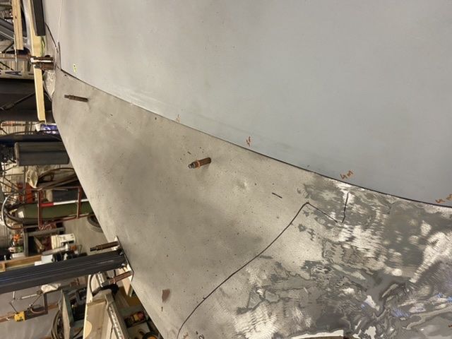

          • So - I'm now at the point - with the side fenders in a fixed position - to consider cutting off the old front nose. The green tape shows a rough proposed cut line - with lots of meat left to overlap the new nose so over time I can sneak up for the best fit - likely will be trim the new cut line a number of times in the coming weeks. Just need to get up the courage to actually make the cut of this major piece of the original car. Just still a chicken at the moment. Im sure I will find other jobs and excuses to hold off longer.
