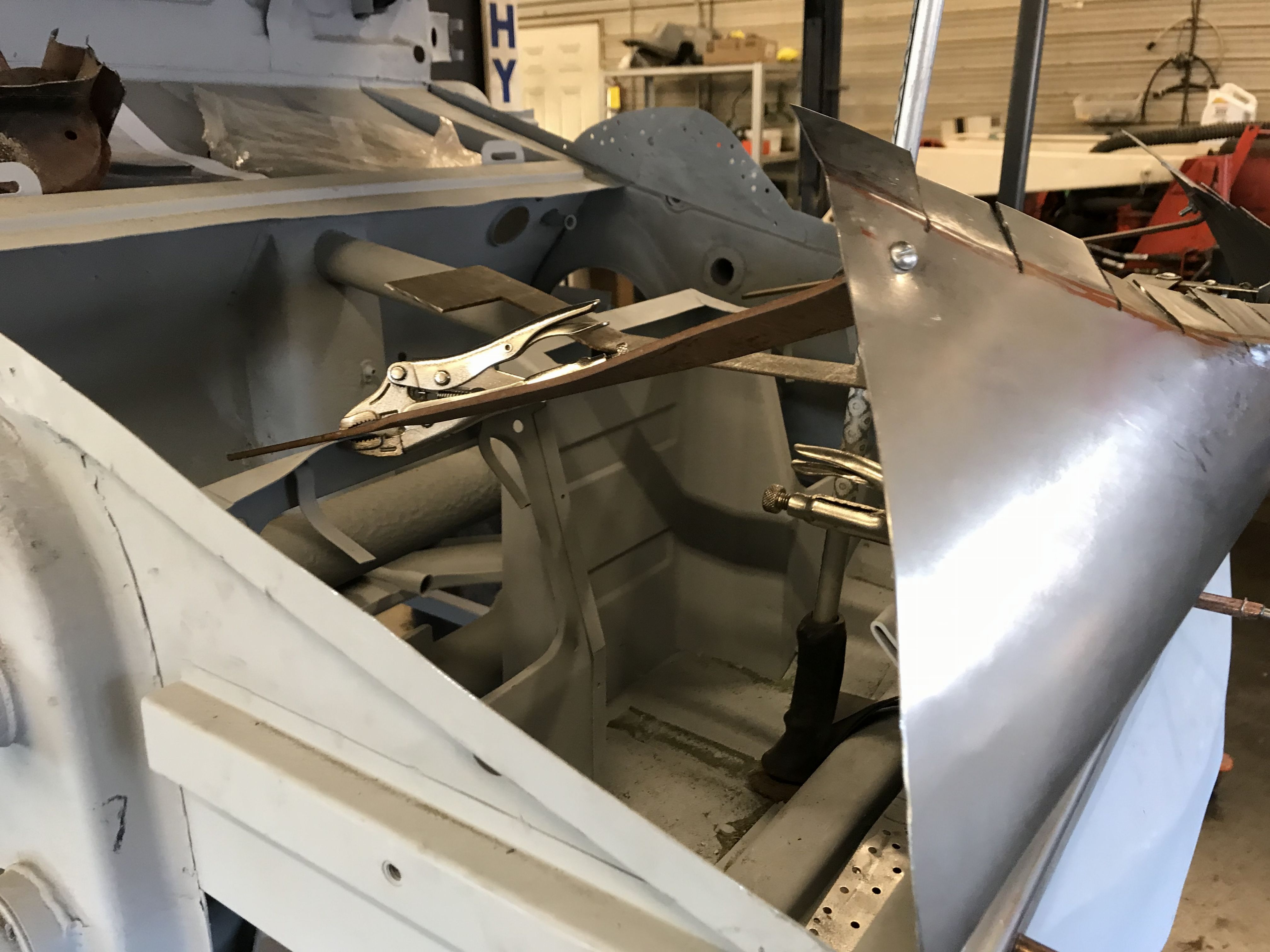

ID:	104690 Still slowly massaging the inner panels. Get one shaped then the one that shakes hands needs effort and back and forth. Getting closer.

        • Great work! Getting everything to fit is a lot of back and forth. Bend a little here, which changes things there. It can get frustrating, but once done it's going to look great. Having gone through the same thing, my motto is to try to save as much original metal as possible so as to keep the landmarks in place.
          • Ya. There is a lot of metal I now realize I could have saved and repaired and I would be much further ahead.

            • Looks like you're on the right track Scott. This is perfect example as to why these little cars can be so difficult to rebuild. Stay with it eventually you'll win.
              • Getting close enough to slip on nose for a trial fit. It was closer fit then I thought. Off it comes and back to some more dolly work to shape the curve of the inner panels

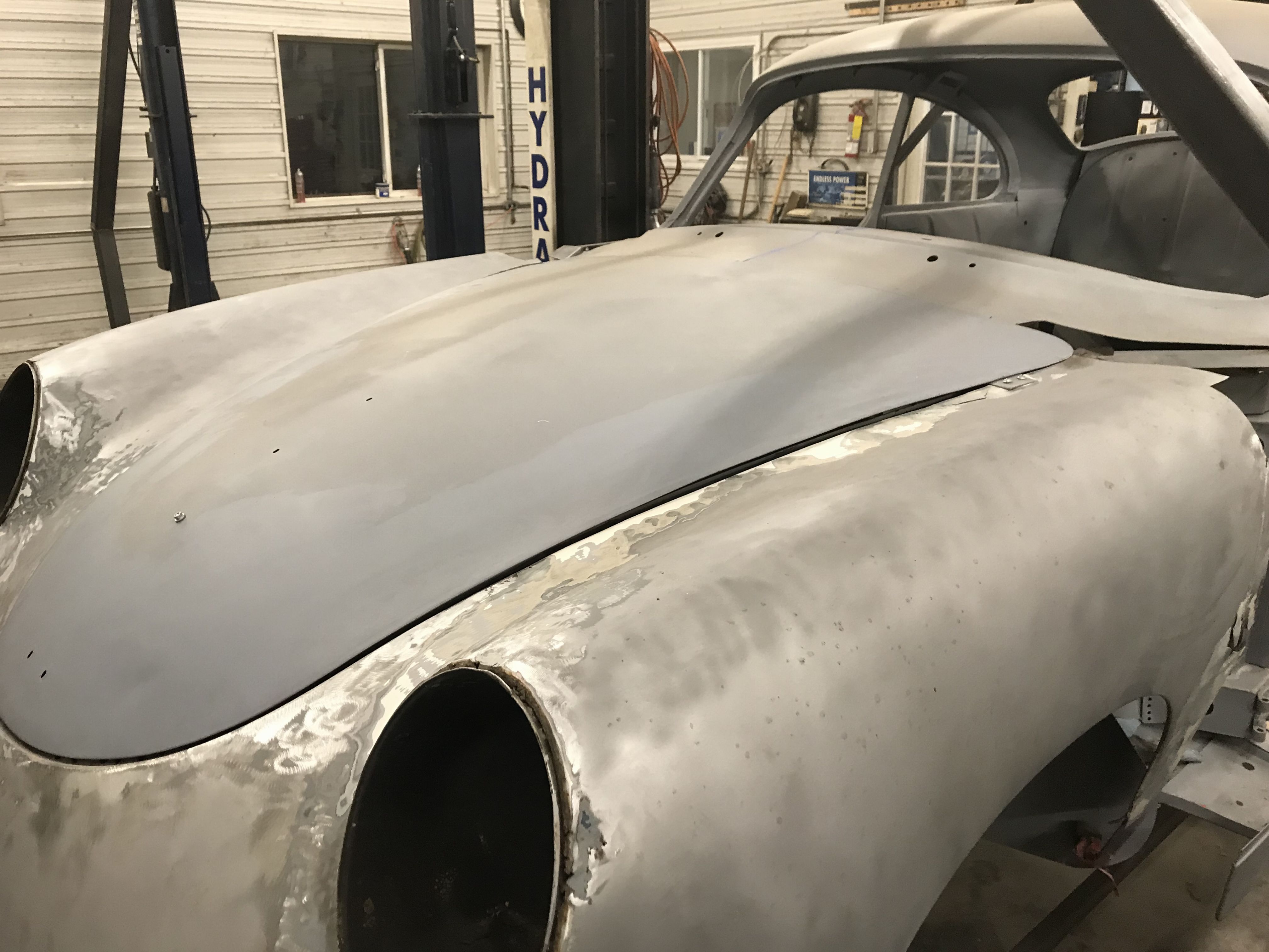

                • Finally got the inner panels all aligned with the hood.

ID:	105611 This has been a surprisingly difficult effort - getting all three pieces to shake hands; follow the correct line of the front clip; and for the weld ledge to have he right angle to follow the rain gutter.

                    Agree Scott, this is probably the most challenging mark to hit. Especially with new reproduction parts in the mix. All those flanges have to meet in just the right spot with a latched hood under the preload of a seal. Not for the faint of heart but you seem to be well on your way.
