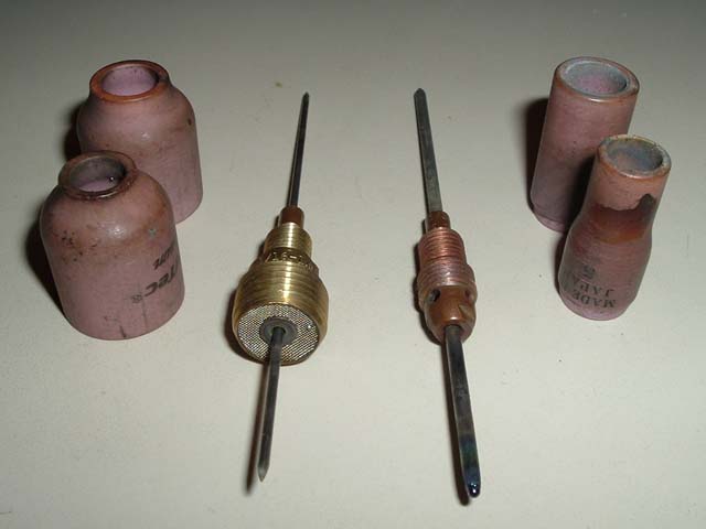

      Mic,
      I found using a "lens" collet assembly gives a better shield to the weld area than the plain collet assembly. You can also turn your gas flow down some and still get complete coverage. The only drawback is the larger ceramic cup needed. Also they won't work with AC for aluminum as the screen burns up.
      "lens" on left. Plain collet on right.
