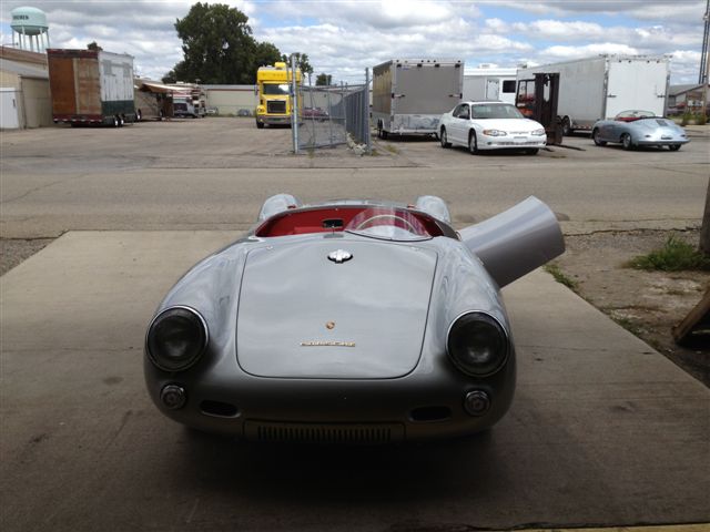

    I just finished building a 550 Spyder through Carey Hines -- an absolutely incredible craftsman with a shop in Bremen, IN (his company is the home of the BECK products). The car will be shipped to me in just a few days -- I can't wait to drive it.

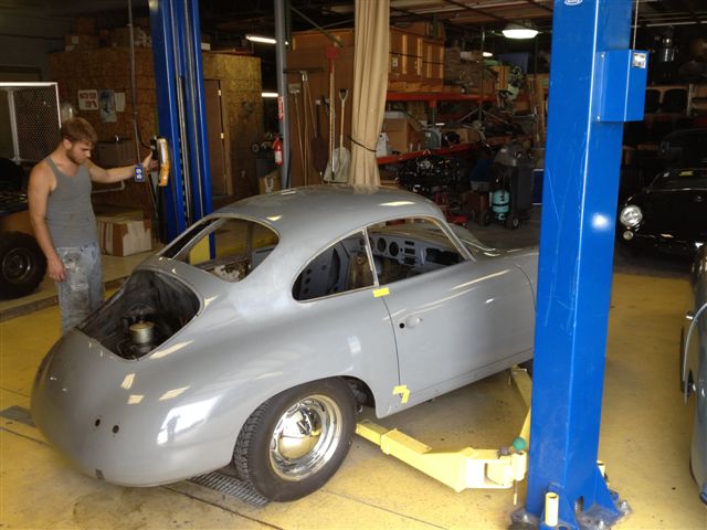

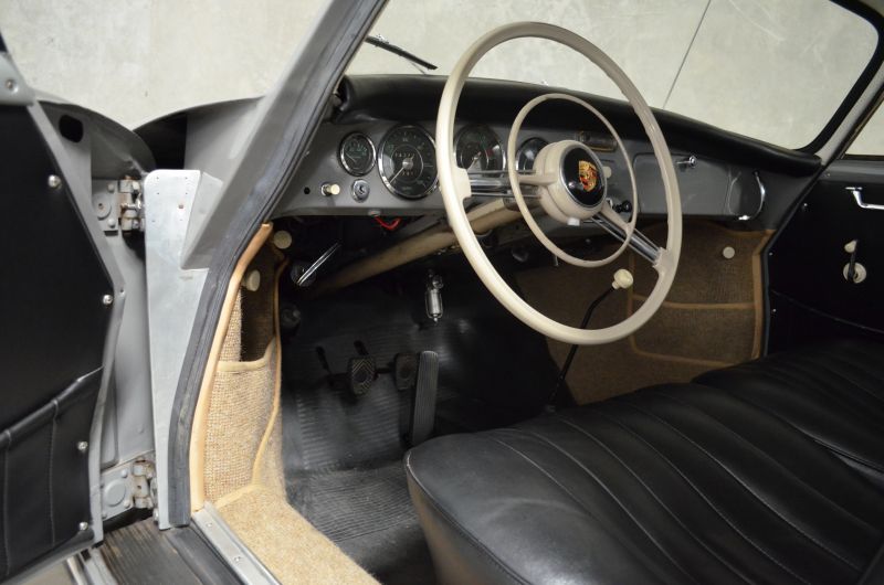

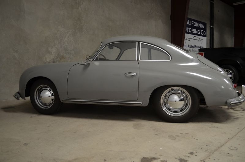

    Several months ago, I started thinking about a coupe -- and couldn't resist buying a 356A. Amazingly, I found a 1956 356 -- just around the corner from my parents' home in the hot, dry San Joaquin Valley (Central California). The car had always been garaged, and the man I purchased it from was the second owner -- he had owned it since 1972. It was incredibly intact, very drivable, and without any visible rust. I drove the car to work for a solid week and loved it! It isn't a matching numbers car however, and it has certainly been hit in the front (and that's where it might get interesting when we get it down to bare metal!).
    The car is now getting ready for a full bare metal restoration. I plan on turning it into a Carrera GT recreation -- pretty much just like Justin!

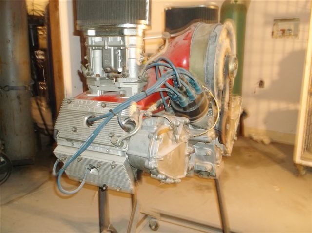

    911-4 motor built by Chuck Beck (pre-dates the POLO motors). The tooling for the dizzy was actually made by Chuck Beck, and sold to Dean! The motor I have from Chuck is good for 210 hp, and has just been rebuilt; it was his own personal engine that has been sitting in his garage, unused.

    What a great find that coupe was Anand! They don't come along this well preserved too often anymore. I understand that it was hit at some point but believe me you're miles ahead of the game dealing with some old bad collision repair than you are with serious chassis cancer. It really looks like a great find and a T1 to boot! Congratulations!

      Justin is correct to find an 'A' like the one you have is very rare and to find it so close by even rarer. It looks great and as its non matching your engine sounds really interesting. Slightly more BHP than mine

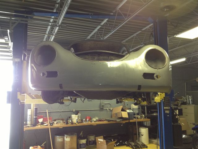

          My friend Carey has stripped my car completely -- and is getting it ready for Redi-strip.
          The good:
          Only one some area of rust near the rear window, but otherwise has almost no rust at all (that we can see yet, anyway!)

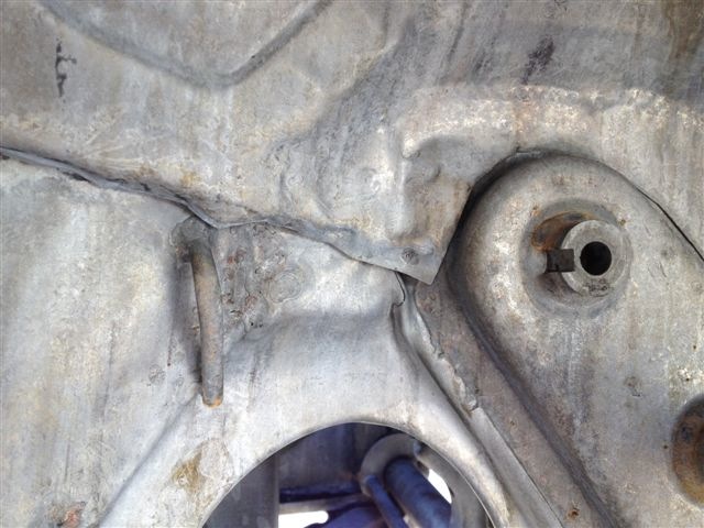

          The bad:

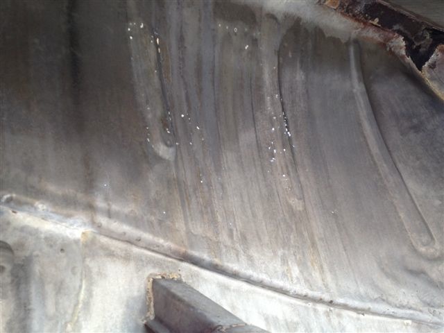

          The front end got crushed pretty badly, and as the picture shows, the inner trunk side panel was smashed pretty well (Carey says it looks like an accordion).
          The nose is a bit asymmetric too -- they forced the passenger side inward in order to make the fender tube support line up, but it is pushed inward from the wreck, so that pulls the whole fender inward.

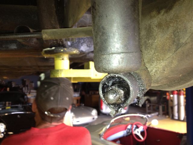

          The REALLY BAD:
          1. The lower shock mount is totally gone...thank goodness it stayed on for my 12 mile daily commute.

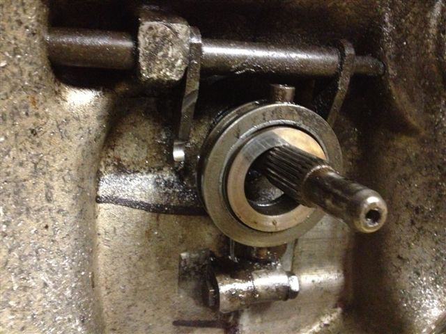

          1. My throwout bearing was installed with no clips (I drove this car on the freeway to the hospital for a week...YIKES).

          Regarding the Chuck Beck 911-4 -- someone posted about the motor on this site a while ago -- this is the very motor I purchased directly from Chuck with the help of Carey (it was in his own personal 550 Spyder replica)! The post suggests that the motor was from Dean, but in fact it pre-dates the Polo motors, from what Chuck tells me.
          http://porsche356abcgt.com/forum/6-Hot-Rod--Modified-356/1845-The-Polopolus-4-cylinder-911-engine.html?limit=6&start=18
          I'm waiting for some photos of it (the motor is headed to Carey's shop where Chuck will install it and my independent rear suspension on his own!).

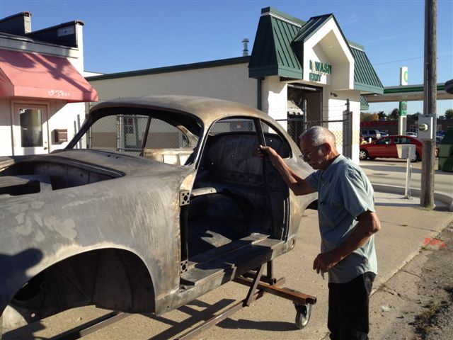

                    Status update: My car just got back from being Redi-Dipped in Indianapolis.
                    All of these 50+ year old cars have stories. The story of my car: BONDO. And lots of it.

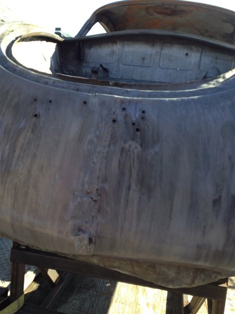

                    We knew early on that this car had been hit pretty hard in the front, and there was lots of lingering evidence of this.
                    The nose, for example, previously appeared pretty smooth dead center. As evidenced by the photos, there was about 1" thick of bondo underneath there. Whoever welded this car must have done so with their teeth -- the welds are, well, horrible

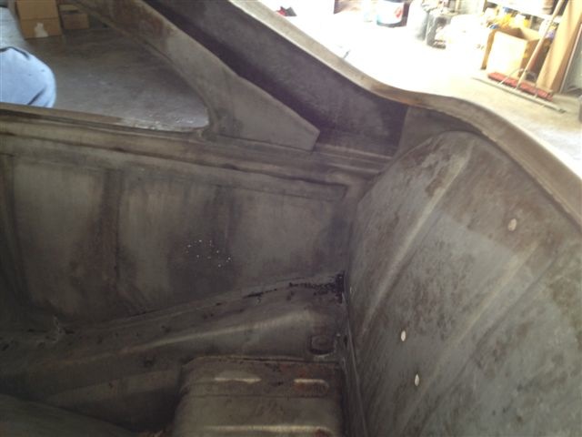

                    The rear inner trunk panels had been Bondo'ed too, visible holes in them:

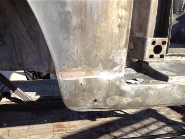

                    The rear longitudinals had Bondo too:

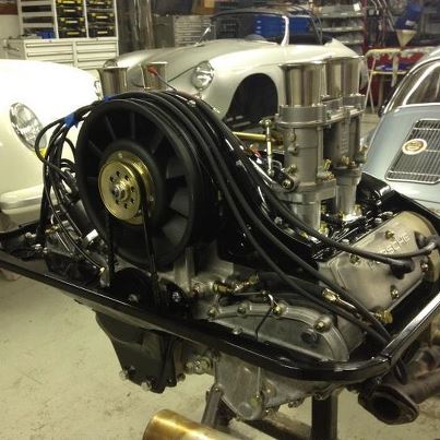

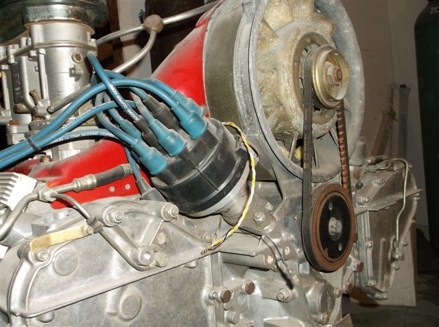

                      Chuck brought some pictures of the 911-4 he made (now mine!) -- it still needs a good clean, but he has rebuilt it with new seals, etc:
                      210hp
                      His distributor:
                        Cool stuff. I take it that's an aluminum case? What kind of shocks did the car have? They look original.
                          Looking good Anand what a cherry virtually rust free shell; you did well! A clean bare metal shell is such a nice place to start! Yeah it took a little hit to the right side and kinked behind the beam a bit. Probably pulled to the right as it went down the road afterward. That is a sweet motor! It looks like it hasn't been touched for 20 years and has a real patina about it. You say its been rebuilt? Like the custom valve covers too! Thanks for the update and looking forward to more! Justin

                            Yep -- the motor has been rebuilt -- but it does look dated from the outside! Might need to do a new set of valve covers for it...I love the ones Dean has done.
