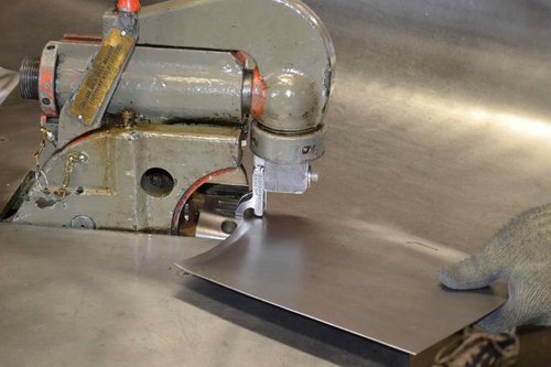

              Just catching up on this thread. Yes, Fay Butler has a machine to do this pretty fast. Here are some pics of Fay installing the wire on the fender he made as a demo, which I was able to put on Foam Car(details posted on thesamba). I did have to rework the wheel opening a little at the rear, as it did not match my T6 opening. I think the nos fender he used as a pattern was a T5 as it had no fuel filler opening.

                Phil, Thank you for posting this. A very interesting and vintage looking machine! Can you give us some details on how it works. I see that the profile of the arch is cut first and appears to run along that guide at the back of the throat there and the wire probably seat in that little saddle/acrhway? What is the proceedure with this? Does it roll a lip over the wire in one pass? Thanks! Justin
                  Very interesting Phil, no doubt about it 'wiring ' edges requires some nice tooling. If you did manage to get an idea when watching like Justin I would like to know how thew process worked. Were there rollers underneath?
                    Fay has a web site but I could find no info about his machine. I really did not get a good look at it, as there was a group and I already had butted in to look at some of his other processes. I will contact him to see if he can provide more info. In the mean time I found 2 youtube videos of methods that are probably more practical unless you are really cranking out a lot of fender lips:
