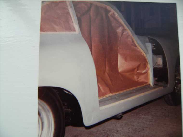

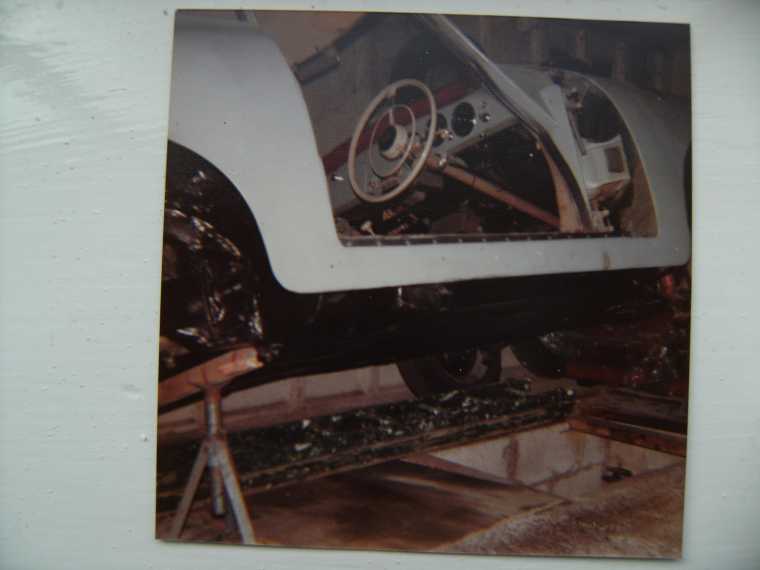

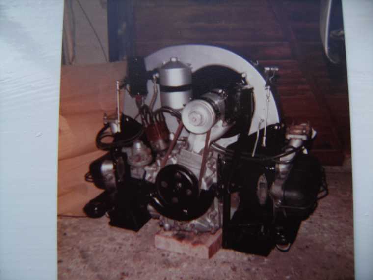

    Somewhere else on here I mentioned my method in the 70's of welding the underneath. I had dug a pit in the garage only half is shown in the photo and it was very useful if not dangerous if you forgot to cover it! When I tipped the car I went as far I dared and it did make it easier but nowhere near as good as a spit. Luckily I still have original floors, batterybox, and the majority of the longitudinal's I did have to fabricate pieces in the wheel wells and some patch work elsewhere though.
    I have more photo's of the work I carried out underneath which in fact Iused to help me get me the original look when I made pieces.
    Don't my attempts look like an amateur compared to what you are all doing today

    Great old progress photos Roy! Thank you for sharing them. Yes, A MIG welder can spoil you really quick. I could not imagine life without one!
    Were you doing longitudinals here or chassis detail? I notice a service walk in the floor there; Is that what I'm seeing? What year did you do this respray? Motor looks beautiful! Did you go through it? if so, Big bore kit, cam? Anything special? Thanks again lets see all your photos! Great post! Justin

        The inspection pit I put in when I built my first garage in 1968. At that time I was already looking at a 356 to buy. When I saw these the majority were on the road mobile rust heaps. I am amazed so many survived another 45 years
        So, when I saw how low these cars were and difficult to crawl under, I decided to build that 'pit' in the garage in readiness.
        That shot of the car at the angle was taken around 1977 I think I had welded the drivers side and passenger side before that and was completing the painting underneath and the final black underseal.
        Its survived well since then and never failed an annual MOT. But, the standard is not so good as yours Justin. I have other photos and will post although a little embarrased by some!

                By the way, my engine a super 75 is full matching numbers, but when the previous owner bought the car in 65 the motor failed at 110,000
                miles. AFN the Porsche agent then fully ( and I mean fully ) rebuilt the engine using new crankshaft, barrels,pistons, valves and guides, mods to the engine regarding lubrication, pushrods, recondioned both
                32 NDIX Zeniths etc, etc. The crankcases are all original.
                So, when I bought the car it was 25,000 old engine wise. I have never split the cases, touch wood the engine is still amazing. Sure I had problems with clutches, carbs, electrical items etc but the engine great. So, still 75hp standard. Oil changed always at 1500 miles and filter at 3K
