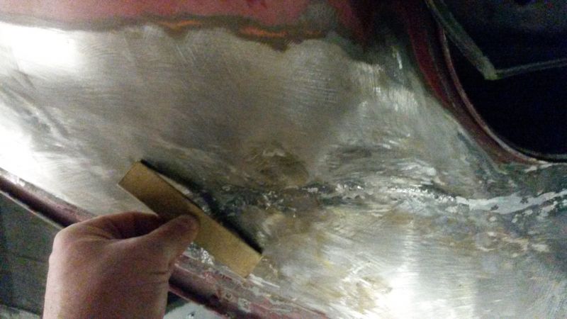

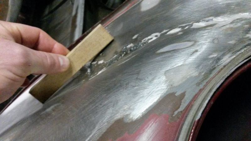

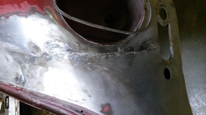

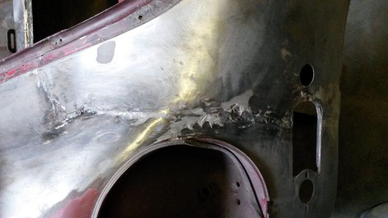

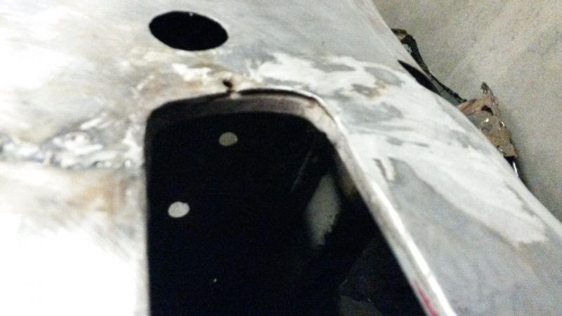

                Here are some pictures
                Between the headlights they did a terrible job:

                  Bart, it looks like you're dealing with almost an identical issue. How are the sides of the nose around the fenders? Nice? If so I wouldn't touch those factory joints to install a full new nose. Completely unnecessary. Yours seems to have a fresh repair section but just hastily installed. If that mid-section is as nice as it appears I would save all of it and just re-cut the joint prep and install it again but carefully this time. Just going on what I see so far.

                    The welding on this piece is just terrible....after the welding they just put a lot of bondo onto it (some area's till 1 cm)....they did't even grind it nice flat
                    Was thinking to remove all of it and replace the complete nose.
                    It's going to be a big cost, but then the result will be much better then this rag doll
                    Grts
                    Bart

                      So.. you havn't yet purchased the new nose?? I think the points raised by Justin are correct. Really establish exactly the smallest amount of panel removal first of all. Paint off an underbody sealant off to really find the good metal.
                      The front lid fitment was it close when you removed the lid? That 'trough ' where the seal fits as as a 'datum' is so useful if you can keep it. It looks okay in photo. I would maybe source single items you can work on, even that is not easy, but the whole area will be more stable. Cut off the front and it will flap around and the datums will lost so easily.

                        i'm with Justin, looks like some hammer and dolly body work, maybe a cut and weld here and there and it would be nice. looks like good solid metal.

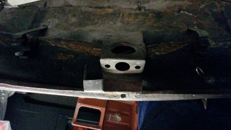

                          What happened in the past (to my opinion):
                          The car got a accident in the middle of the nose.
                          They cut the outside middle section between the headlights and replaced it with an other donor one.
                          Problem is that the inner structure of the battery box was also damaged....and not repaired
                          This also needs to be repaired so part of the nose has to come off to repair this battery section (by the way; while I'm there I'm going to replace the complete battery box).

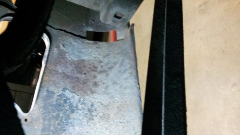

                          Near the headlights (towards the inner section the metal is really heavily dented....

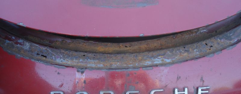

                          The lower nose gutter is also very rusted and needs replacement

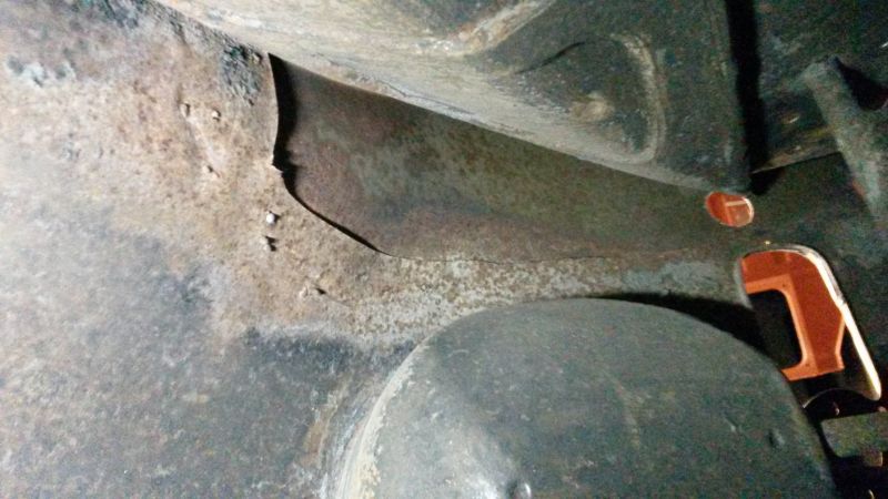

                          A view from the inside where clearly can been seen the donor middle part is just welded and hammered on top of the original section:

                          All these repairs did me wonder...if it would not be better to replace the complete nose
