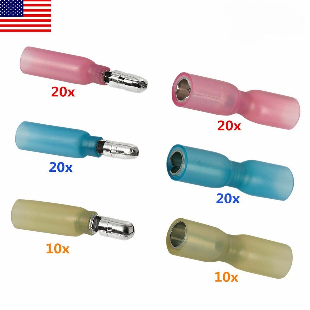

        I'm kind of playing in my mind of different stand in options that might work. What about retrofitting those tiny gauge bulb sockets to perform this job? They're compact and bass so they could be soldered to hold any contacts that you need on the inside. Then you've got the set screw terminals to the outside for your wire leads. I have a box full of strays if you think they might work. Take a look at the one's you've got on hand and see if they fit the bill.
      On second thought you could purchase a kit like these which would supply the female insulated housing you're thinking of.

        i like the looks of the bullet connectors. I'm going to get serious the next few days and do something, i've been putting this off long enough. im think i might have some of those style bullet connectors /
