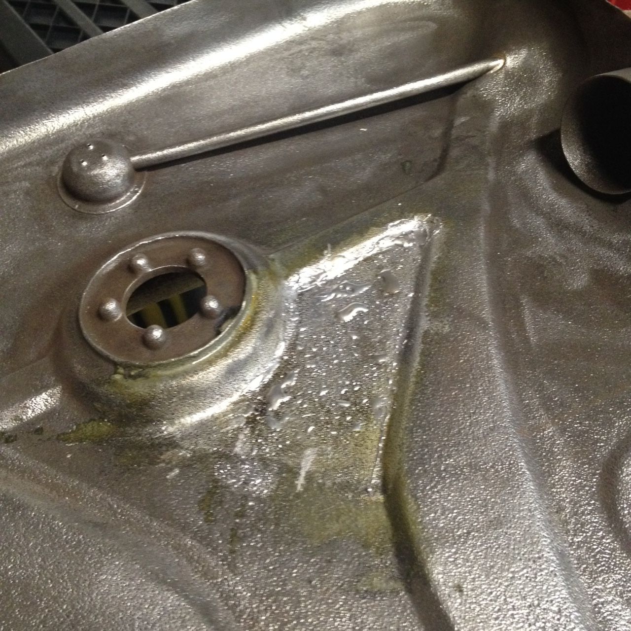

    Well guys it’s a BUST.. this tank can’t be saved, maybe with POR15 but not with lead (Pb). I was using 37/63 auto body lead over the Eastwood flux.
    The electrolysis was very good at removing the rust, can’t complain about that at all. But the tank is so pitted, I can’t get all the rust from the pits. This is causing the solder not to want to stick.

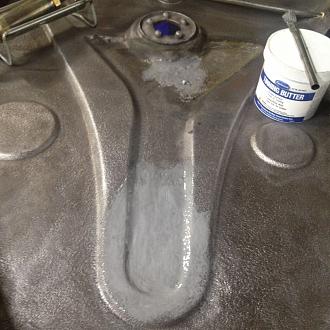

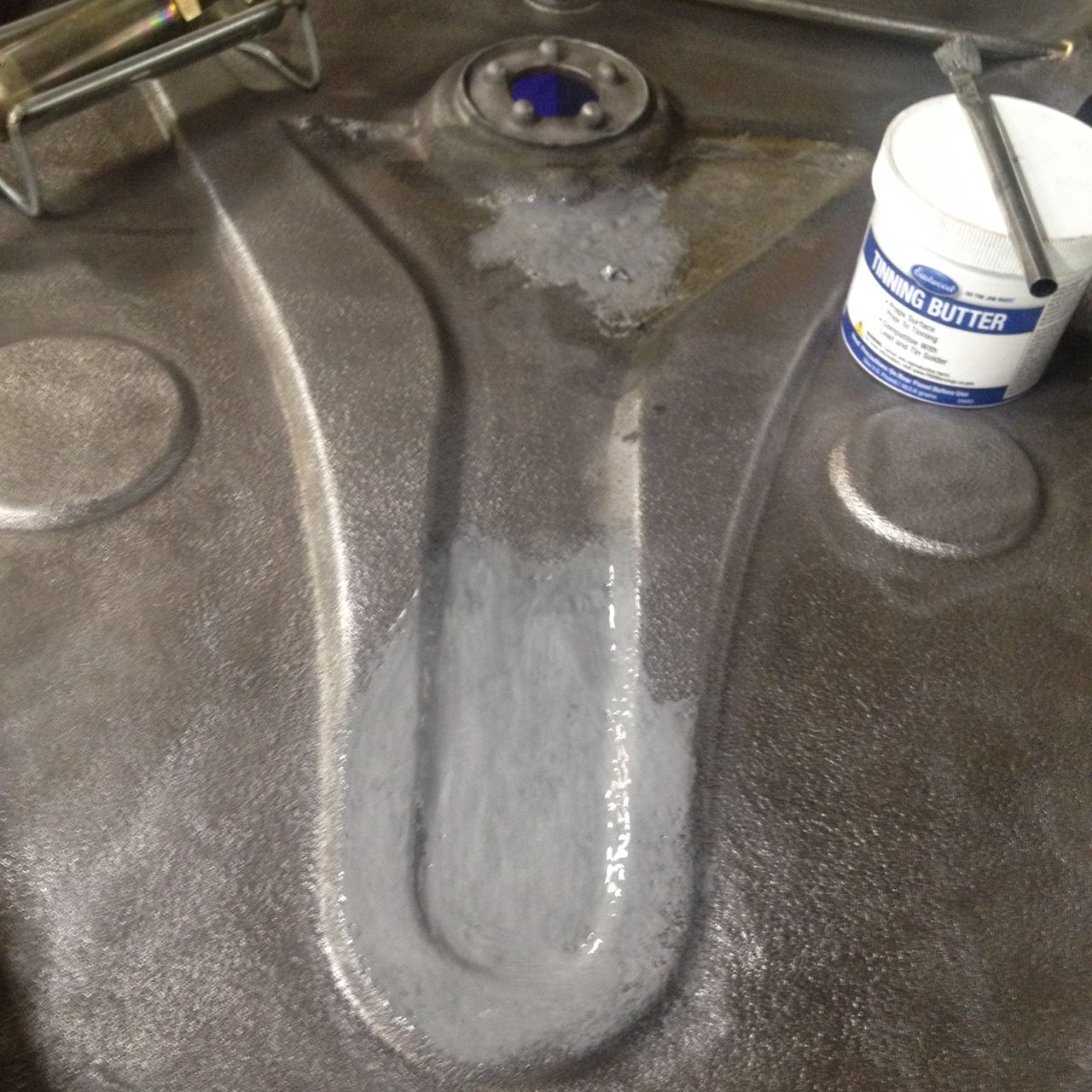

    tinning paste applied, then heated and tinned but the solder puddles and will not flow

    The tinning paste works fine on CLEAN metal. I am very impressed on how well this part of the process works, the Tinning Butter flows well on test coupons, and it is pretty easy to lead over. This tinning alone might be enough to prevent future rusting but its is not going into the little pits. I feel they will rust more in the future. But on the tank the a new lead layer will not stick unless you grind it down to bear metal. Then tin it and lead over the tinned section, it will stick and flow out about 1mm thick just fine, but grinding this tank will leave the tank so thin it will probably crack over time.

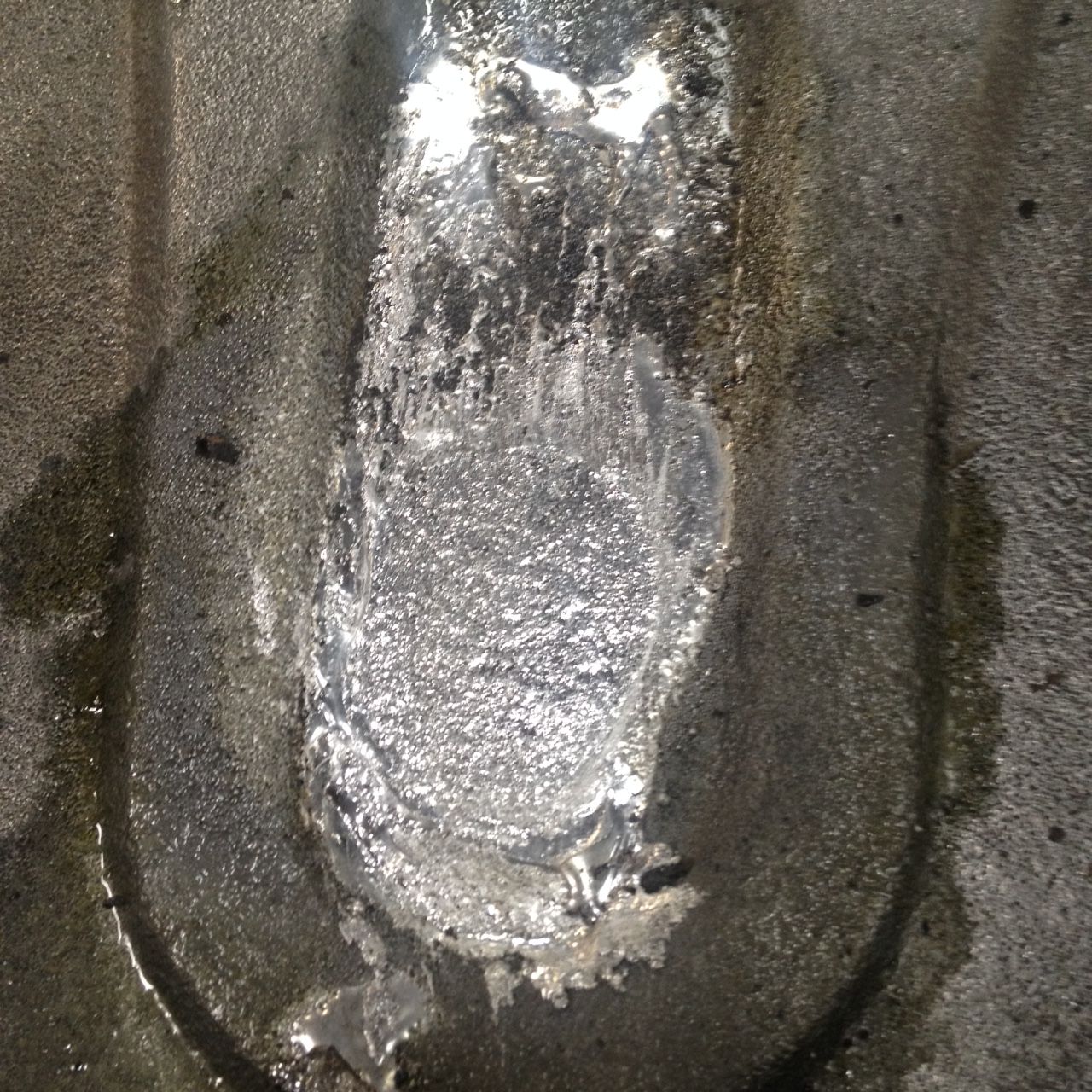

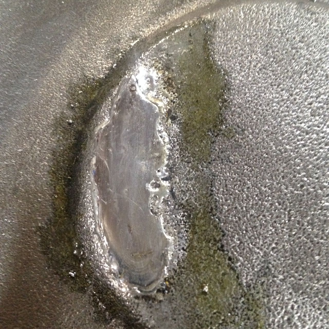

    Here is after grinding smooth then tinned and soldered ( ~1mm of lead)
    I tried wire brushing, sand blasting and an even an acid dip. The pits are too deep and I can not get the new lead to stick. The lead will puddle but not flow like it should. My be me and my techniques, but it’s a bust, was lots of fun and I can still do the door gaps and blended patches, but not with rust. The acid did react within the tiny pits, but just not clean enough to allow the flux to finish cleaning and get the solder to fill the depressions.

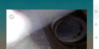

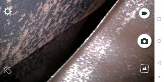

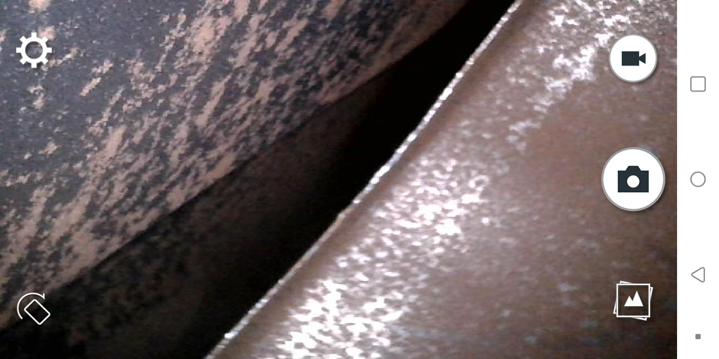

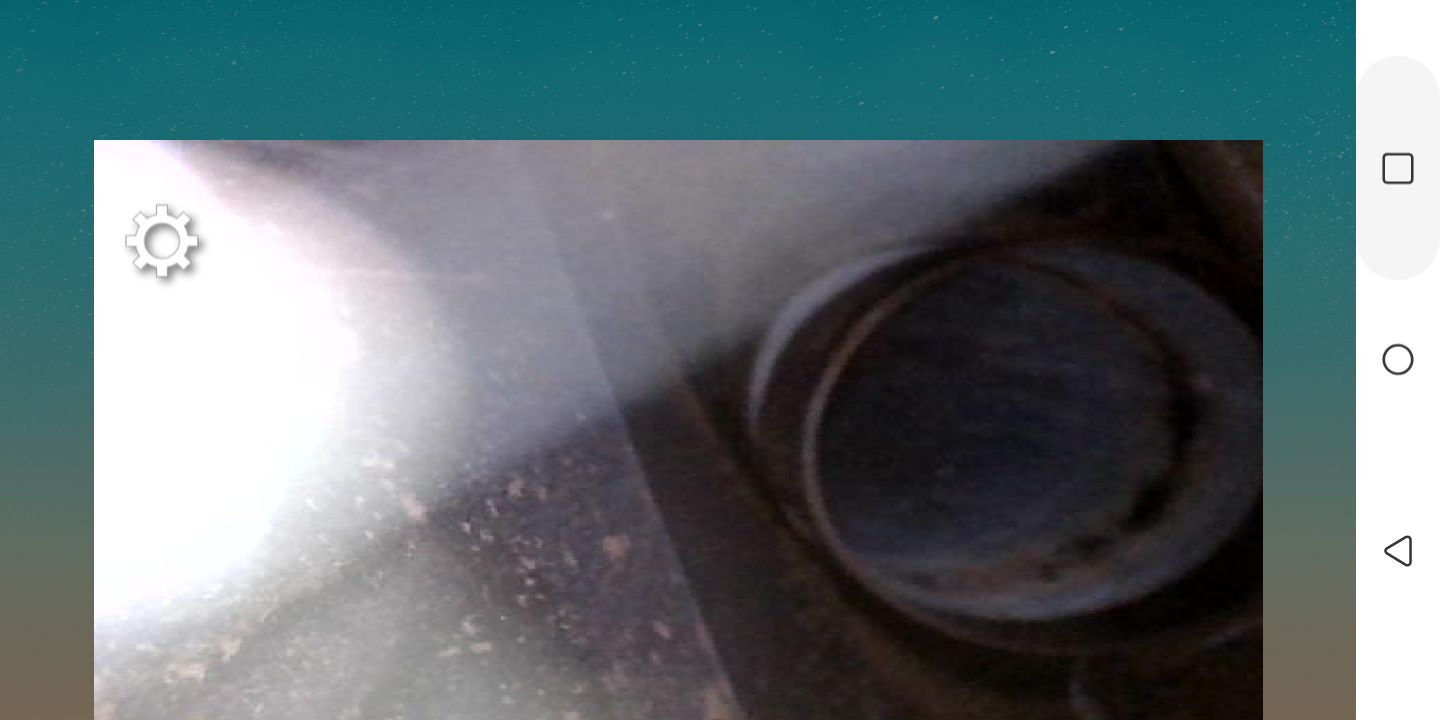

      I put a bore scope in my 63 tank. Hard to capture pictires but appears mostly just surface rust. I bought the Por 15 kit with cleaner, etcher and sealer. I usrd this on my 912 tank 5 years ago and its holding up well. 912 sender cover plate fits the T6 tank so ready to add cleaner
