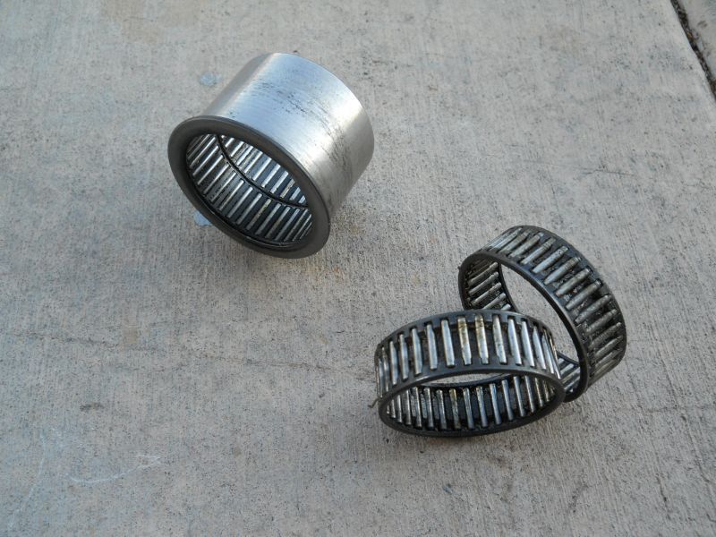

    This is one of those evolutionary changes Steve:
    Early T1's had the free needle bearing cages with a separate race pressed into the ends of the tube. Then sometime in late '57 they went to this one piece bearing and race unit.

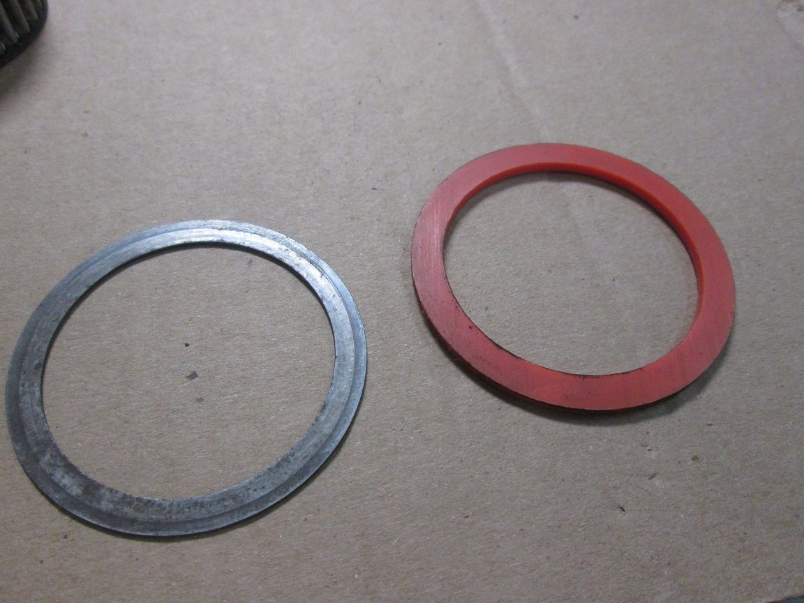

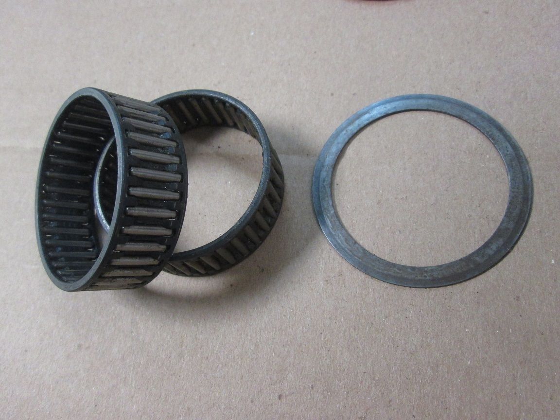

ID:	108832 If your car has the early bearings it had a metal shim on the inside of the rubber seal to insulate it.
ID:	108833 If your car had the one piece bearing unit there was this nylon instead of metal. You just have to determine which version your car had.
    Hope this helps.
