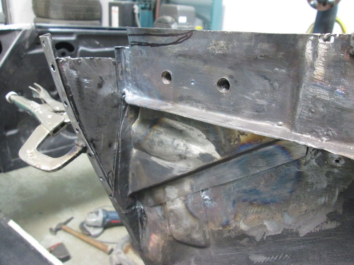

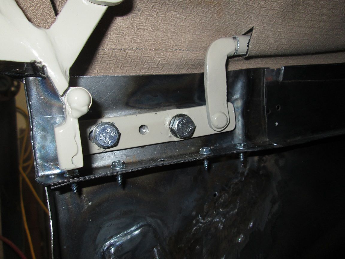

ID:	107715 All the roadster top frames will take a basic 14mm headed metric bolt. Much like the ones used to mount the hood to its hinges.
      Justin,
      Thank you for the photo.
      What are those bolts threaded into? My father (the previous owner since around 1970) said his memory is that there is a separate piece that slips back into there with two nuts welded on a flat plate. Does that make sense?
      Second question - what are the small sheet metal screws in your photo for? Is that standard or are you doing something custom there?

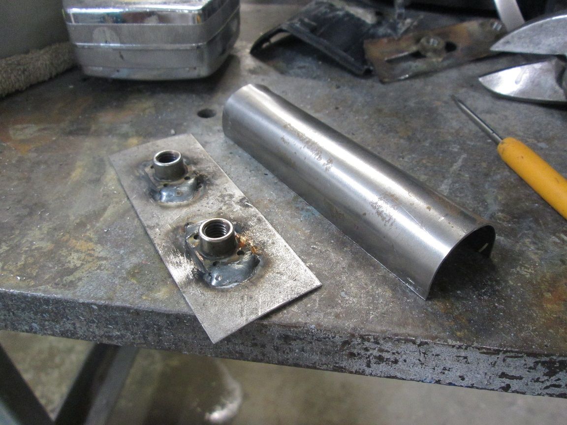

ID:	107731 He's half right its a thread plate.

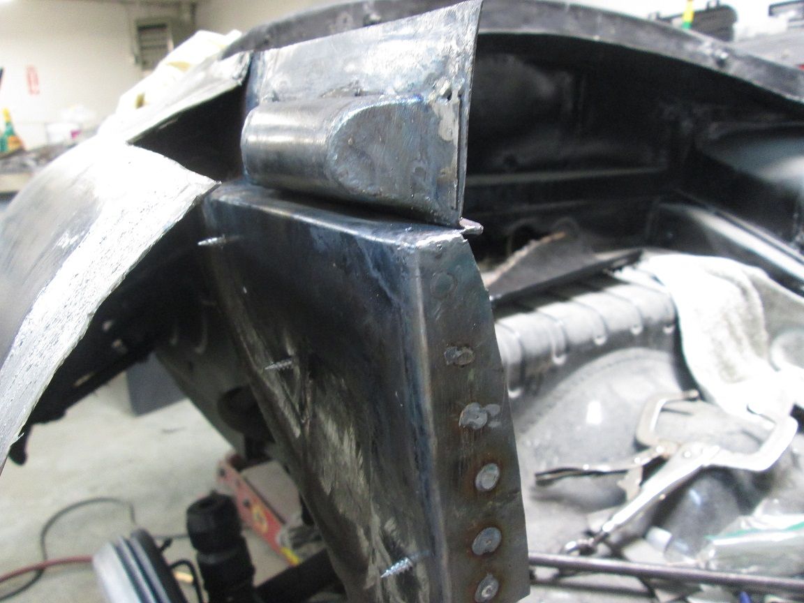

ID:	107732 And it is a seperate enclosure for starters
ID:	107733 But its eventually capped and welded to the back of the inner closing wall.
ID:	107734 Eventually ending up as one solid unit. This is a very tricky area to rebuild if yours is missing. The set screws in previous photos where to temporarily secure it while I dialed in the sweet spot for the top frame to windshield mount relationship before I committed to any welding. HTH Justin

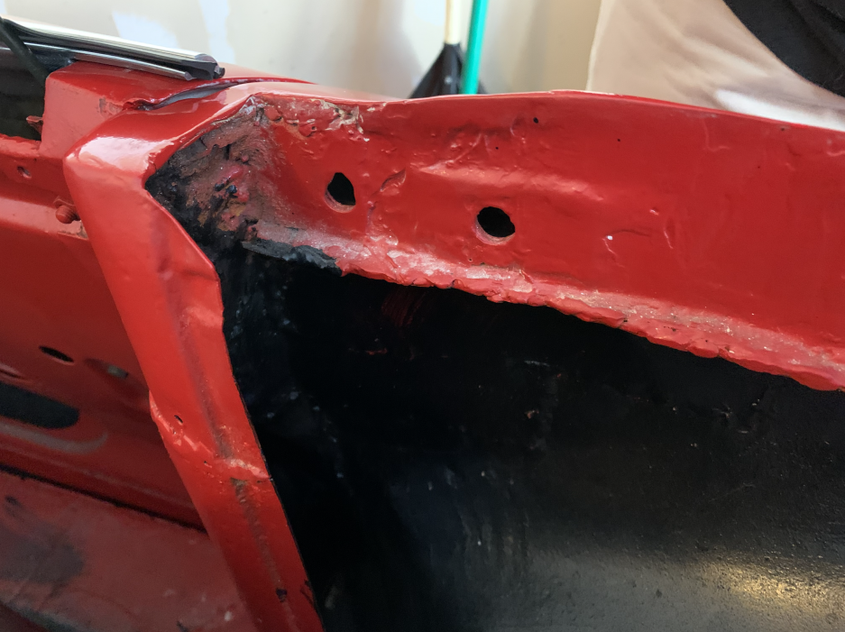

              This is what I'm working with at the moment. Those holes don't really seem to have any threads... perhaps two layers of metal sandwiched, but not really a thread.
              My father says he remember slipping a plate similar to the one linked above behind (and I think he made the plate himself heh heh) by approaching from the rear of the car and sort of putting in a pocket there. That was before the body work, so even if his memory is right, maybe the hole was welded up 25 years ago, who knows. It's been a very long time since this car was in one piece but I'm trying to do one little thing at a time and eventually it will be done.
              I will go home tonight and feel around/look under the cowl and see if there is a pocket or if it's all closed up. If it's closed up, I think I'll use a couple of rivnuts to solve it. I don't have the skills to tear it open, nor the desire to pay someone else to do that.

                Well, I just looked.
                No holes at all to put a plate in now. All smooth and closed up metal. I'm sure my father isn't crazy, but I'm guessing back in ~1980 or something, it was all rusty there and he fixed it by putting a plate in there through a rust hole or something. He remembers tacking a couple of nuts to a plate and putting in there, so I dunno. There is nothing in the holes now. I probed with a small screwdriver, and could not locate any loose nuts or plates or anything.
                I will figure something out. Advice is always appreciated. Particularly if anyone sees any more flaws that need correction here in this area. This part of the car is basically never photographed by other people for web publication, so most of my research using auction photos, forum pics, etc never shows what this area is really supposed to look like. That's why I love it when folks like you guys take the time to put up pics of these hidden areas and explain what's up.
