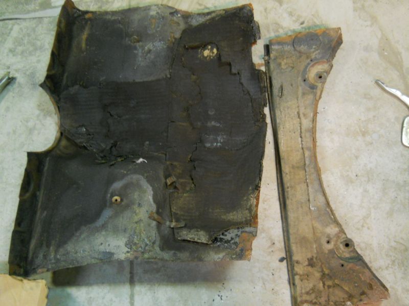

    I am attempting to install new tar paper on the underside of our 356A. Does anyone have any photos of the factory tar paper on the underside of the car in the area above the transmission? Having been removed by others, I am having trouble orienting the paper and determining if it is supposed to overlap and if so which piece overlaps the other. Any help? Photos?
    This is what was on my 63 T6B
      Need photos of paper installed in the car on the tunnel bottomside

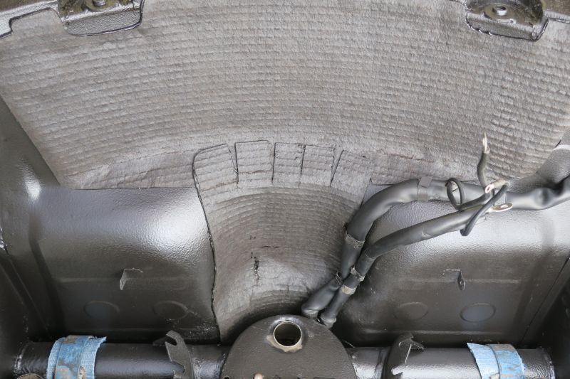

        Here is the finished product

          Here is a donor pan from a 58 coupe which still had its OG mat in place. Tunnel section on first then overlapped with the lateral piece. Where did you source your new mat from? It looks pretty authentic.
