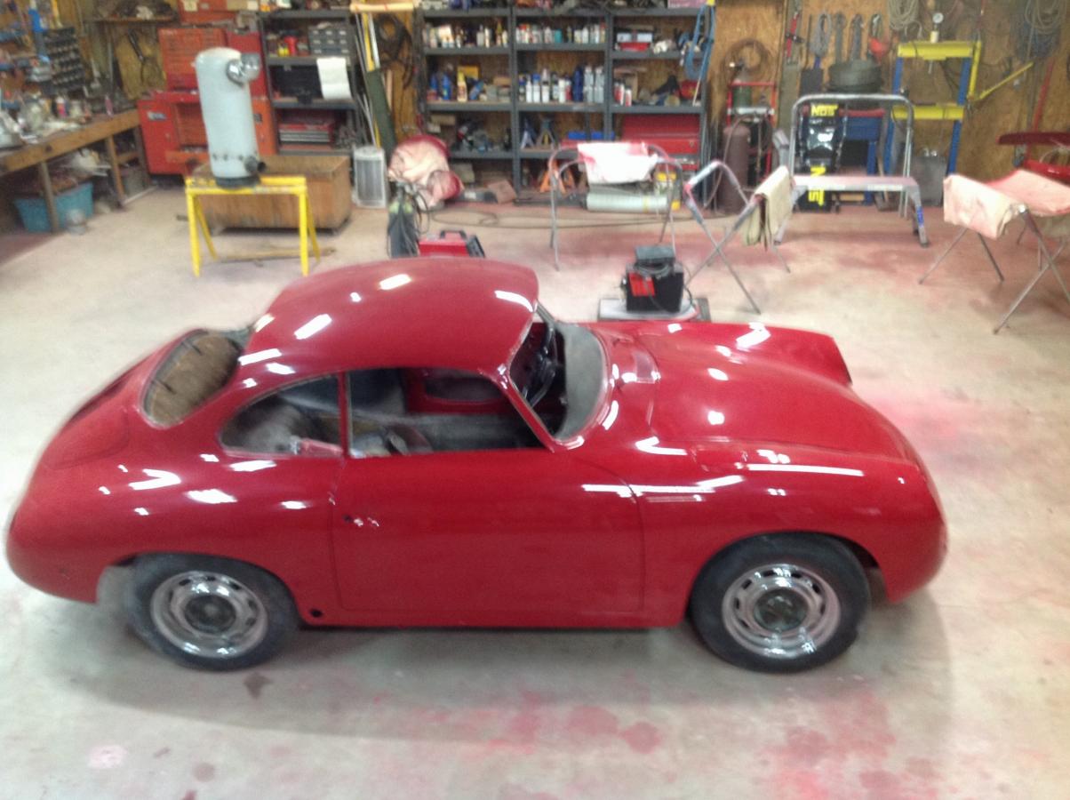

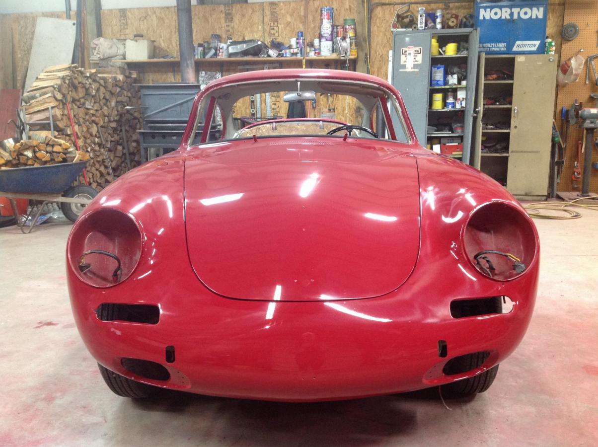

                          Then it got the PPG Rubinot

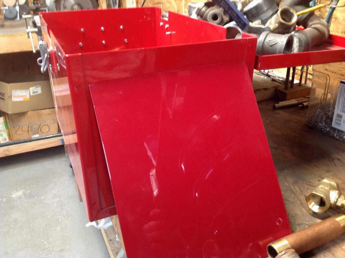

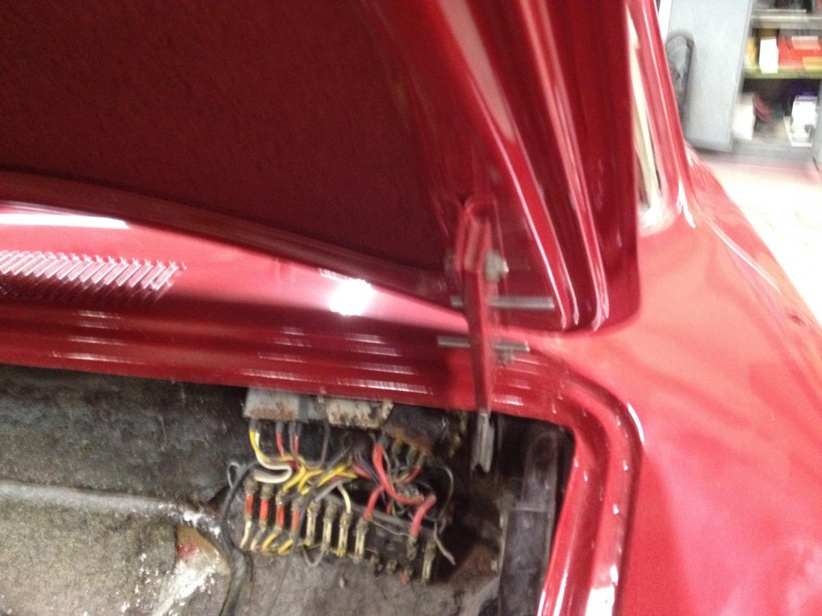

                            Another undetectable hood kink expertly removed by Bob Brooks, now three in a row. Note the 6mm pin in the hing alignment holes, gaps are perfect. No filler or all-metal, just weld and hammer work on the kink repair. Color came out fine, color looks Ok When I compared it to some RAL 3003 powder coated tool boxes I had made, it is close. Polished and waiting to return to the beach barn. Terry will finish the reassembly over the next few months (I hope ) I have started the jewelry, but the plating process is a challenge and will make another thread.

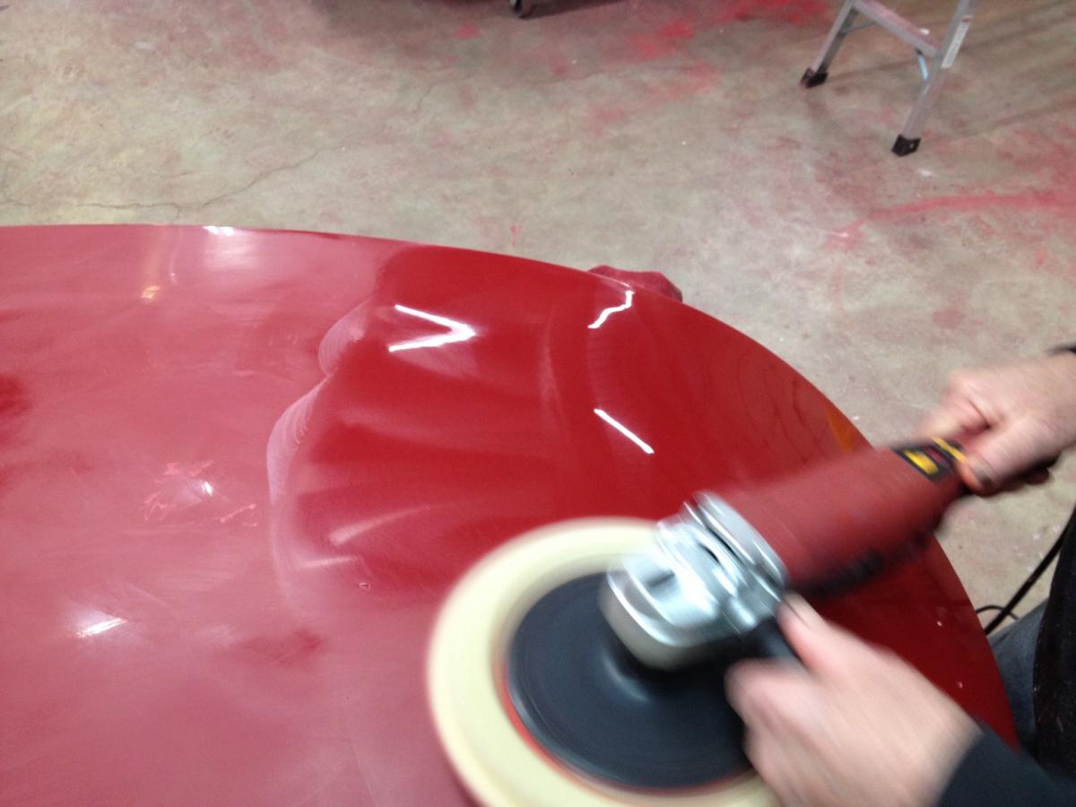

                              Hood kink repair in detail I lost the photos of the before primer, but here is the best ones left.
