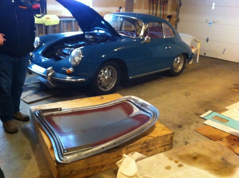

    A call to Trevor Marshall and a week later Tom got a box, good packing and a new T-6 hood for a B arrived.

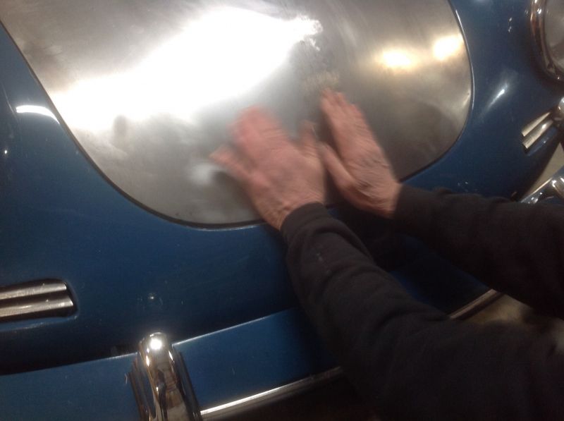

    The hood is beautiful piece of forming. It did require some adjusting to get the crowns right to fit the car. Not really all that hard some deep knee, and levers to flatten it some and re arch the rear crown it fits. Initial install fit with no hinges, high on one back corner, a little short and gapped in the center both sides. After fitting it the, Aft hinge mount holes were too high (hood sat too low) and rubbed on the cowel

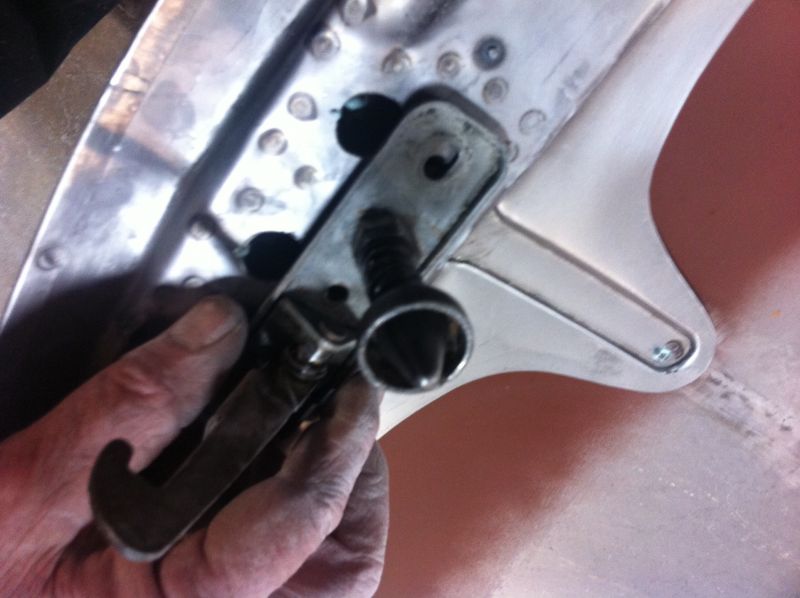

    But the hood was 95% true and I can't expect a new had made panel to drop right in. The hoods latch bolts did not match the "C" fitting. That Gave me a brain cramp for 10 minutes. Then I called Trevor, on a Saturday afternoon, he answered, confirmed my suspicions about the 3 bolt C latch verses the B two bolt.

    Hood latch from a C on a B hood

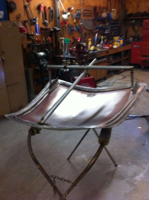

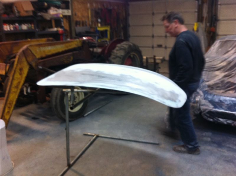

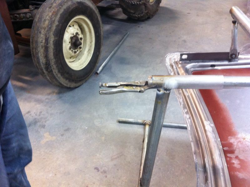

      Fit and adjust the gaps came in just fine after some tweaking. Bob made a fixture to hold the hood, prime and paint

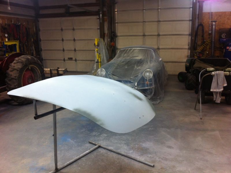

        Light fill and sand prime and paint, install this Saturday

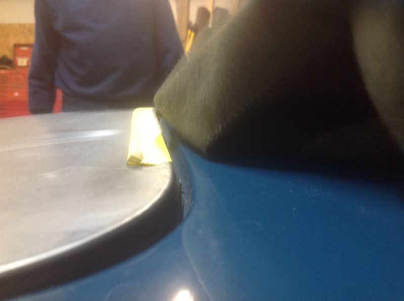

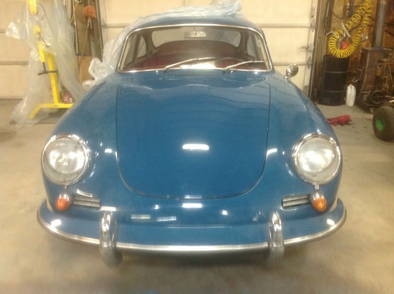

            Before we painted it, we had 4-5mm gaps, sides were great the cowel may have a 1mm deviation but the corners were good a little wide in the rear center. I made up a gap gage out of a plastic trim stick on the mill. Turns out they are 5mm thick, so a little of the ends works fine. Bob says the gaps will close up with the paint I was trying for 3mm, but all even and straight is good enough. New seal helps also.
              Hoods done fits ok. 3mm all the way around except year nose, it's still <4mm but OK. Paint is close to the fenders, polishing makes it look closer. New seal is fine but thicker than original, should work fine.

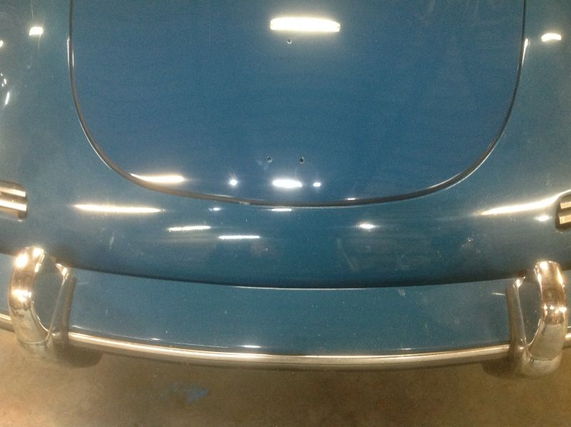

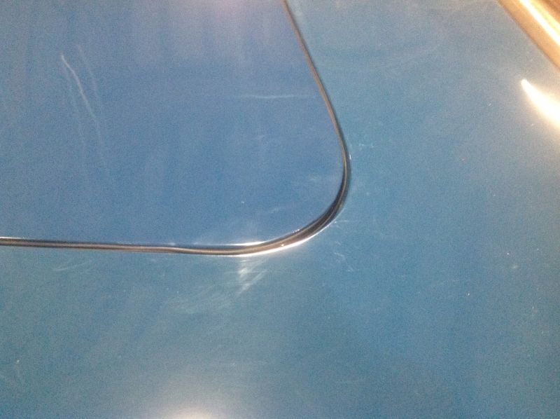

              Real cowl gap ok

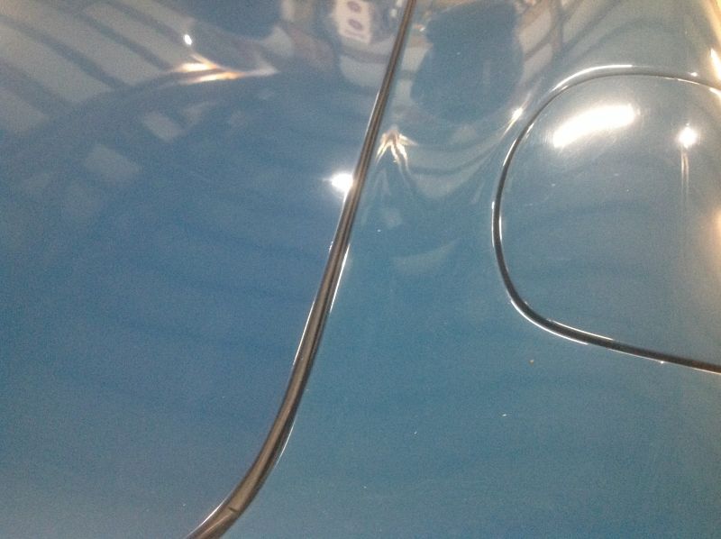

                Sides look fine and straight, good fit on the crown all along the rain gutter

                A mm short, but overall works well. Bob did some serious tweeting to get the arch correct all the way along the fenders. 40 Years of body work pays off.

                Color is close but not perfect, looks better after polishing. You an see the small section under the hood where we cleaned it. The old paint has 50-60K miles on it, put buffs right up.

                    That hood fits amazingly close. The gap does run wide toward the bottom but the overall consistancy is suprisngly good. The color discrepancy is no suprise. Even if it was shot with the same paint from the original can from the last respray it still wouldn't match perfectly. Repairs like this have to be blended across the gaps so your eyes won't pick it up. Once you pull it out into the sun I'm sure your buddy isn't going to like the checkerboard effect. So you probably won't be done painting. Other than that really nice job fitting this hood on!
