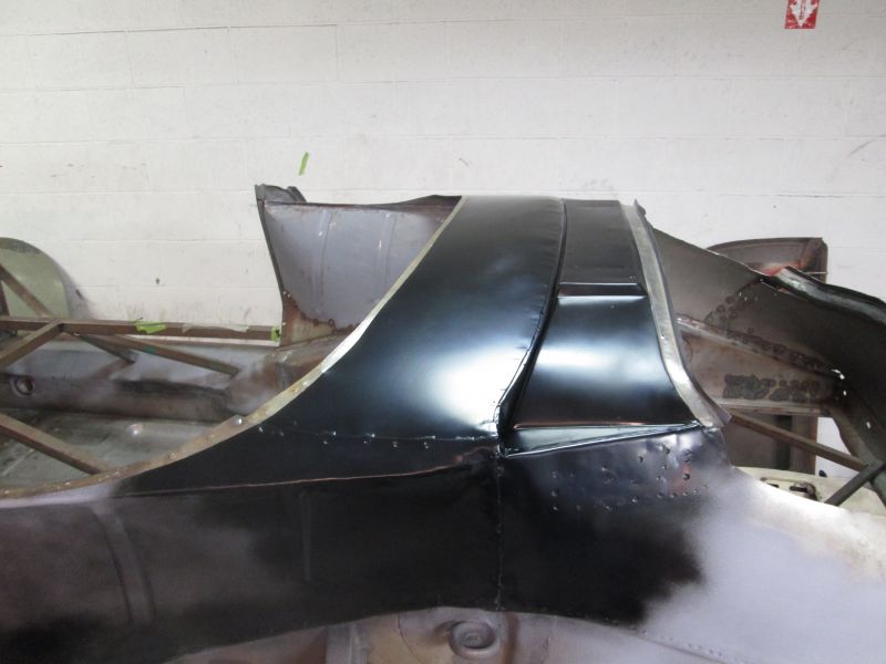

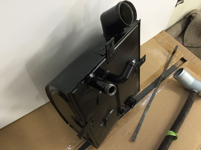

    Here is something I recently started doing. Instead of flattening my single stage gloss black I bought a quart of two stage black base as it dries with a nice soft sheen. It could be a touch flatter than 30% but not by much, anyway I just love the way it comes out as it really reminds me of that black electro-coating that those new replacement body panels come in. The only change I make for this specific application is I add catalyst to it since its of course not getting a top coat of clear. I'll be painting a few small parts this way shortly and will post the results. Hope this helped.
      "Anyone know of a manufacturer that makes a chassis black or single stage that is a proper sheen?"Click image for larger version
