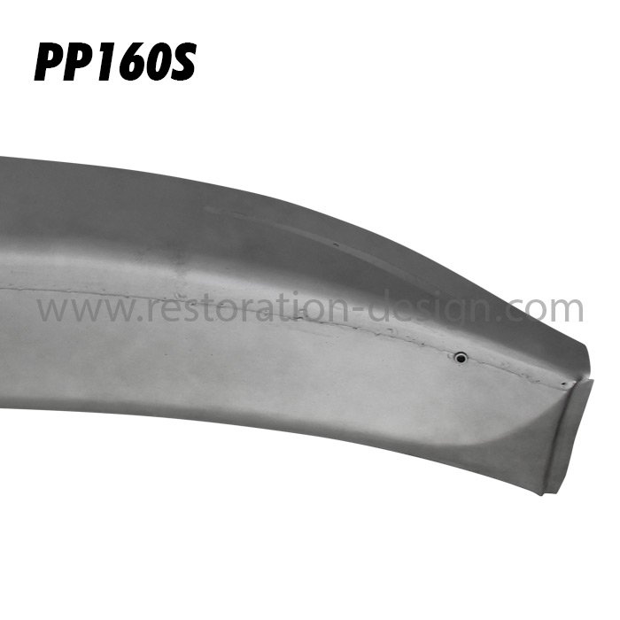

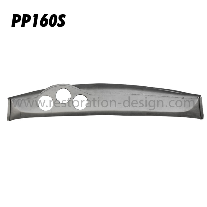

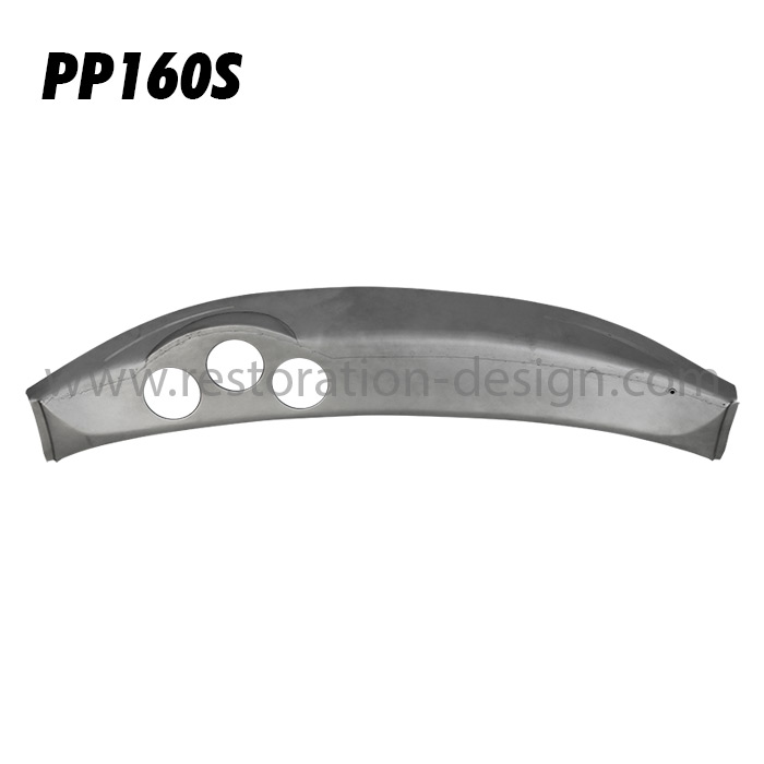

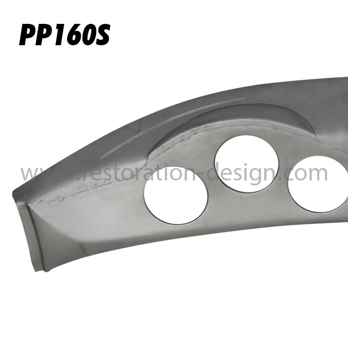

    Looks like it's a two piece Con D type dash with strange welded in dash eyebrow hump.
    Has anyone seen one of these in person or have better pictures?
    Would like to understand the quality before I spend 100's of hours producing a buck to make my own.
    Regards
    Drew
    Looks nice enough Drew but the images seem like CGI? The vents look drawn in though I do see spot weld details. Its a Speedster version example. A roadster dash would have a recess for the steering column like a coupe. Also the dash face on a roadster is attach over the top where a speedster is welded under the top as this one is. This would be a three piece unit but the cowl is not offered here.
    As for build quality you just won't know until you begin fitting it to a car but for 1,800.00 you can't go wrong.
