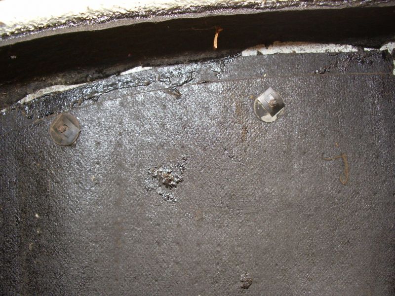

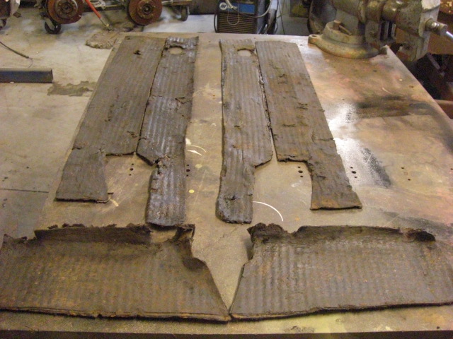

    Here are a few shots of original sound mat from a '58 coupe.
    I took these so I'd remember how it overlaid if I ever decided to reproduce it.
    Certainly nothing high tech. Just tar soaked paper board pressed together in various thickness. I'm thinking the highly sought-after Waffle/corrugated pattern was made during the process of bonding each layer. BTW the kick panels in this photo were better than double the thickness of the rest of sections. I've got a line on good heavy paper board so I was thinking about a 5-gallon bucket of tar with a mesh or roller type die to make my own. Not like I have enough to do already but I'd like to give it a go some day.

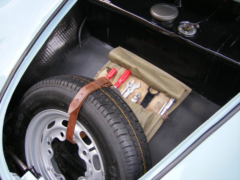

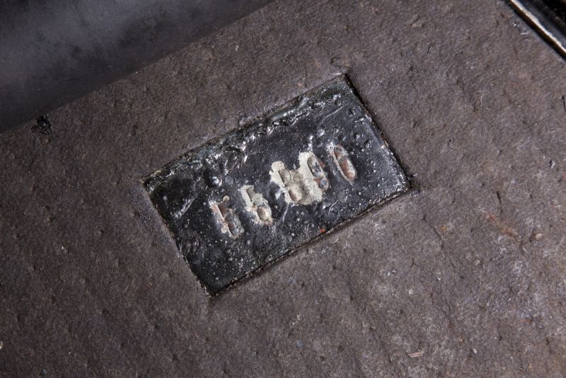

      I have attached some pictures of original cars with clean padding. I have found that the dimples changed and might also be different on the same car engine versus luggage compartment. The other thing I have found is that some of the material has a brown hue over it. I have especially seen this on earlier cars.

      I'd be curious to learn about the material you have found. I would like to find some material which is closer to original than the current available stuff.

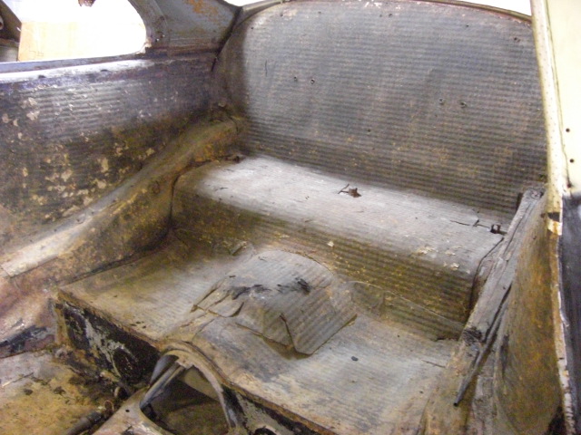

          Not thicker on the door sills
          But very thick here at the rear seat pan wall.
          As for the new paper board I'll have to round a piece up and see how it reacts and looks once soaked in tar. All the different pattern impressions you show just tells me it they went through different press dies or rollers but the basic material looks the same. I'll see if I can round up a loose original sample for you.

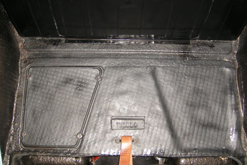

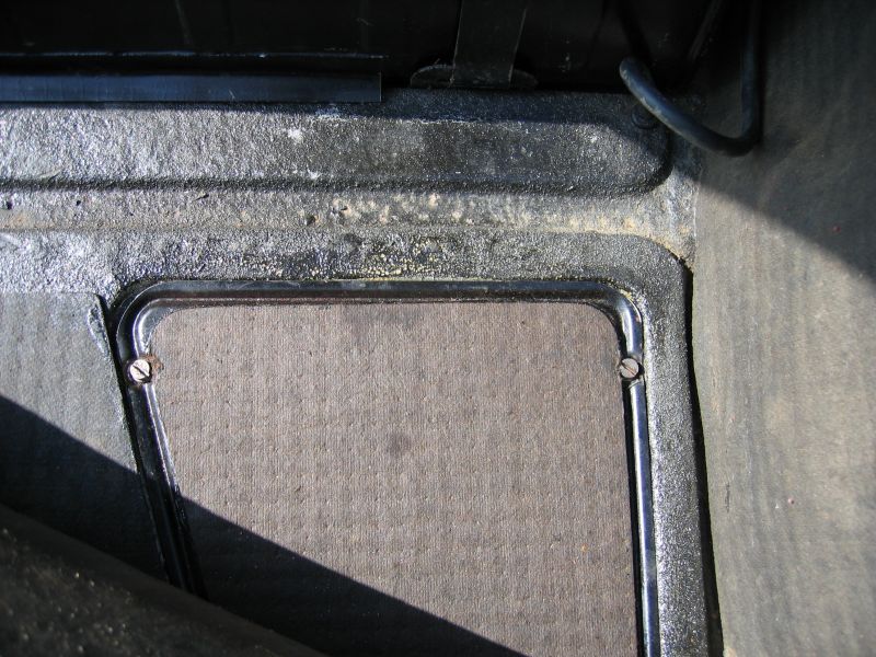

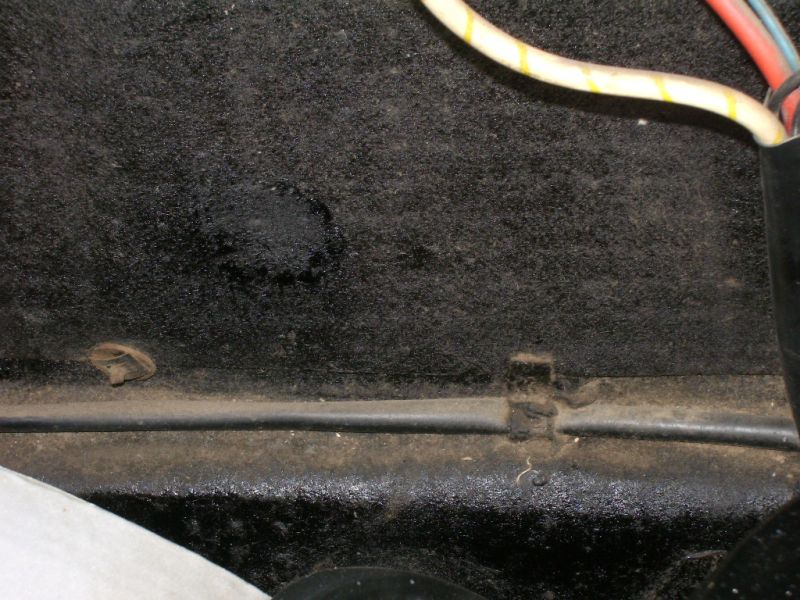

              Good comments from SJ I attach below a photo of my original factory sound deadening under the front hood.
              I have never replaced this although the cut out around my chassis number was not exactly a neat job by that fitter.
              I also painted the parts that show over 40 years ago so it was as DJ said easier to clean. I have often thought a coat of satin would look better than gloss.
              I don't have any samples though never removed any.
