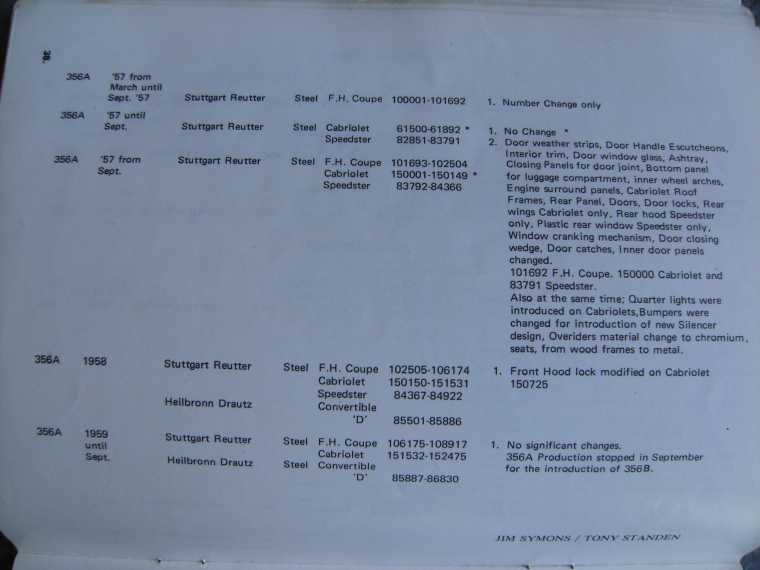

          My 356A chassis 106954 built around March /April does not have the bottom wedge.
          From info I have ( see the photo info below ) in 1957 -58 they modified the panel.
            We did have a new lock post mid 1957
            And then they moved the lock from top to mid door summer 1959
            But I thought it was also for the door wedge

              I was in a rush posted the wrong page this one should be correct!

                Roy,
                Which book is that you are looking into?
                It looks really good on all the small stuff
                Sorry GPC that I hijacked your tread.....

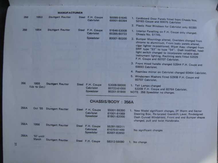

                  I used belong to the Porsche club in the UK in the 1960's. Until the 911 seemed to take preference to the 356!! Anyway, in 1971 an American Tony Standen and Jim Symonds who had factory connections, produced these 356 information sheets for PCGB. These were printed in the club magazines in 1971 and I still have them.
                  So, they are not available in a book. Useful though
