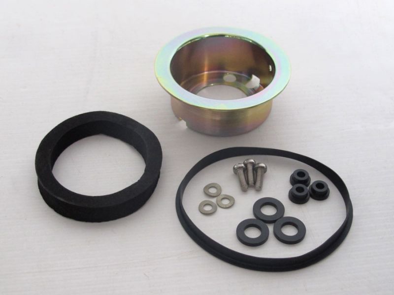

        Jeurgen: if you are asking about the foam/rubber insulating rings, Google "356 Porsche horn ring, Rutherford". You'll find a tutorial and pics of the process by Ed Rutherford of Klasse 356. It's on the Registry Talk List.

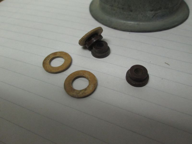

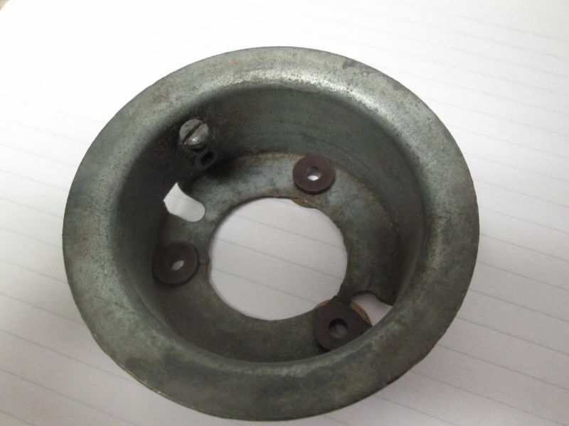

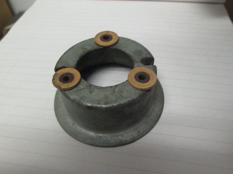

          Hi Juergen,
          Couldn't get a shot of the foam ring but its just a soft rubber type ring that slips over this cup and seats under that lip.
          Here are the insulators though:
          Insert type bushings isolate the cup from contact with the screws

          Base rings isolate the cup from the horn ring housing.

          Rings snuggly fit around the bushings.

                    I know WAY more about this than I'd like to I believe you were talking about the so-called "foam ring" that holds the horn ring off the "cup." Recently the foam ring has been "upgraded" by some suppliers, at least, by a tough rubber "O" ring. It was changed because the square cut foam ring quickly lost its elasticity causing the horn to honk at inconvenient times or at all times. I'd like to thank ED at Klasse356 who helped me with this and a more regarding my horn ring. Anyway, the "cup" height is VERY critical to the operation of the horn ring. I think..but am going to check this as I have an original "cup" coming to me soon..that the original retaining cup is SLIGHTLY shorter than the repro one. This is why with new parts you may need to bend the cup rim down some..but not too much ! to make contact when you press the ring. Also, it is highly probable that a square cut "O" ring (is that possible ) would be MUCH better as the "O" ring while durable is not the right shape to really tilt the horn ring when you press it, onto the cup and make contact. Now, I've had three 356 "A's" and this is the FIRST that I got the horn ring honking the horn and as an "added benefit" the button flashing the lights. BACK in the day my dad's '52 Ford ONLY had a horn ring and, yes, it honked the horn..as it should why it is a "horn ring!" Back then most ALL cars had horn rings and they honked the horn. The button flashing the lights? well that was a German invention ! Usually I take lots of pics but not here. Sorry. -Allen-
